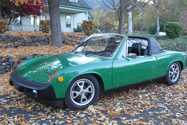

The problem with this car is: I've got the body in great shape, put a new interior kit in, and have thought about selling it to finance either an SC or a motor for my 365c, but I'm really starting to love this little car. Or as my wife calls it: The Hot Wheel.

Good luck! and BTW: Nice! (IMG:style_emoticons/default/wub.gif)

What a great looking 914, it would be a shame if you sold it. (IMG:style_emoticons/default/poke.gif)
