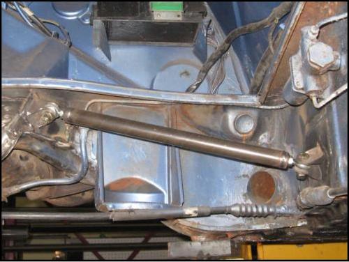

Cheers guys, yep I can see the sense in strengthening the suspension ear, and it's not a big job.
Does a connecting tube from the ear to the firewall make a big difference? I would want to make sure it didn't get in the way of the engine before I welded it in..

QUOTE(OllieG @ Jun 13 2013, 12:44 PM) *
Go onto the tangerine racing website. Chris offers a removable link set-up to brace the ear to the firewall, and a reinforcement kit for the ear!

That bar makes the biggest difference with big or sticky tires.
If your car has any rust its something you should consider and they are fail points.
I have an engman long kit and seam welded rear points. The engman kit gives the car the stiffness it needs and the seam welding is just for piece of mind.
I run 285's in the rear and do quite a lot of drifting, so there isnt typically much force put on the rear suspension ears, but I have seen to many crack and to much flex to know that it needs the reinforcement at some point.

I don't have any experience with the Firewall to Ear Bar, but I have seen one and it looked good
