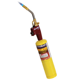

If you don't already have a mapp gas torch in your garage, you need one around anyway. Besides being a great bbq lighter, and being super helpful for getting tough fasteners apart, they make very quick work of annealing exhaust seals.
