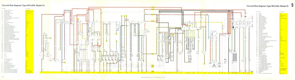

The wiper switch and motor are shown here between 4-9.
To read this: Grounds are at the bottom. There is a yellow numbering system below. If you are following a wire and it stops at a number inside a square, go to that number in yellow to find the other side of the wire. If multiple grounds have the same number in a circle, that means they are connected to the same point.
Download and save this...

I saw this on there web page but didn't think it would apply to me as mines a 73. Jeff B says they changed alot of wiring stuff from year to year. Do you think this would apply to a 73?
