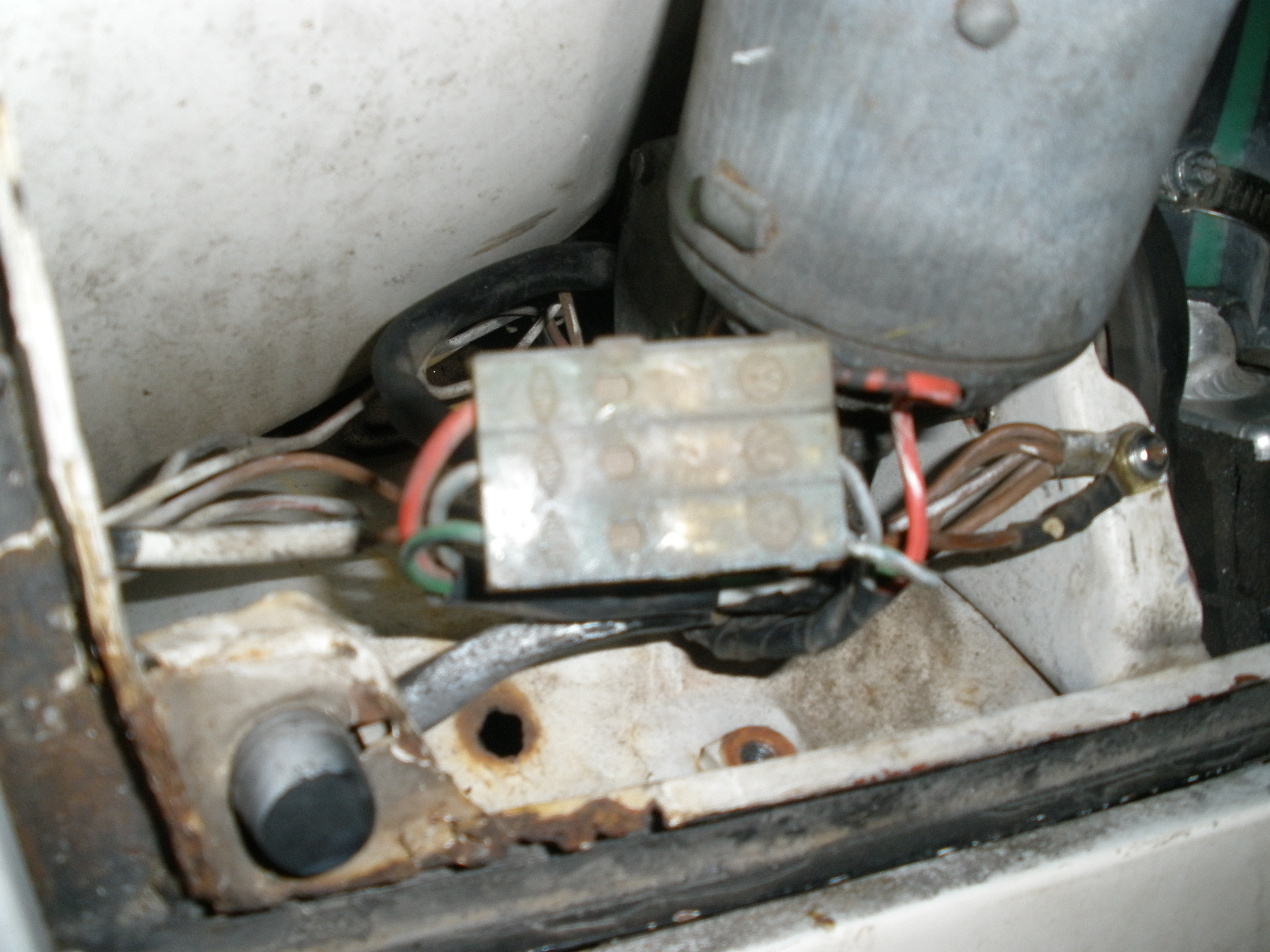

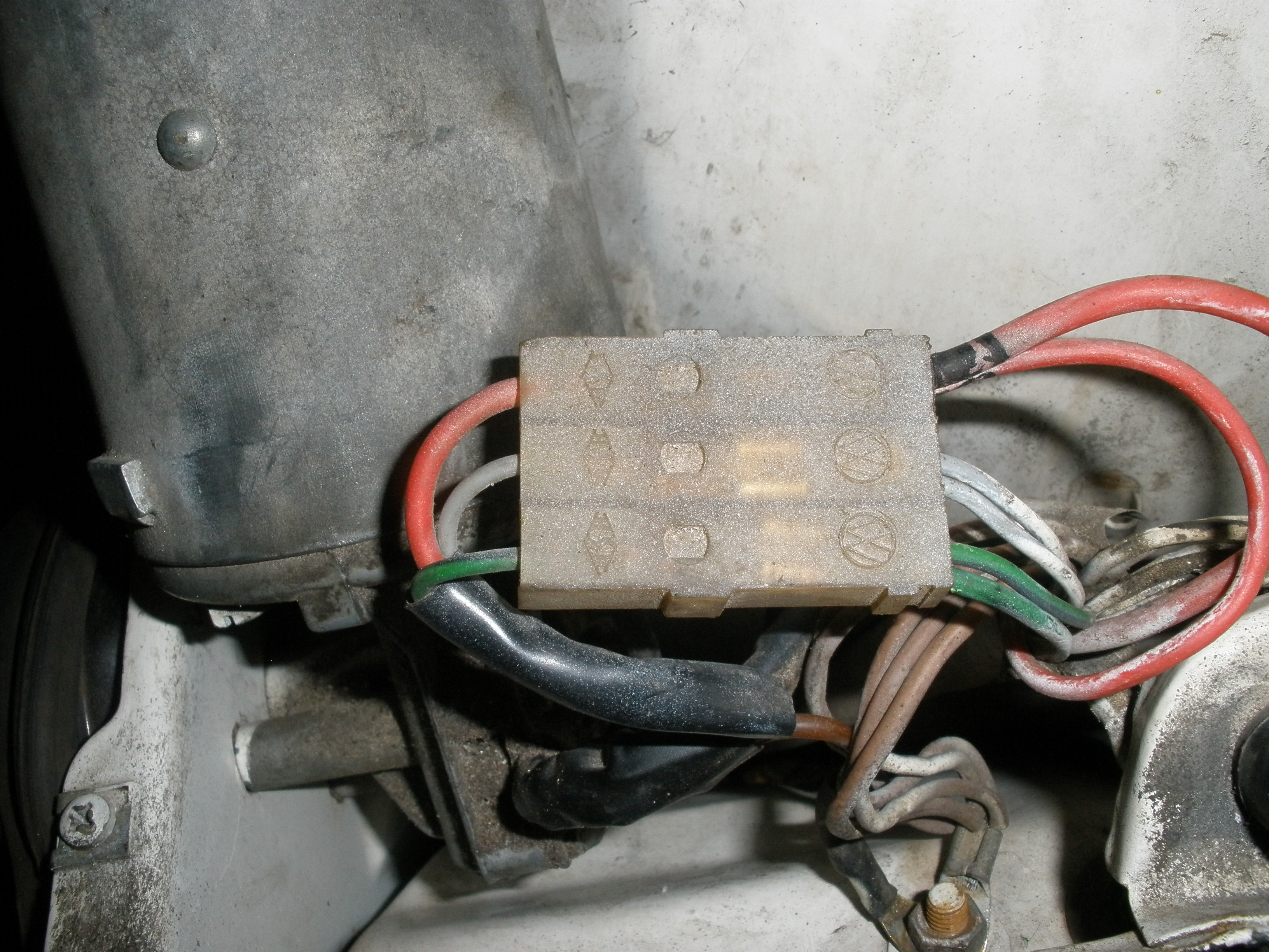

Howdy everyone.
Still working out the gremlins on my v-8 converted 1973.
The PO had the headlight system out and in order to make the car street legal here I have to make them work. The other day I installed everything except wiring up the hide away motors. After a few false starts I managed to get both the headlights working.
Today I wired up the motors and while they work....they work wrong, lol. When I pull the light switch out to make the headlights go on, the hide aways close. I'm color blind (no, really I am) but I'm pretty sure I wired em up correctly using my LE project as a visual aid.
Any ideas on what I did wrong?
Thanks all :-)
Evidently the passenger motor had a problem. I switched it out for another motor I had and it now works correctly.
I wonder if those motors are rebuildable? Hate to toss the bad one if I can make it work again. It won't open.
Glad I had a spare around.

The arms on the motors are 180 deg out. Or do they not work at all?
