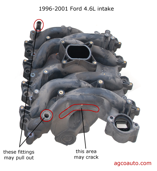

The manifold crank problem is discussed here: http://www.agcoauto.com/content/news/p2_articleid/185
And the area that is prone to crack on the original all-plastic manifolds is at the front: (IMG:http://www.914world.com/bbs2/uploads_offsite/www.agcoauto.com-13527-1378741667.1.jpg)
Eventually the heating and cooling of the antifreeze weakens the plastic in this area and a crack develops. Not so much a question of "if" but "when." The solution is a replacement intake manifold, all of which have an aluminum crossover (which was Ford's recall solution, though the recall date has long since passed).
If the truck already has the aluminum crossover tube, that means the intake has already been replaced. Mine was like that when I bought it, but I still ended up putting another intake on it this past year. The plastic had gotten brittle under the aluminum crossover and cracked. So, basically every ten years or so they need to be replaced. Again, not a big deal and a fairly easy fix if you can devote a days worth of work.

The 5.4s have a Aluminum Crossover Tube, but the Plastic WILL Crack somewhere!
