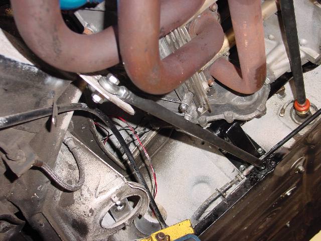

Here's a small pict of the rear suspension console brace we use. Made of cro-moly tube with adjustable ends. It has been used since the early 80's and kept the console from ripping despite offs, spins, etc with slicks.

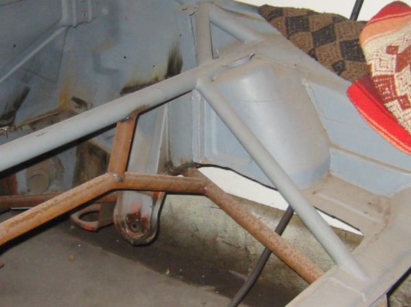

This is what I do Bill.
(IMG:http://www.tangerineracing.com/images/Suspension&Brakes/rearsusp_reinf.JPG)

Would that be good enough for the torque of a 3.6 motor? The engine is out right now...so I could get all this stuff done before stuffing in the new motor...

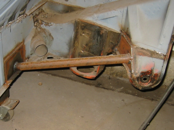

Chris, do you ever see the need to reinforce the transmission mounting sheetmetal?

QUOTE(nine14cats @ Jul 21 2004, 05:01 PM)
I think it will take at least 300hp with 12" wide tires.
I've never done it yet, unless the trunk floor was cut out. Based on the extent of damage to my car from hitting the Armco I'd say that area is pretty stiff and doesn't really need reinforcing. Maybe a small tube from the shock towers on each side, but no need to cross them like I've seen on other cars.
Actually it is probably better to do any reinforcements there, on the underside, from the rear of the longitudinal to the trans. bracket.
Without the trunk sheetmetal I would do something like this.

I like this one
But call me paranoia, I'd hate it if (30+ year old) threads in the nuts on the top of the outer susp. console would shred or if the bolts broke. You'd have to cut it all out to access it (IMG:style_emoticons/default/blink.gif)

QUOTE(Jeroen @ Jul 21 2004, 06:21 PM)
call me paranoia, I'd hate it if (30+ year old) threads in the nuts on the top of the outer susp. console would shred or if the bolts broke. You'd have to cut it all out to access it  :blink:
Piece of cake!
Actually, that already happened to a customer of mine who had this mod already done by me.
He broke a bolt, and there was no way to get it back out, after he broke 2 easy-outs inside there.
I was able to replace just the sleeve that the bolt threads into, without removing the reinforcement. I did have to cut an access window through the back. If it was the front one it would have been a bit harder.
