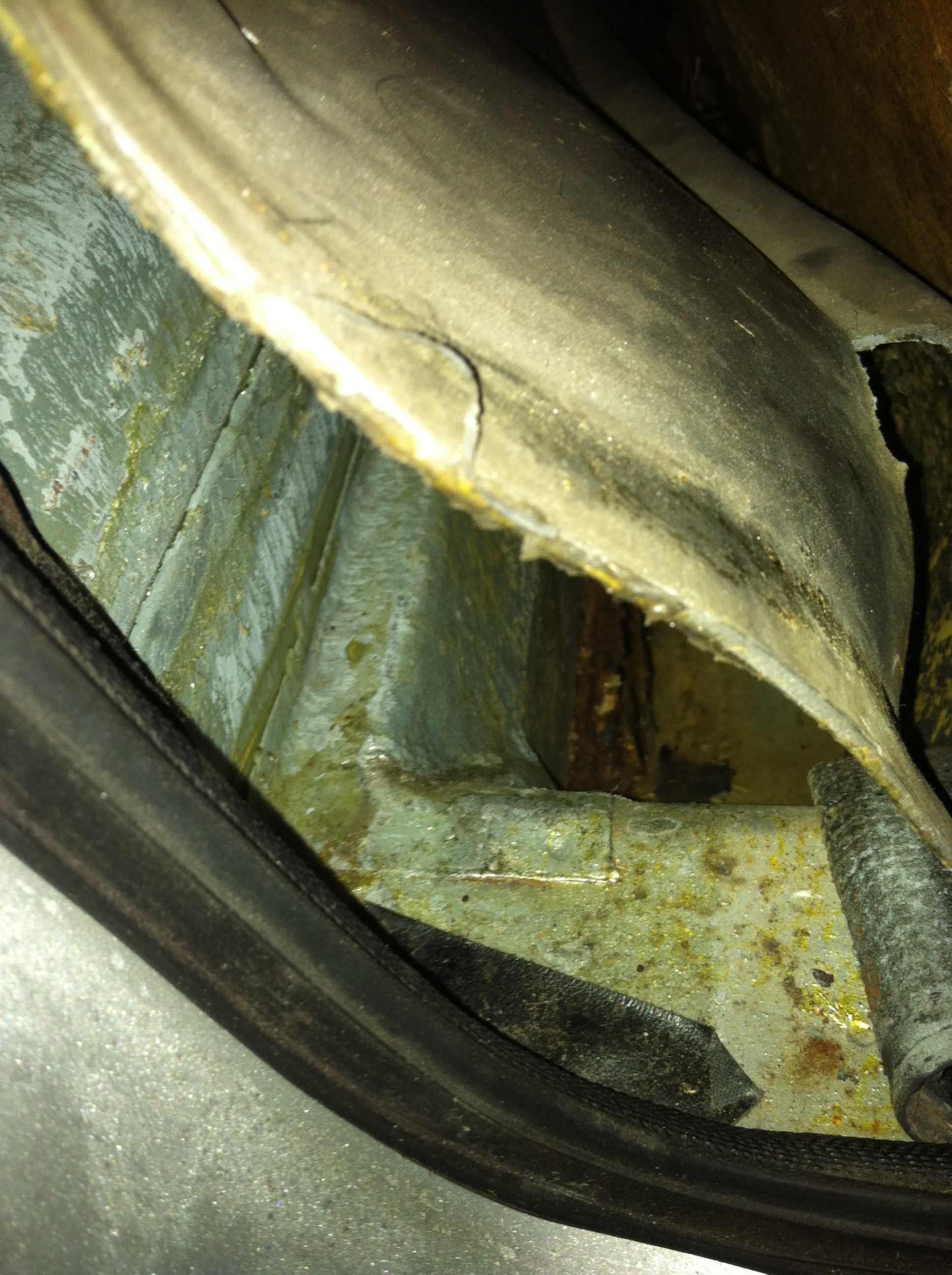

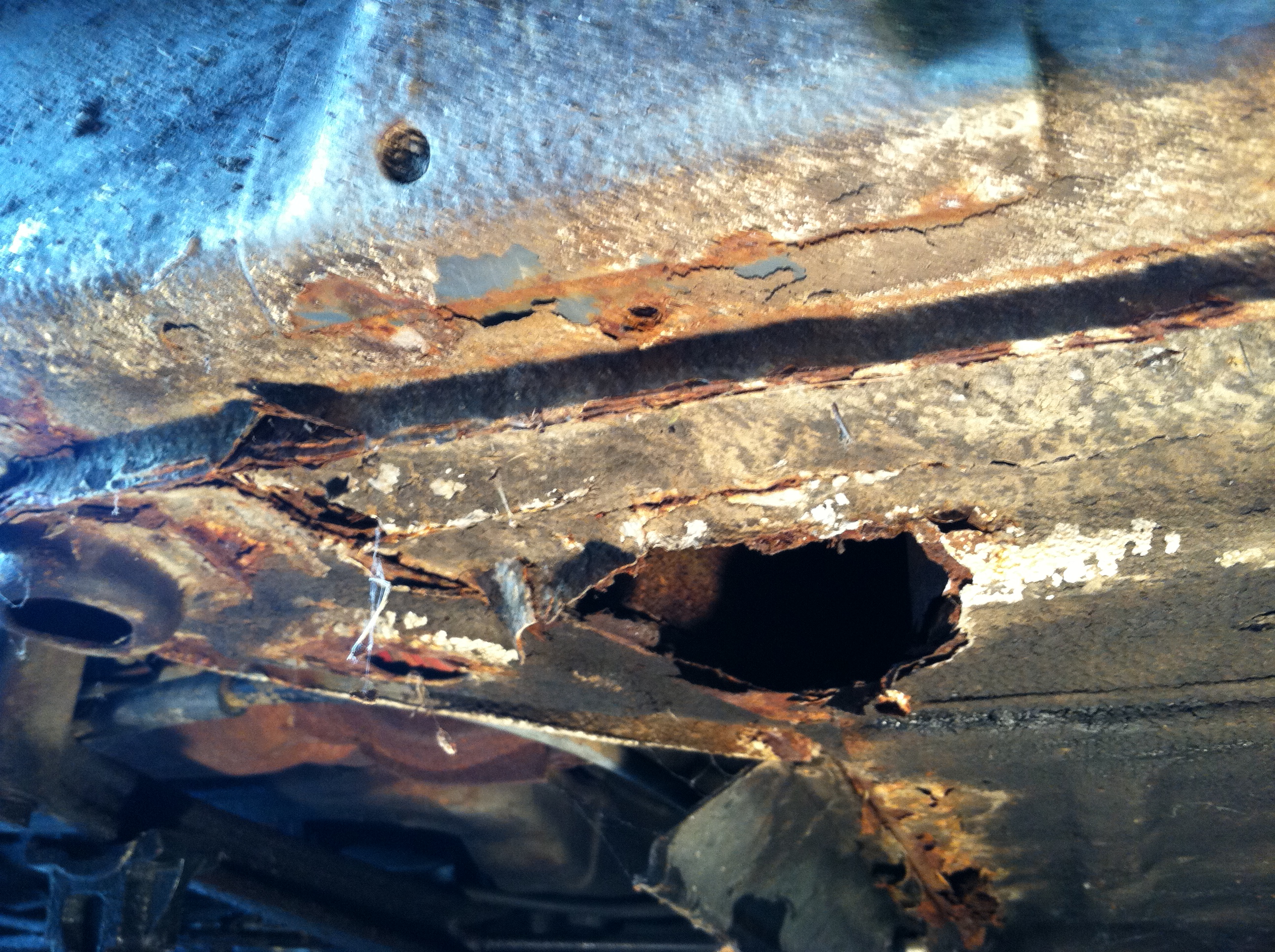

I'm in the Bloomfield Hills area. Here's a pic that shows what it looks like from underneath. From the top, under the batter tray, and all the way to the fire wall, there is no rust. I don't have pics of that.

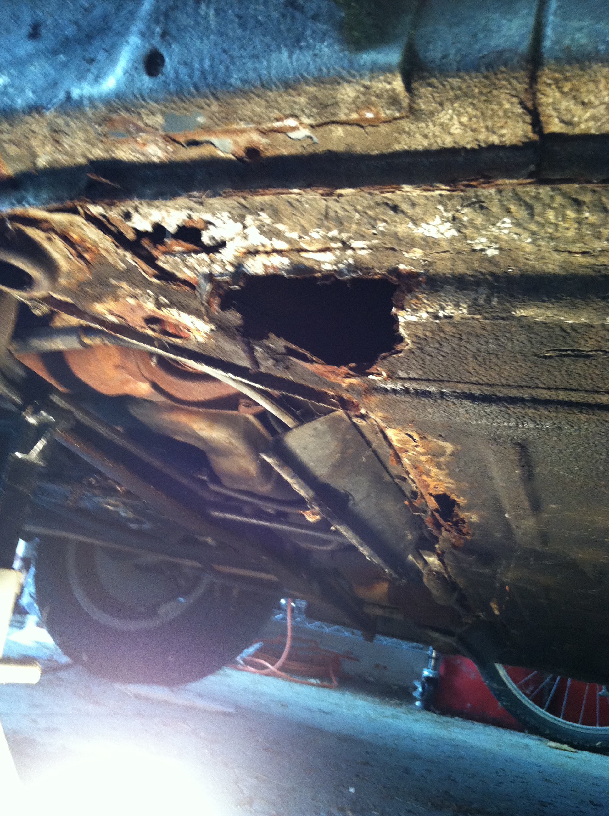

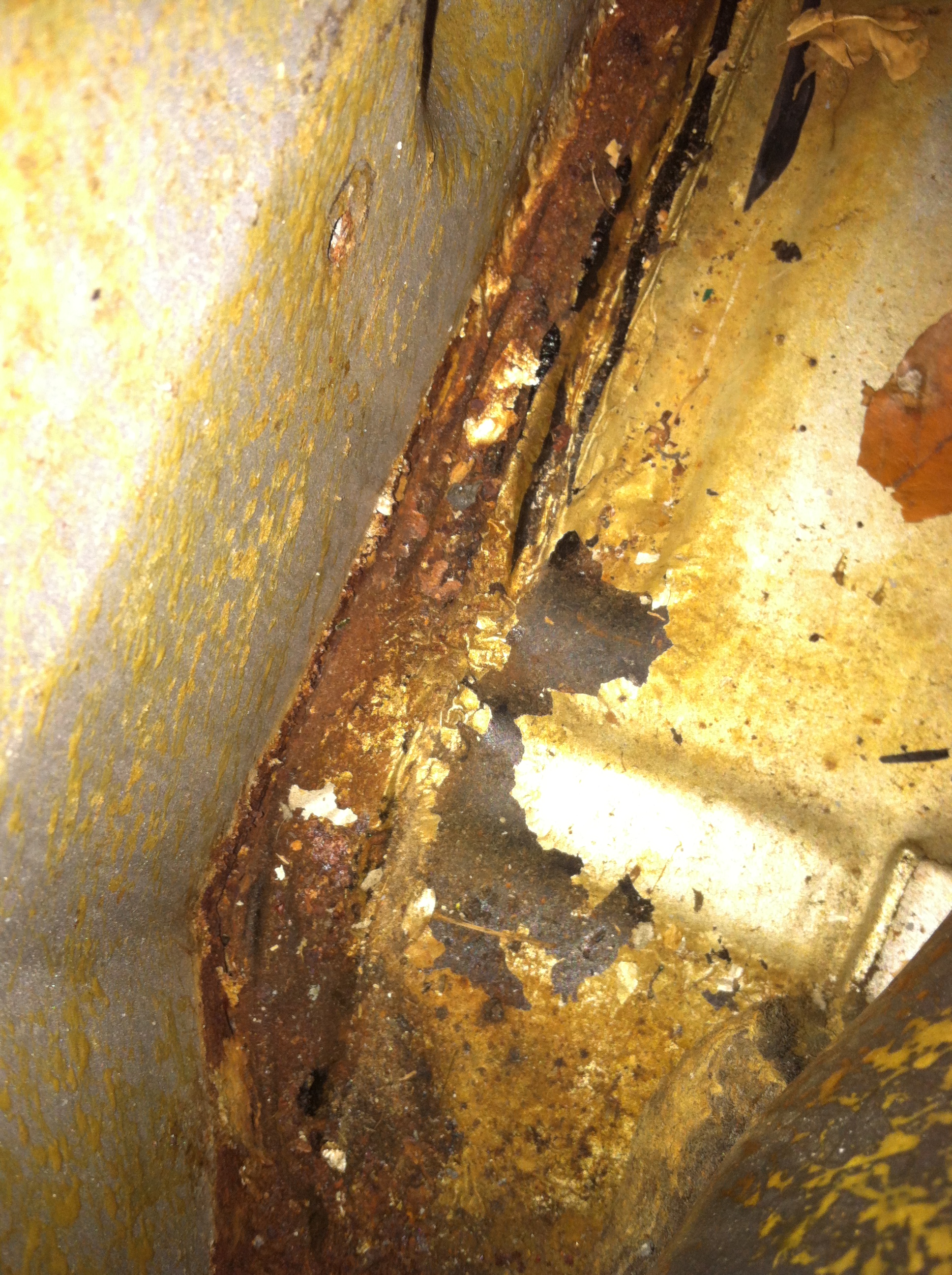

Here's another pic

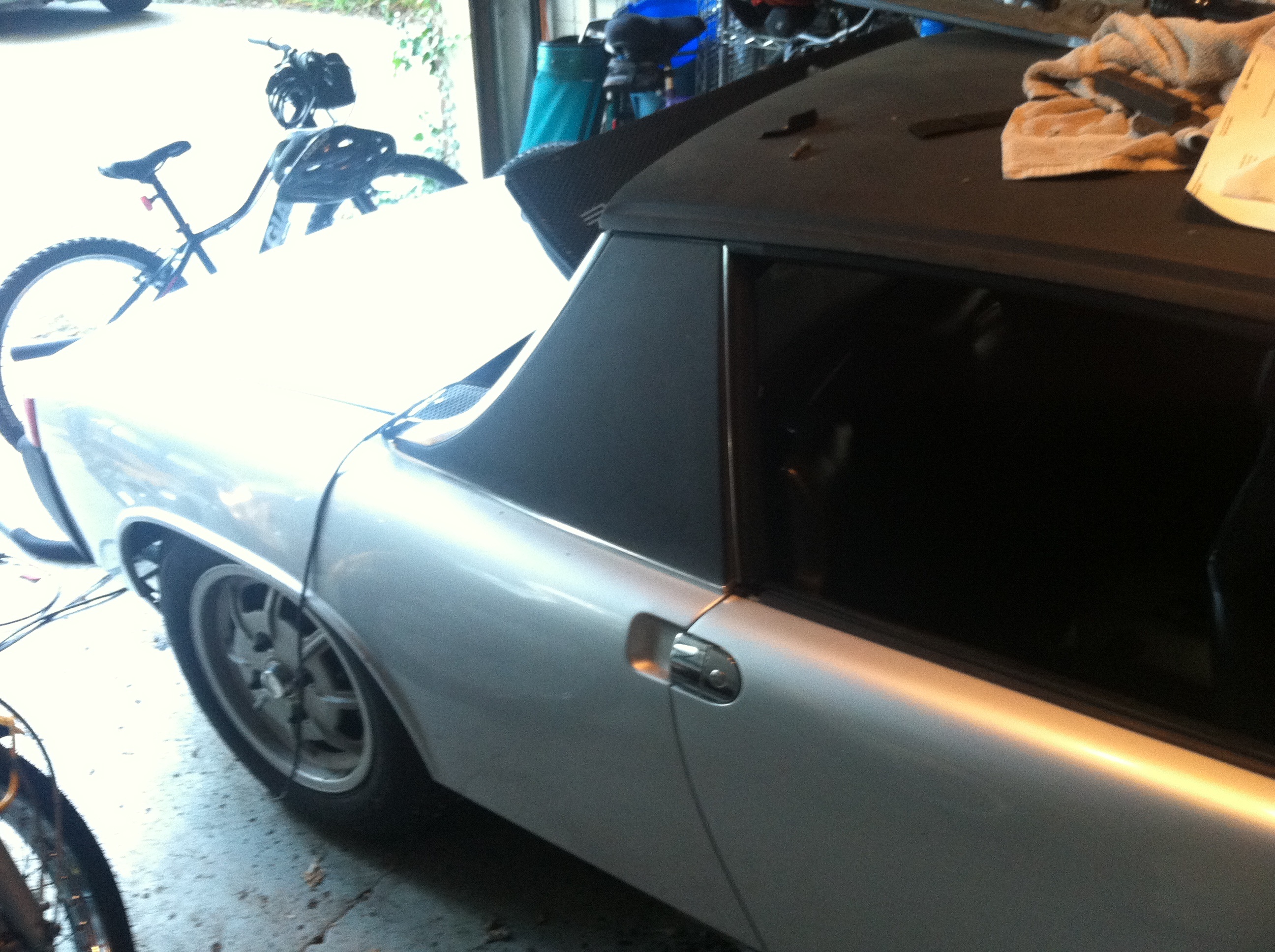

Jgreen
post Sep 27 2013, 03:12 PM
Posts: 15
Joined: 27-September 13
From: Michigan
Member No.: 16,443

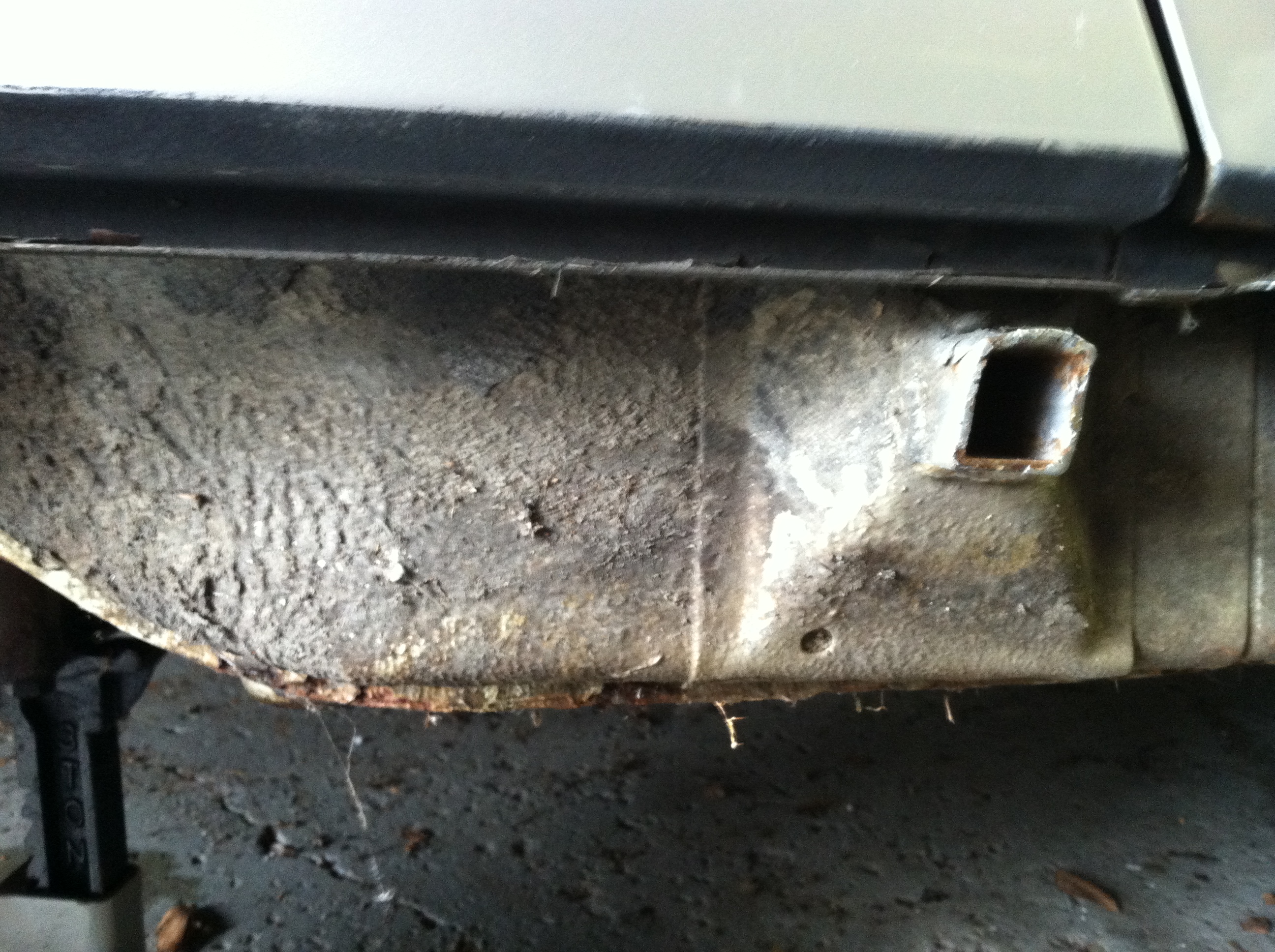

And some more pics. This one looks pretty good.

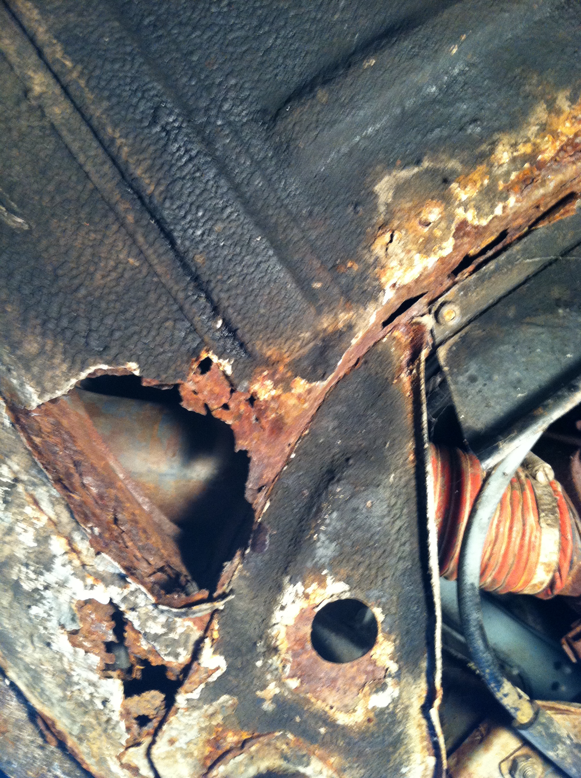

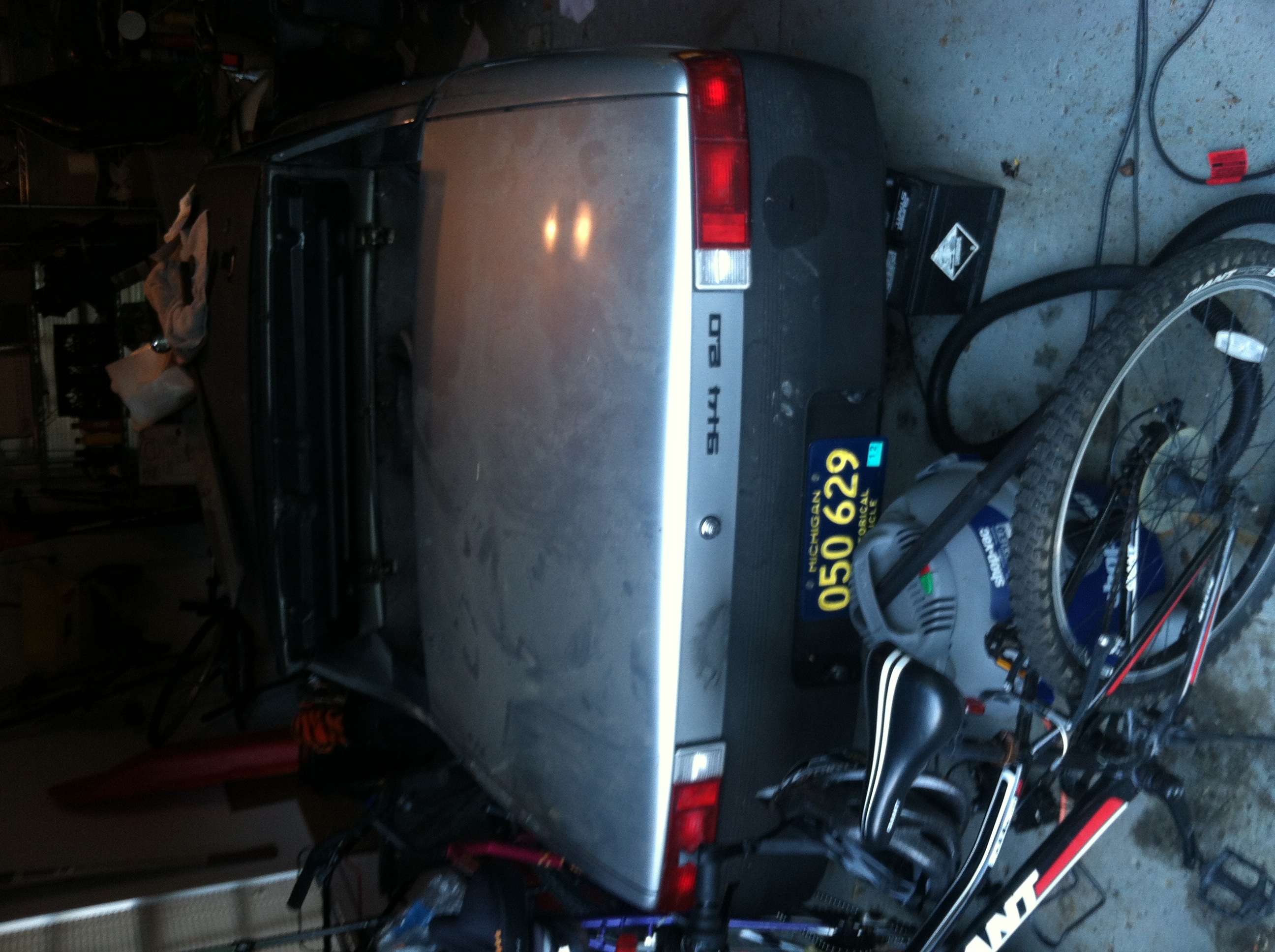

Last pic for now...

Sorry but based on those, you are looking at rear floors, and likely lower rear firewall as well at a minimum.
Before you dive in, you really need to access the rest of the chassis before you make $ decisions. You are well beyond the 3k point from what I can see to do it correctly.

I agree and don't go under that car.
pls give us pics of the entire car when you have some time.
though it is looking more and more like you need a rust free roller to move your parts over to.
then you'll find you need suspension and brake parts.

Here are a few more of the area in and around the HH.
