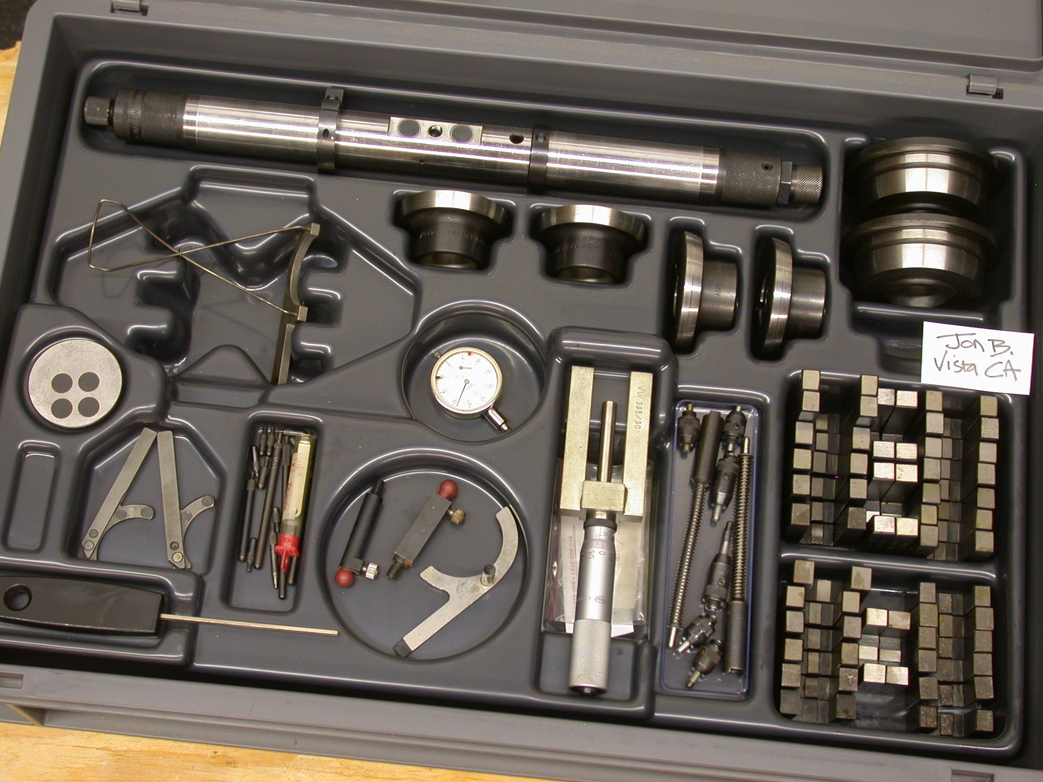

I use the factory tool, or at least a clone of it.
Photo below of factory tool, P258, with all accessories.
This tool will only measure pinion depth; other tools are needed to determine ring gear backlash and differential bearing preloads.
I'm curious to see the clones being made.

Mine was made by a machinist and has the same dimensions as the factory tool. I only have to use it when replacing R/P for failure of inspection or traumatic failure. Most of the time, and I have covered this extensively here and in my DVD, I instruct people to measure gaskets and maintain factory set specs. The vib issues is not much of a concern in the small increments we deal with. It is mainly a nuisance. Many other manufacturers do not do the finite test in leu of just matching patters with dykem or other indicator to a visual pattern.

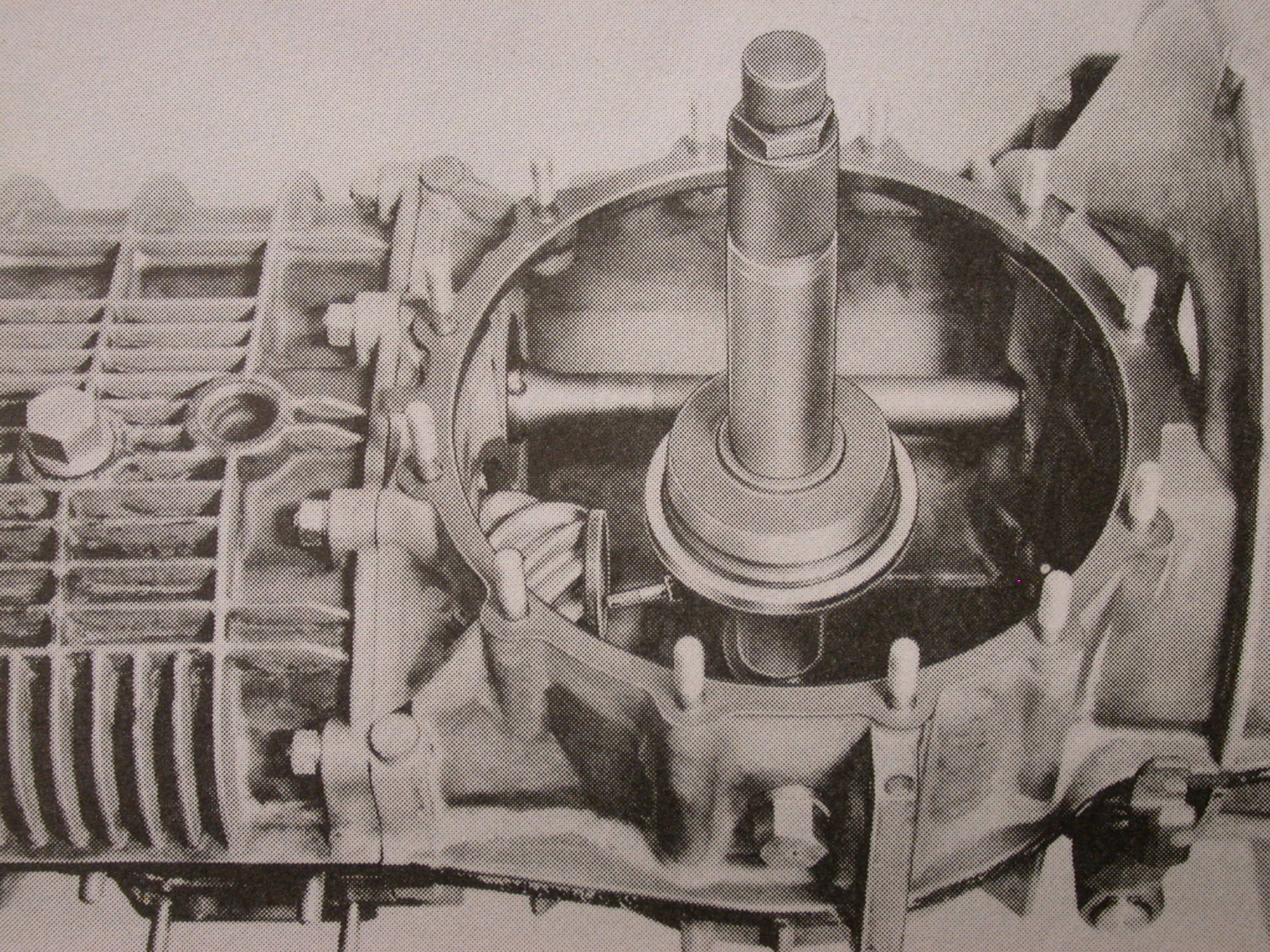

I use the VW tools. Got them to do 915's, but work equally well on 901's.Attached Image

Those are excellent tools, and Porsche-recommended alternative to P258 for 901/911/914 transmissions. I use my set often. Lower photo from 915 manual, showing tool in use with diff cover removed...

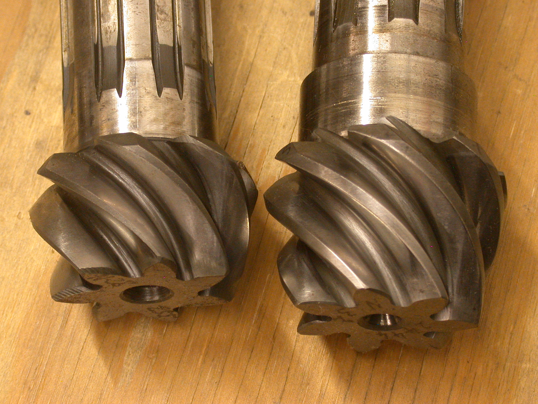

You realize that's alot of engine and torque for a 901/914 transmission. I'm not surprised it's running hot. It will be worse with a TBD or LSD installed. I'm curious to see your cooling system.
Compare 901 to early 915 pinion below. The 7-tooth 915 pinion is from a 2.4 liter road car; Porsche went to an 8-tooth pinion in 2.7 liter series. And you're racing with a 3.0 liter engine...
Jon B.
Vista, CA
It is a lot and around the limit of what you can put through a 901. We pull oil from the drain and put it back on the gears and R+P. The cooler is about 11x8 and has a blower forcing air through it.
