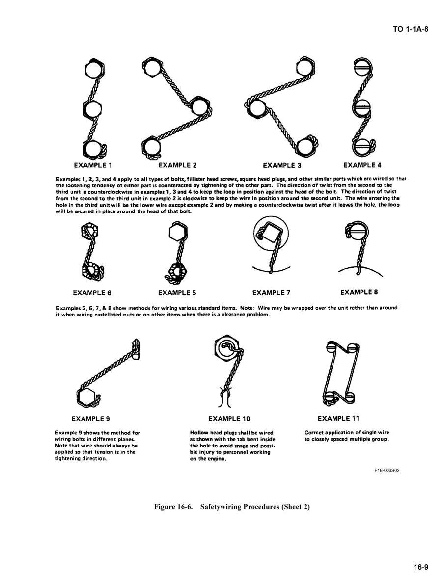

Safety wiring is easy. The tricks are not to overtwist the wire and weaken it, and to make sure that the wire is routed in such a direction as to be pulling the bolt in a tightening direction. I believe that T.O. 1-1A-8 details the process. I'll see if I can find some good illustrations tomorrow at work. BTW, are the cv bolts drilled for wire or does one need to acquire the proper bolts from somewhere?

This
Ctrout
post Jul 19 2004, 07:07 PM
Post #25
Posts: 377
Joined: 20-May 04
From: Mountain Home, ID.
Member No.: 2,091
And this

Saftey wire is king here guys, it is easy to work with, and not much of an extra step after install.
Process is simple drill a hole in hte head of the bolts. You wire so that as one bolt spins out the other will tighten. Easy in words, you just have to think about it when doing it. Oh and the saftey wire plyers make this process so much easier.
Or look at this link.
http://www.whizwheels.com/Tips/safetywiring.html
Cool a new set of tools, and no if you do it correctly they will never come off on there own. But like anything you are now moving your problems else where.
Amd please don't saftey wire your 914 as a cure for rust.
