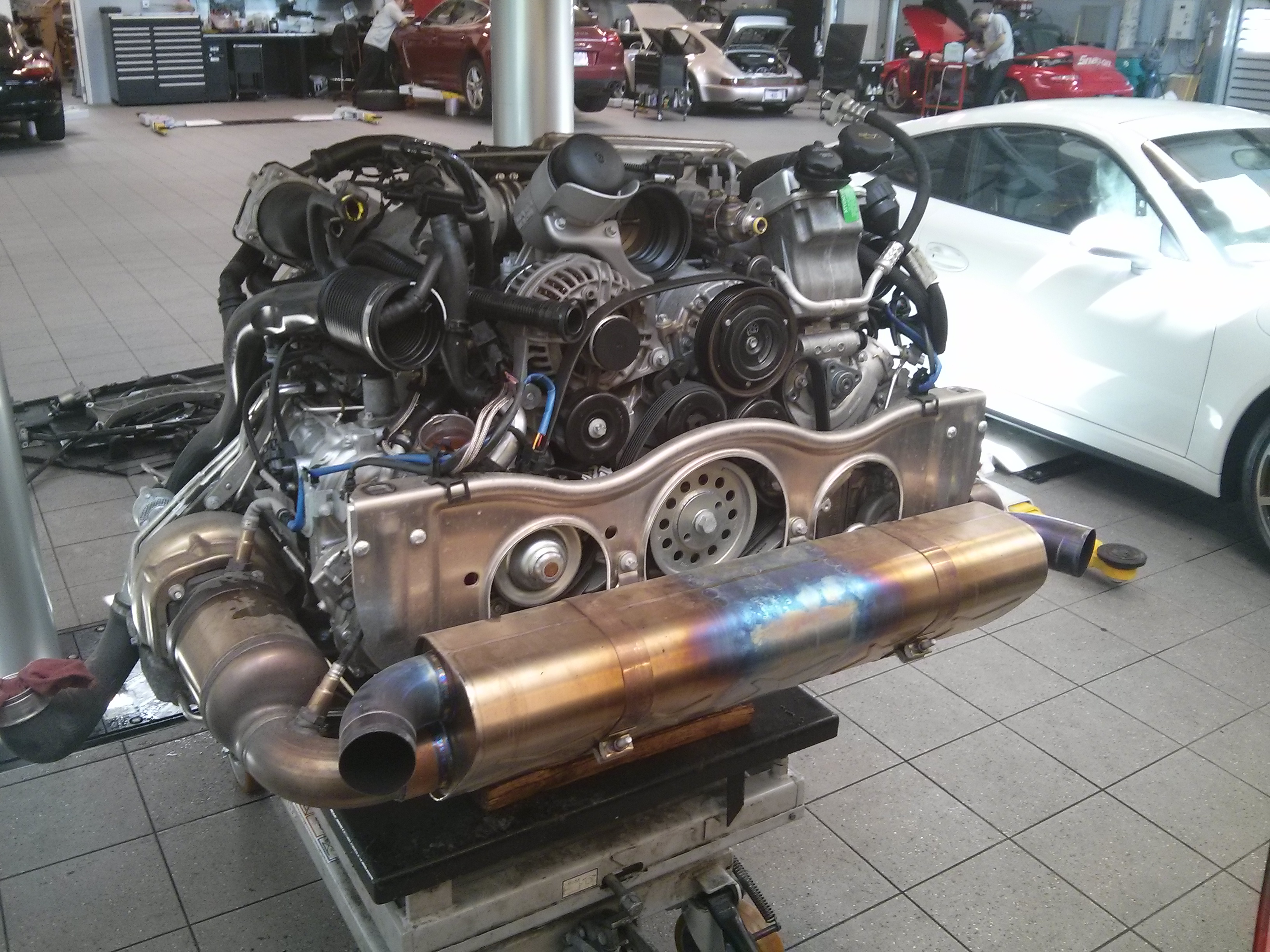

Or better yet
Woody

What is that?
How much?
AND
Tell us, oh guy who should know...
What can a boxster transmission take for torque?
Even better..what is the 918 transmission?
Is it a beefed up boxster tranny, or a whole new thing?
Woody

It's a 997 GT2 engine that I had out a few weeks ago. As far as the Boxster transmissions go, I have never seen any published torque values. Porsche does not give us that information anymore. The base boxster trans is fairly stout. Usually the axles will fail first. The trans in the 918 is going to be entirely different. When I see it, if I am permitted, I will take pictures for you guys. It will have the rear hybrid electric motor in between it and the engine with the ability to use either or both to drive the car.
