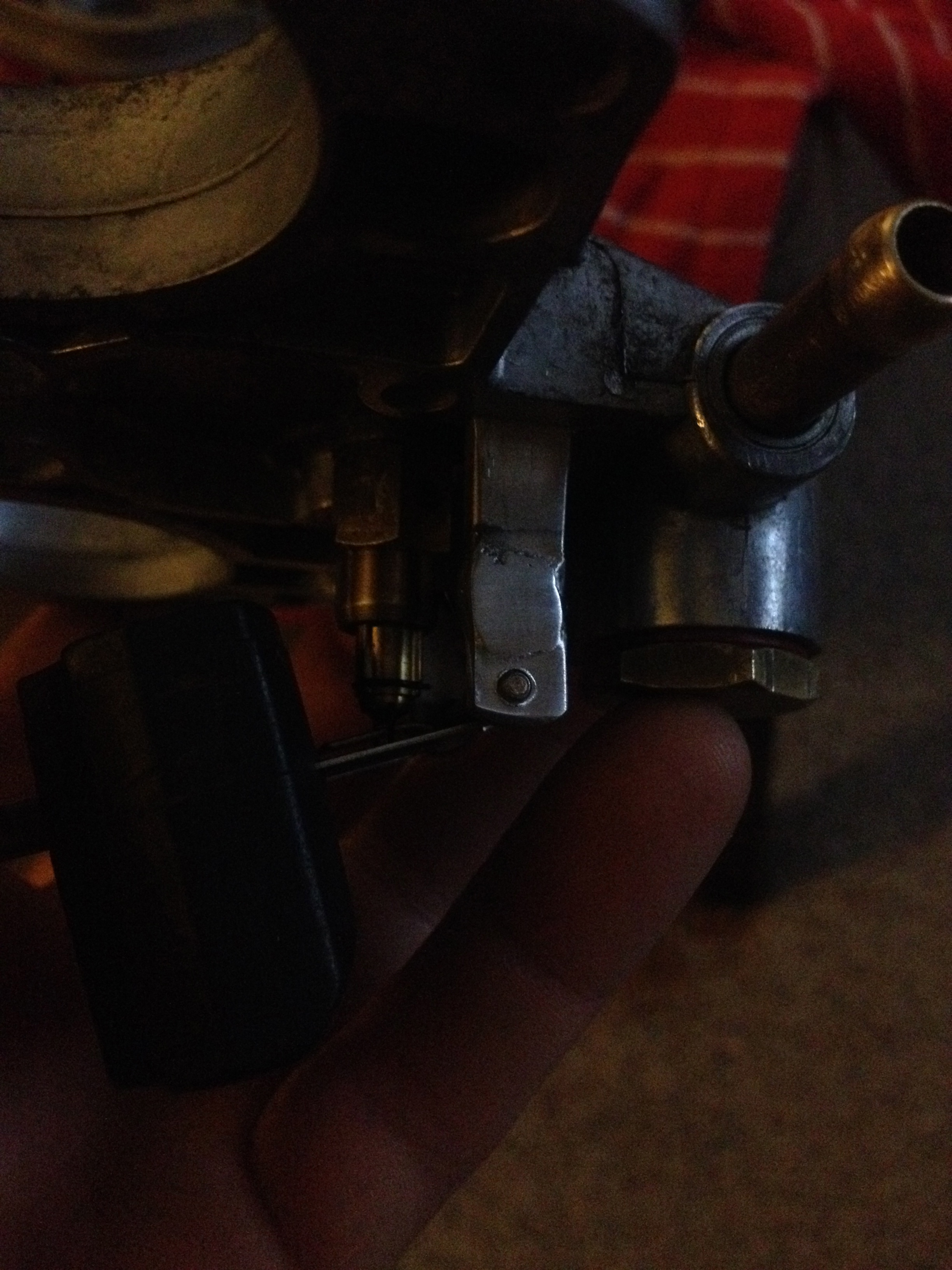

That's a very common problem with Webers. Those ears for the float pivot pin are very fragile. I bet you could take the top to a radiator shop though and have them zap it real quick to weld the broken piece back on - it's aluminum.
Or you can get on the phone with Pierce Manifolds in California and they'll probably have a 44 top that they'll sell you fairly cheap.

is this the set you were sent to replace the first ones? 44 bodies yes? this really sucks mike. you could try ACE too. common? (IMG:style_emoticons/default/dry.gif)

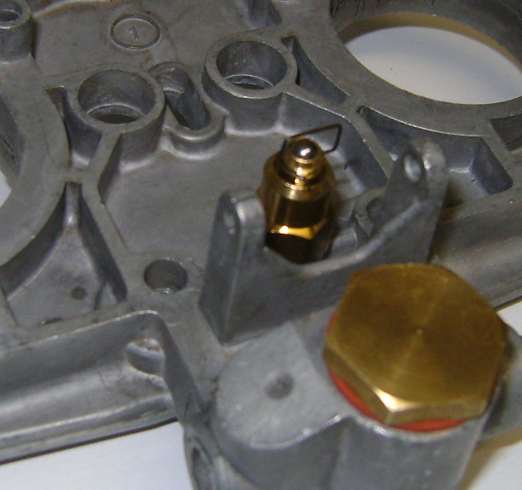

On Webers, the tabs that the float pivot rod slides into is cast in the carb top.
This shows the missing portion of the tab

Thats the spot....theres also this, i posted to the classifieds post as well.
...some nasty looking sheering of metal where the throttle linkages attach....are these carbs still usable, or should I stop dumping time and money into them?

Doh, I looked right past that to what looked like a missing tab on the float. I see. Yes, now all the other recommendations make sense. (IMG:style_emoticons/default/smile.gif)
Weld it, not a prob.

The broken leg is a bit too delicate to weld back on, but a good aluminum welder can build up the remaining leg so a fresh hole can be drilled.
I wouldn't bother trying to reproduce the split though.

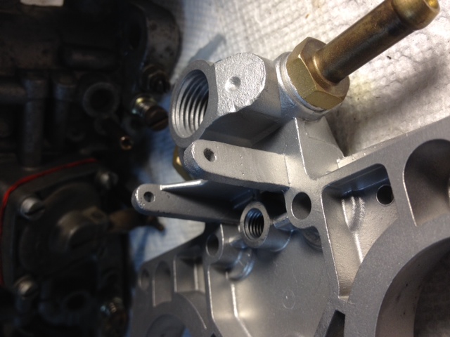

Dont know if blurry pics help but this is a view of your problem:
(IMG:http://www.914world.com/bbs2/uploads_offsite/i366.photobucket.com-10819-1384915397.1.jpg)
Wish I had a pic of the float on to show how much room you have to work with.
More pics of carb rebuild in that folder.
http://s366.photobucket.com/user/stuartjgr...914_build_carbs
