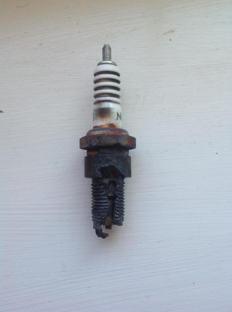

OK, so just incase anyone remembers or cares I was having what seemed to present as a fuel starvation issue.
Last week I took the still unwell car to an airfield track day despite knowing I should solve the problem first. Well you guessed it, I broke it
(IMG:http://www.914world.com/bbs2/uploads_offsite/i595.photobucket.com-14613-1397423305.1.jpg)
Despite the complete meltdown of the plug after much head scratching and beard stroking I borrowed a spare plug and with eyes closed turned the key. It didn't run too badly so I thought we could make it a couple of miles from the track and call the recovery truck. It made it 130 miles all the way home!!
The following day I drooped the engine and removed he damaged head. The offending plug port had a helicoil insert and now a fair bit of damage to the seat face. I had a pair of spare heads so had one cleaned and the valves reground. Yesterday I fitted it and re installed the engine.
You're ahead of me, the issue I had is gone (IMG:style_emoticons/default/cheer.gif) (IMG:style_emoticons/default/cheer.gif) (IMG:style_emoticons/default/cheer.gif)
I can only assume the insert was bad or the fitting of it had cracked the head and when under load for a prolonged period the crack would open with the heat and cause the spluttering as if fuel had run out. By backing off the fuel supply wasn't catching up as I thought but the head was cooling sufficiently to close the crack or leak past the insert.
I've spent best part of £1000 and numerous hours trying to solve this when all I needed to do was break it a bit more!
Thanks all for your input, I've learnt a lot.
brant
post Apr 13 2014, 03:25 PM
Post #34
Posts: 12,167
From: Colorado
Member No.: 47
wow...
that plug is a keeper
so glad you fixed it
nasty plug...
