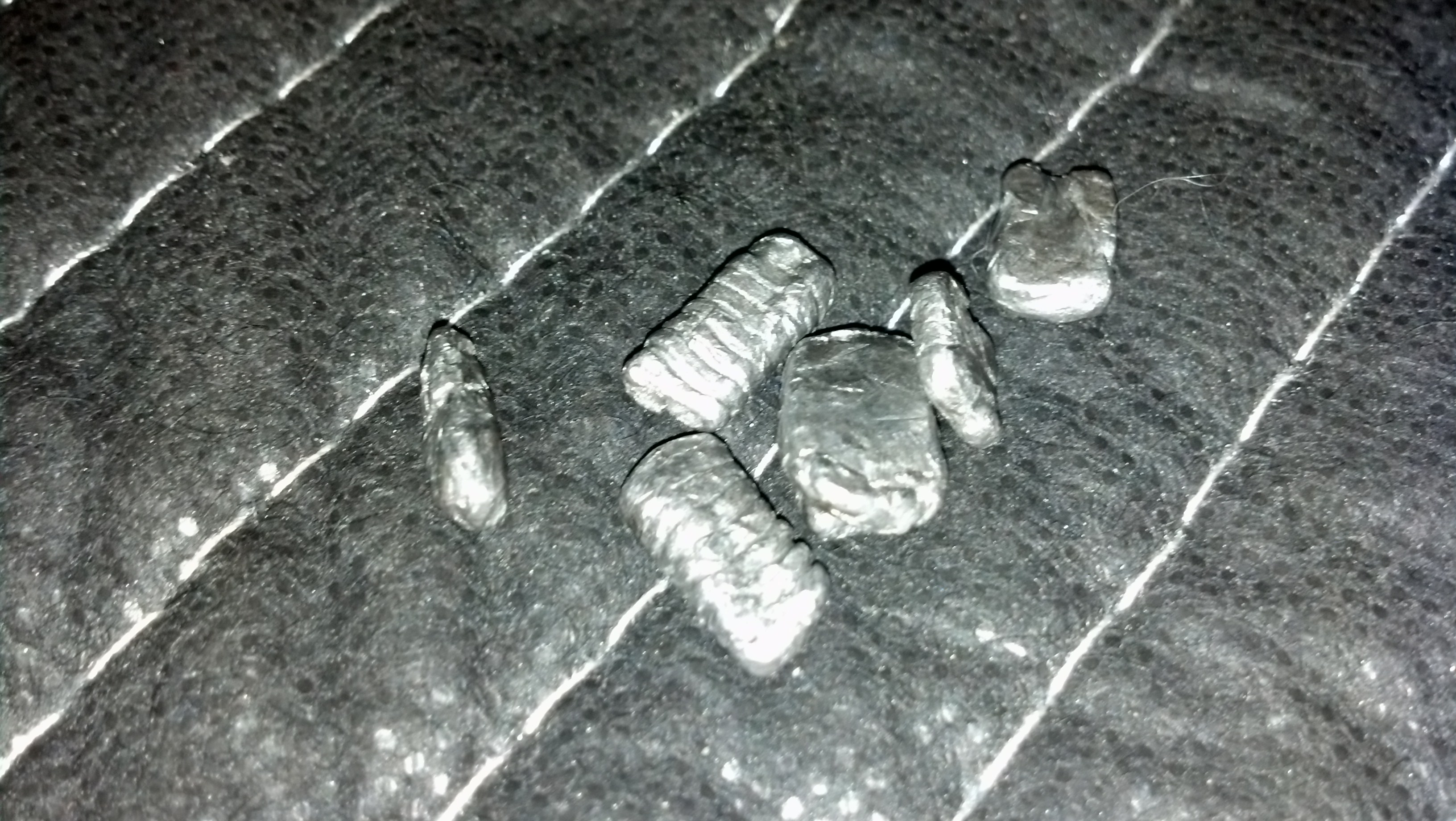

So, I was taking the long way home last Tuesday night after work. After about 15 minuets I got on the interstate and got up to around 75 when all of a sudden a loud knocking started.
I thought at the time that it sounded like a nut or bold fell into the combustion chamber somehow.
It sounded like a piston beating something up.
After a few seconds the sound quieted down a bit. By this time I knew the damage was already done. So, I "limped" it home.
I was finally able to pull the engine today and this is what I found...
Now, I am not missing any nuts or bolts from my ventures, or studs from my intake.
I had my air cleaners on with the rain hat covers on my 40 idf webers.
And spark plugs are damaged, but complete.
It looks like a stud or bold.
Any ideas where this could have come from?

Definitely looks like the remnants of a stud or several... about the right size for the studs to hold your rainhats on?

Can you see if the piston is missing a chunk? That looks like aluminum to me.

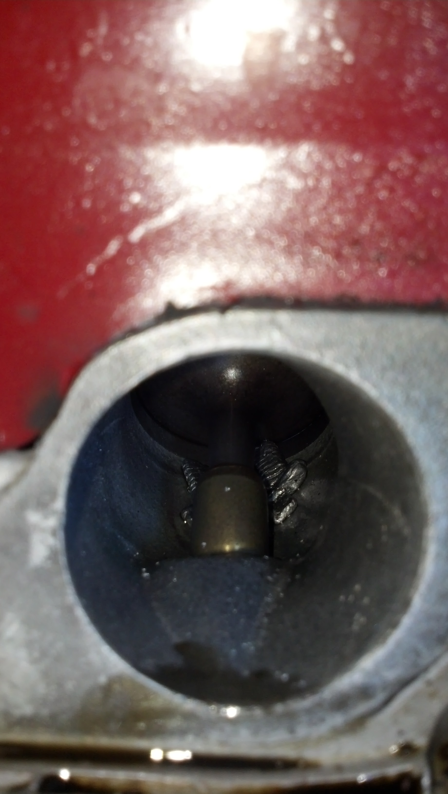

Please explain how those pieces got "munched" and then spit out THE INTAKE valve....
If you had found them in the headers, then that's expected... (Have you looked in the header yet?)
You say you pulled the engine, but have you pulled the head yet?

QUOTE(yeahmag @ Apr 29 2014, 12:45 PM) *
The pieces are metal.
I used a magnet to get them out.
That's what I'm wondering too.
I didn't find anything in the header.

Man... Being ferrous and in the intake like that I can't see how it couldn't come from ABOVE the valve. Really look over all the intake parts again.

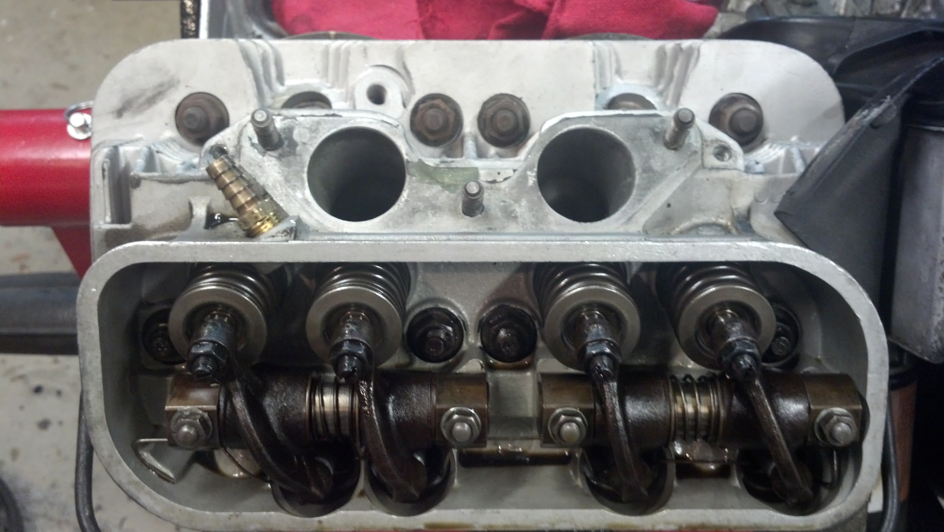

QUOTE(yeahmag @ Apr 29 2014, 01:21 PM) *
See anything I may have missed?

QUOTE(vw_porsche @ Apr 29 2014, 02:40 PM) *
Nothing looks out of place there...

I think you need to look above that. Were you running carbs or the stock FI?

Those got ingested thru the carbs. No way they were spit out of the valve.

QUOTE(yeahmag @ Apr 29 2014, 03:36 PM) *
I have 40 idf webers, with air cleaners and rain hats on top.
I would think it is impossible for something like this to get past the air cleaners.
All of the retaining bolts that hold the air cleaner and velocity stacks on are accounted for.

I would inspect the carbs and intake manifolds carefully. I'd be pretty surprised if you didn't find something missing.
