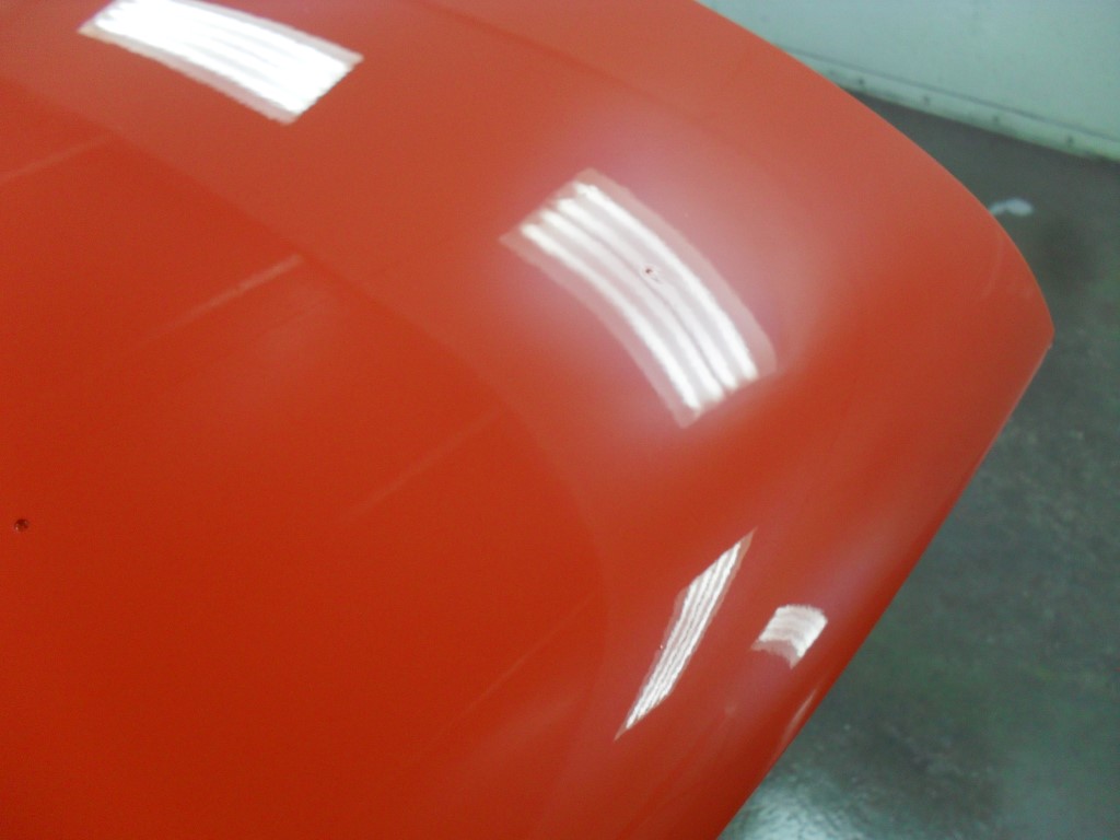

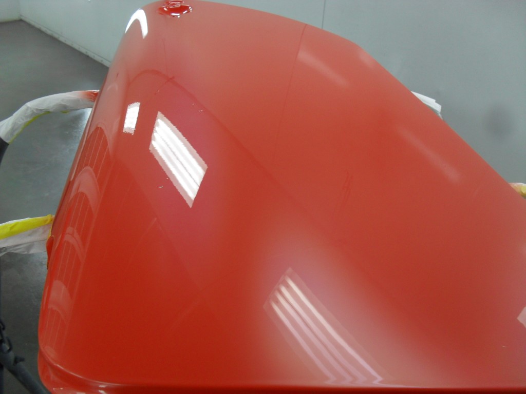

Just a little heads up and info for those of you painting your own cars. Today I had an issue with blushing. In all the years and all the cars I have painted this is the FIRST time I have encountered it.
As I understand it ( Rick, please correct me if I'm wrong ) what happens is on high humidity days ( today was EXTREMELY high ) you have a battle between the solvents trying to escape the paint, and the moisture in the air trying to settle. Well in the world of physics, water is heavier than the solvents so the moisture gets trapped in the clear. I have painted on high humidity days many times, on rainy days many times, on hot days many times, and on days consisting of all 3.....many times yet for some reason today it happened. One of those lovely things about this work (IMG:style_emoticons/default/dry.gif)
The solution ( for now ) was to lay on a couple more coats of clear then let the fan run for about an hour. As soon as I shit the fan down, the blushing started up again. I let the panels sit until the clear was almost setup then cut the fans on again, this seemed to work. I'll know more in the morning. If it is still there, best case I can wet sand and buff it out. Worst case, all 3 panels have to get sanded down and repainted (IMG:style_emoticons/default/headbang.gif)
What looks to be out of focus is the blushing issue. In person it has a nice rainbow look to it (IMG:style_emoticons/default/dry.gif)

The panel was just too shy to have its picture taken :
Maybe the quick temp change along with 100% humidity did it...the windows in my garage are foggy today.
Almost like a super saturated solution scenario (say that 5x fast)

You'll need to kick up the heat to combat the humidity. Be sure the sealed surface is warm. If you have a heat lamp you may want to warm the panels. In a production operation this only doubles your time spent in prep. (IMG:style_emoticons/default/wacko.gif)
On humid days I would even solvent wash my body work and use a heat gun to warm the panels before spraying out any primers. You we had lacquer primers back in the day. (IMG:style_emoticons/default/confused24.gif) Hey it's what we had and it would blush. We were more concerned about primer blush because that means moisture could be trapped on the steel and would cause problem down the road.
Based on what I'm seeing in the photo I'm not sure the blush is any deeper than the surface of the paint. Did you see anything on the sealer?
We used to sand an buff to remove the haze on lacquer and never really had a solvent popping issue or delamination.
Sux though. (IMG:style_emoticons/default/mad.gif)

The blushing was definitely in the clear. I shot the first coat and turned around to hit the hood for the second coat and saw it. Every subsequent coat I put on it went away, then came right back. Apparently turning the fan back on after the paint started to set up did the trick. I came in this morning and it looks fine now. (IMG:style_emoticons/default/confused24.gif)
