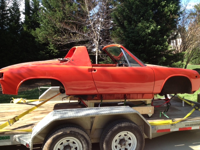

look up JP Stein and his plywood boxes that go under the wheels
McMark
post May 20 2014, 07:16 PM
914 Freak!
Posts: 20,180
Joined: 13-March 03
From: Grand Rapids, MI
Member No.: 419
Yup. JPs boxes kinda freak me out, but he used them for years and they work. Can't argue with success.

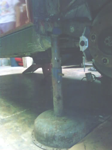

(IMG:http://www.914world.com/bbs2/uploads_offsite/i921.photobucket.com-11654-1400635084.1.jpg)
I think my grandfather made these.

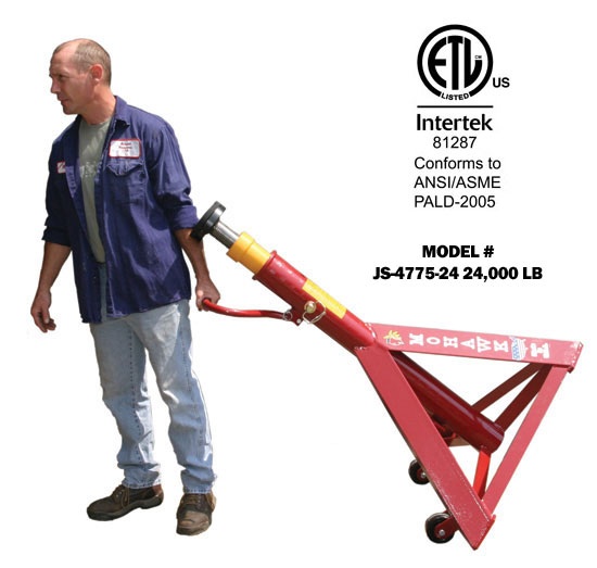

(IMG:http://www.914world.com/bbs2/uploads_offsite/formationsecurite.ca-12234-1400636996.1.jpg)

Yes
Link:
Giant stands

JPs boxes....
Very stable.

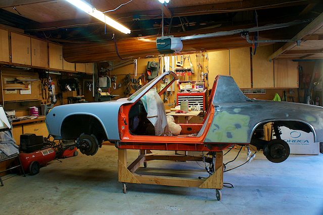

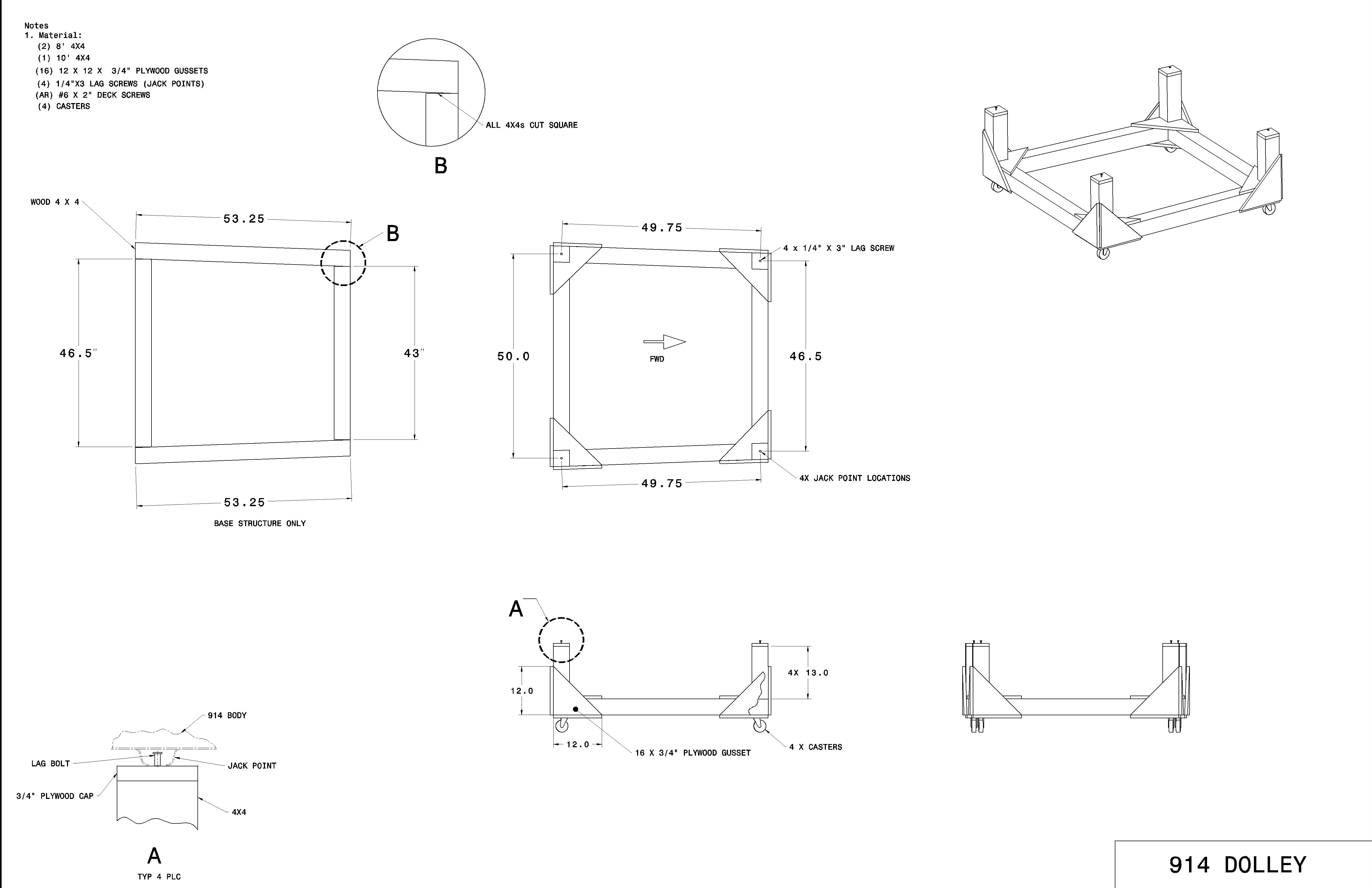

I made this from some 4X4s and 4 casters.
You can even have Home Depot make all of the cuts and you just screw it together.

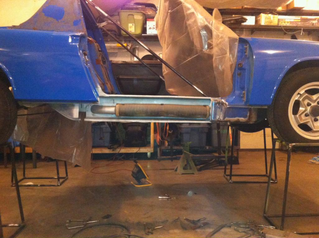

post May 20 2014, 09:08 PM
Hey nice rack! -Celette
Posts: 21,239
From: Now in Superior WI
Member No.: 43
I thought I had a better photo of the stands I used under Ben's 6.

QUOTE(Steve_R @ May 20 2014, 10:41 PM) *
(IMG:http://www.914world.com/bbs2/uploads/post-14777-1400639955.jpg)
Lets you move the car around the garage. Make sure you install the large rubber caster wheels (as shown). I used the little ones at first and had ball bearings flying around the garage. (IMG:style_emoticons/default/blink.gif)
But can't really replace floor panels with this setup.
If you don't need to remove the tires cool setup. Stands would nest after use and not take up much space for storage. Lets you replace floor panels etc.

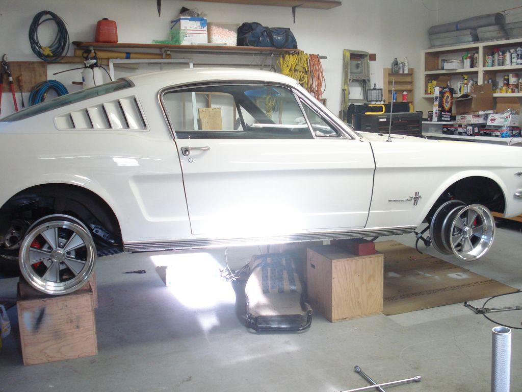

Make some Box Cribs - easy & cheap. Don't use Pressurized Wood!
