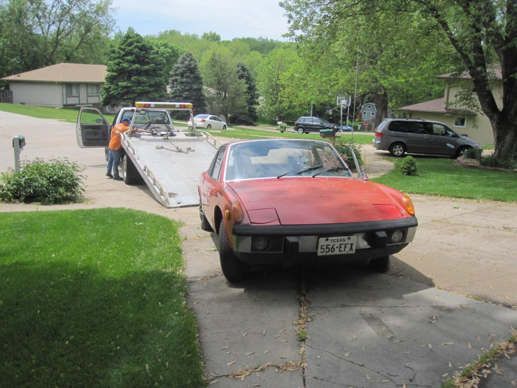

Hello, everyone! I am new to the forum, and to 914s. I just dragged home a 1973 914 1.7L that has been in storage for 27 years, and not started during that time. (It was owned by one man since 1974.) It is in need of inner rocker replacement and door sill/jamb replacement on the passenger side as well.
The goal of the project is to make it safe and get it running while keeping it as original as possible for as little money as possible.

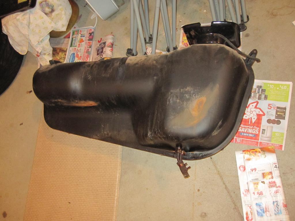

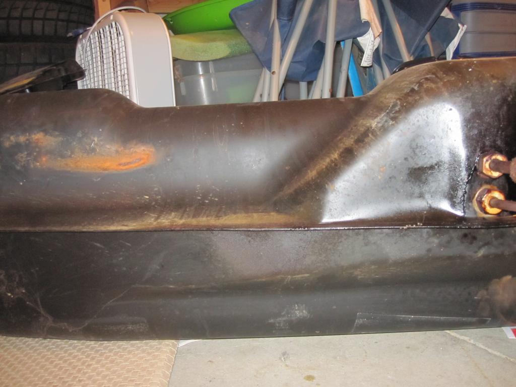

Last night my husband and I pulled the gas tank preparatory to replacing the fuel lines. The car was put into storage out of gas, fortunately. The tank looks good from the outside. Should we get it boiled out and sealed, or is this an unneccessary expense?
If we don't do that, I will probably use POR15's cleaner and degreaser with a quart of hot water to clean it.

Kim inside the tank. Sometimes they survive very we'll. you will need to pull the fittings on the bottom and replace the filter sock and gaskets.

Any local radiator shop can boil it for you. Just don't use the POR15 sealer in the tank. Too many horror stories about that stuff.
Change ALL the rubber hose bits. Get a fire extinguisher. All the fuel lines in the engine bay will be dry rotted after sitting so long.

I've used RedKote on my last two cars and no issues. The 72 was done over 6 years ago

Pull off the filler neck and give a look inside. You will need a new gasket up there anyway. If there is no rust I am not sure if you should do anything. My had a little so I used an eastwood kit 20 years ago and It has been great. Included stripper. Welcome!

(IMG:style_emoticons/default/agree.gif) Take a look inside. It might be fine in there. Mine was like new when I looked at it last year.

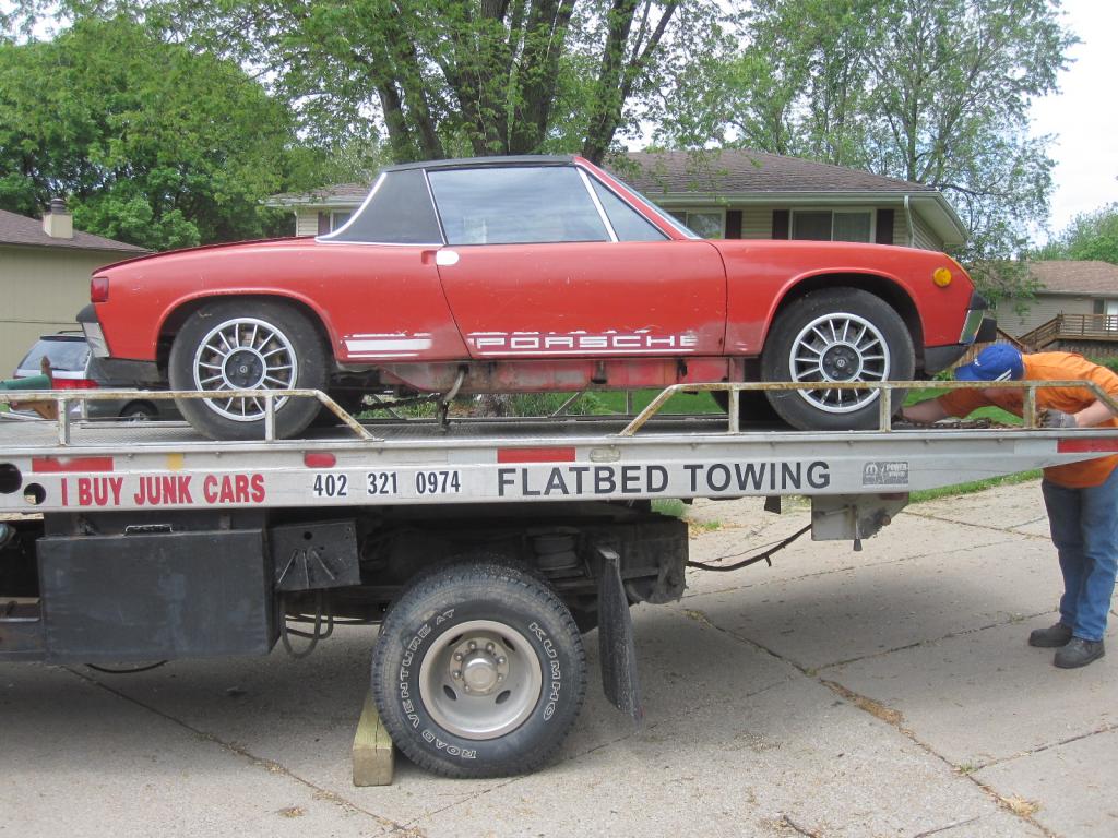

(IMG:style_emoticons/default/welcome.png) Did anyone else notice where the wrecker driver hooked the car? That has to be a pretty solid car or it would have folded up! (IMG:style_emoticons/default/unsure.gif) Nice Start!

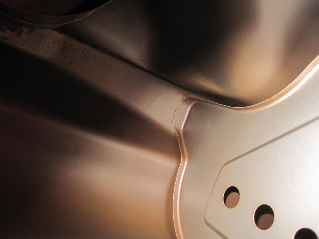

ETA: I pulled the fuel level sending unit and filler neck today. The inside of the tank is clean and shiny, so I think I won't worry about getting it cleaned.

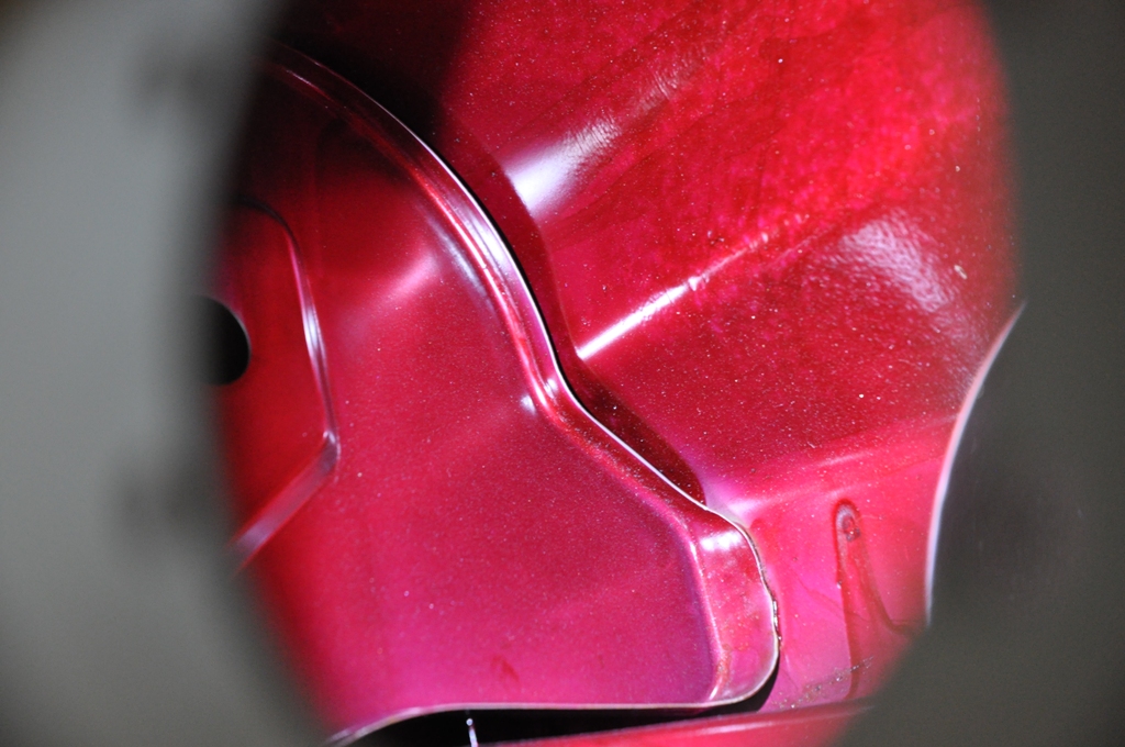

Pulled our tank- sending unit and all- varnish corrosion blargh. Sending unit is likely toast, but well see.
It's headed to the radiator shop in am to get dipped and sealed.

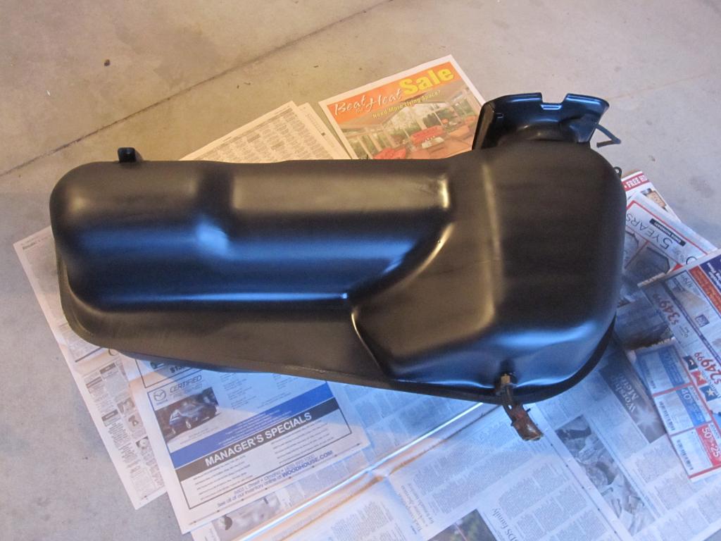

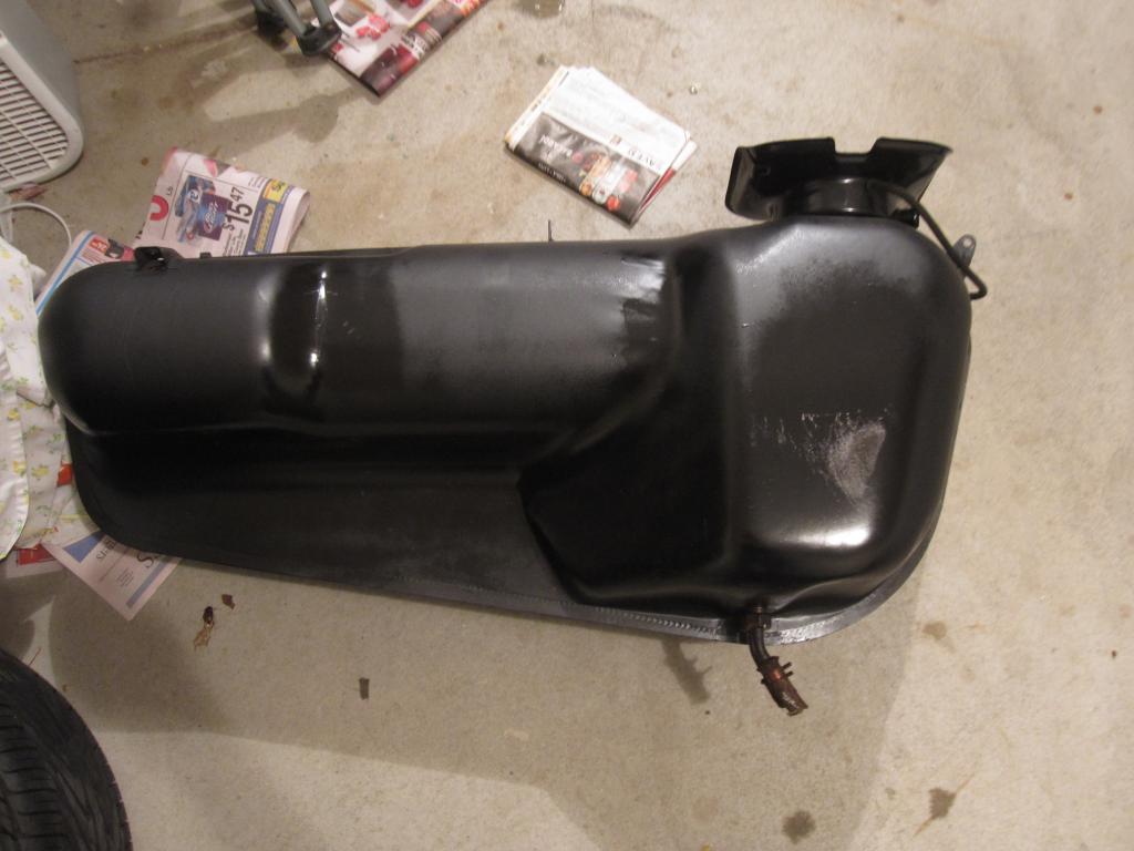

Here's some pics of my tank:
(IMG:http://www.914world.com/bbs2/uploads_offsite/i603.photobucket.com-17396-1401162702.1.jpg)
As pulled:
(IMG:http://www.914world.com/bbs2/uploads_offsite/i603.photobucket.com-17396-1401162702.2.jpg)
Cleaned and sprayed with Duplicolor Rust Fix:
(IMG:http://www.914world.com/bbs2/uploads_offsite/i603.photobucket.com-17396-1401162702.3.jpg)
Painted with matte black Rustoleum:
(IMG:http://www.914world.com/bbs2/uploads_offsite/i603.photobucket.com-17396-1401162703.4.jpg)
I'm enjoying working on the car. I'll be glad to get it running, but I have a secret weapon to keep the anticipation from killing me - a Miata in the garage. It helps. Try it! (IMG:style_emoticons/default/biggrin.gif)

Great looking tank!!!! If we all were so lucky to have that clean of a tank to start with. I agree to going through the brakes, do it now and you won't have to think about it for quite a while. Is it still fuel injected? Looks like you got a good starting point. Was it an original Texas car? Hopefully from dry west Texas, which would explain why the jack point was strong enough to anchor the car down.

The car was in Texas only for a while - the owner bought it in Lincoln, Ne., and was transferred to Texas only for a year or so, I understood. When they moved back to Nebraska, they didn't register it here because it was nonoperational at that time.
