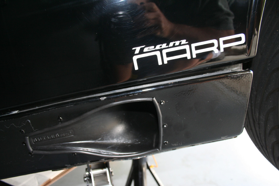

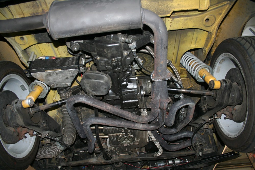

This works good for me.

QUOTE(Elliot Cannon @ Jun 3 2014, 07:21 PM) *
I like.

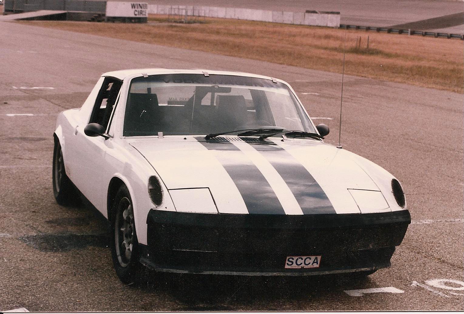

QUOTE(Harpo @ Jun 3 2014, 06:44 PM) *
Has anyone installed a oil cooler in the Frt right wheel well like they did on the 911's? There are lots of threads on radiators in the front bumper and above the trans.
Thanks
David
We installed two small oil coolers in the front fenders of my 914 race car, but, being a (mostly) race car, we were able to remove the front turn signals to allow air to flow to the coolers. We added the side marker lights after this picture was taken to serve as turn signals when driving on the street.

QUOTE(Elliot Cannon @ Jun 3 2014, 04:21 PM) *
Elliot
I understand you have a FAT performance engine, so what kind of oil temps are you getting with this setup with hard driving?

QUOTE(Elliot Cannon @ Jun 3 2014, 03:21 PM) *
I did the same thing with an air scoop on the rocker panel which as a hose forcing air on the auxiliary oil cooler with a fan mounted on the backside wired on a thermostat. I did mine on the passenger side. I also put in a new exhaust system from Tangerine Racing to get the clearance needed. My oil temps rarely get above 210 even on the hottest days in Atlanta traffic. Downside is I gave up my stock heat exchangers to put in the exhaust system, so it's a chilly ride in the winter. In cooler weather I block the rocker panel scoop with a drain stopper (works great!). Otherwise, the oil will not get to 180.
jmill
