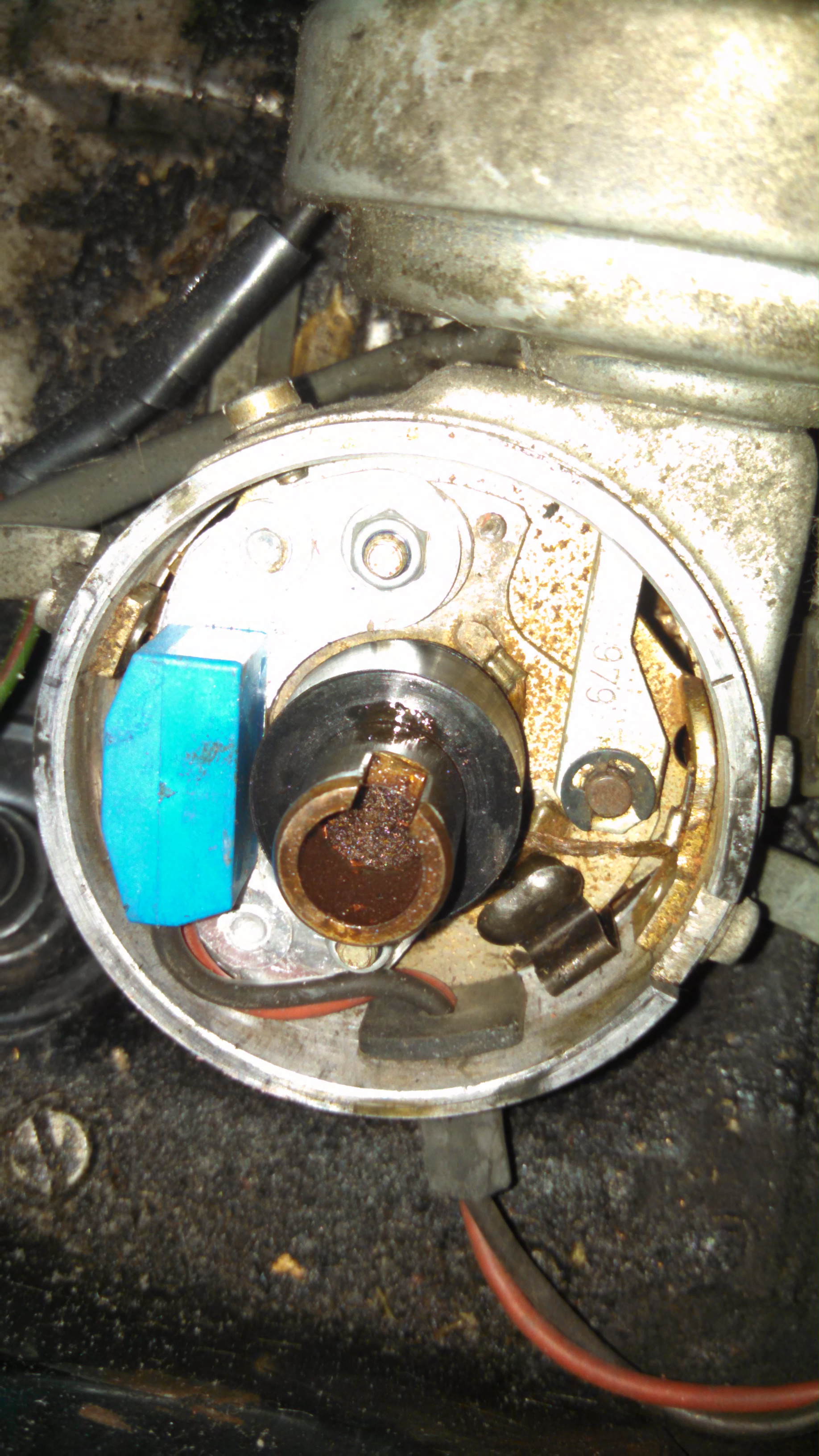

QUOTE(Java2570 @ Jul 4 2014, 06:17 PM) *
Check the ground wire that runs between the points plates in distributor....if it comes off, it can cause a no start situation.
Not sure where to look for that in there? Will it be obvious? I'll snap a photo tomorrow if I don't see anything obvious.

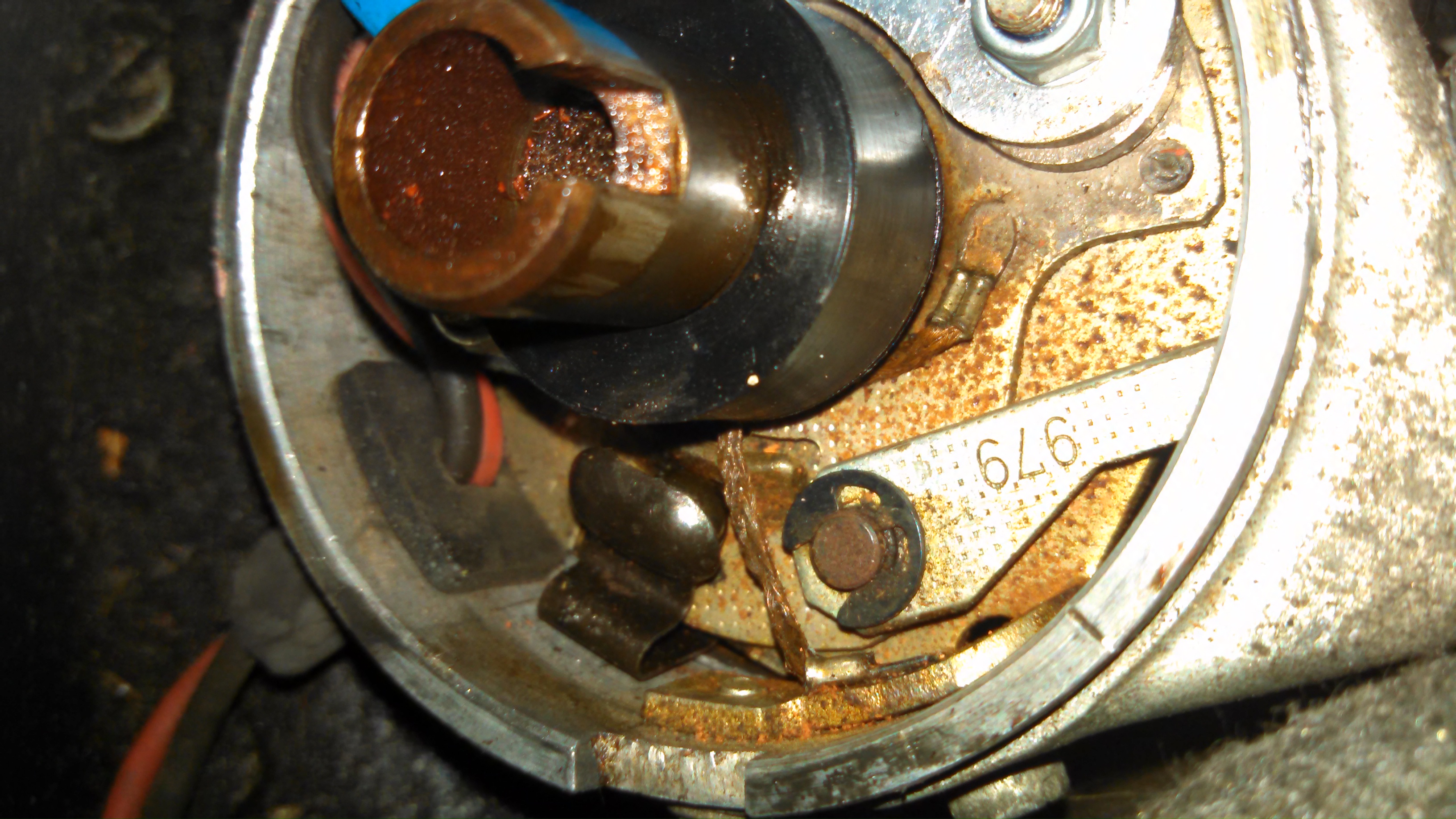

I went at looked at the ground strap on the contact breaker plate. Looks OK.

Ground in dizzy appears ok.....pretty dirty in the dizzy though. It could definitely be a fried Pertronix module or perhaps one of the wires from the module to the coil has come loose in it's connector? I've got Pertronix and I've had that happen due to a poor crimp on the connector (my fault). I've not had a module fry out suddenly but I know that it could happen. My goal is to have a spare dizzy in my emergency kit setup and ready in case something happens like that. And I'd look at the rotor and cap as well....
