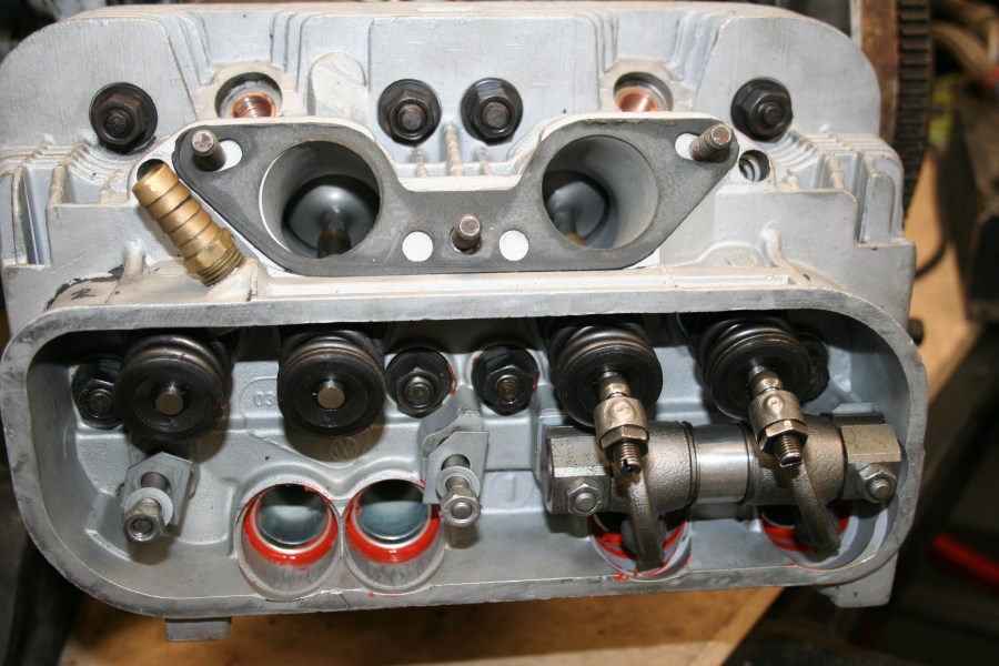

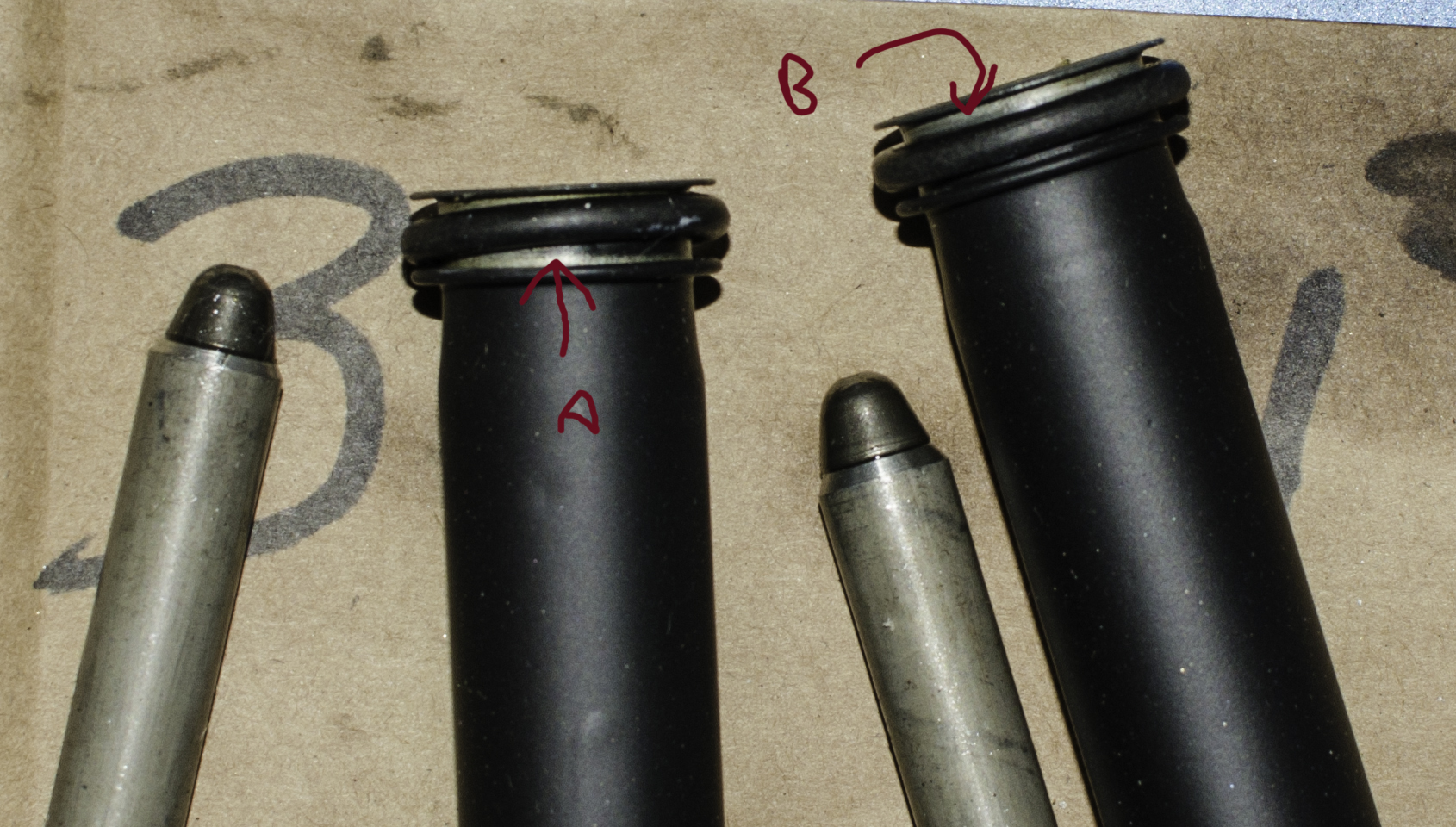

this question is about the push rod tube seals and what to use if anything?
I have read many opinions... still not sure
if I use a sealant like permatex high temp thread sealant,,,,,,,,,,
where would I place it......A or B or not ?
the seals in the image are old and not replaced yet
thank you

still,,,,,,,, I am not sure as to "how" to apply the "Permatex #59214 High
Temperature Thread Sealant with Teflon."
with threads it reads to add a small bead around the third thread as it will
spread out..
no threads on the tube... so which side of the o-ring or on the o-ring??
tks

Both sides. Just coat the oring.
With that stuff, a little too much wont hurt anything

When you put the rockers back in, the slot on the clamp faces down.
The springs can go in after the pushrods, but before tightening the rockers down all the way down.

The lower part of the spring should rest on the shoulders of the tube, and not poke down into the tube. If the spring does poke down the tube, you can use a hook to pull the spring outward, and it should catch on the shoulders of the tube.
Failing to do so can result in a nice notch near the end of your pushrods, ad the steel spring grinds away the aluminum rod.
