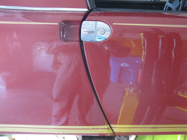

> Is door gap widening when car is lifted normal?
doug_b_928
post Aug 10 2014, 08:10 PM
Posts: 730
Joined: 17-January 13
From: Winnipeg
Member No.: 15,382
I lifted my car for the first time today. The longs have rust and the gap at the top of the door widened (the weight of the rear of the car was pulling it down such that the door gap opened more at the top (see pic below).
I'd say it was double what it is when the wheels are on the ground. So, I won't be surprised if this is because of the rust having weakened the chassis (in fact, I'm glad that it didn't snap off completely), but I'm wondering if some widening like this is normal when the car is lifted from the jack point areas (i.e., using a two post lift) and, if so, how much one should expect.
flash914
post Aug 10 2014, 08:27 PM
Posts: 124
Joined: 1-January 11
From: littlerock CA
Member No.: 12,554
The car new would have none- no change. Joe Sharp -a well known name on this forum- told me to open both doors and have a 225 lb. person stand on the door sill and jump. I would not do that on that car I would go straight to repairs. Gordon
VaccaRabite
post Aug 10 2014, 08:44 PM
En Garde!
Posts: 13,845
Joined: 15-December 03
From: Dallastown, PA
Member No.: 1,435
That car has cancer. Probably bad if the gaps are opening up.

scotty b
post Aug 10 2014, 09:03 PM
rust free you say ?
Posts: 16,375
Joined: 7-January 05
From: richmond, Va.
Member No.: 3,419
bad news. All that bubbling under the gold decal isn't a good sign either. More likely than not, the bottom of the door jamb is also shot.
doug_b_928
post Aug 10 2014, 09:18 PM
Posts: 730
From: Winnipeg
Member No.: 15,382
Yes, the car has lots of cancer. Good to know that the gaps shouldn't widen. Would the gap pictured above be from the weakness in the area where the longs intersect the firewall? The rust on this car is similar to the 'bringing out the dead' and 'digging into hell' threads, but they didn't mention anything about sagging like this.
rick 918-S
post Aug 10 2014, 09:28 PM
Hey nice rack! -Celette
Posts: 21,238
From: Now in Superior WI
Member No.: 43
Straight to repairs. Don't mess with it too much or the door won't close any more. I had one that collapsed on the floor when We stood on the rocker with the door open.

doug_b_928
post Aug 11 2014, 05:54 AM
Posts: 730
From: Winnipeg
Member No.: 15,382
Thanks for the feedback guys. I removed the engine (was a little puckered being under it knowing it was sagging), and the door gaps were just as big without the weight of the engine (IMG:style_emoticons/default/sad.gif)
