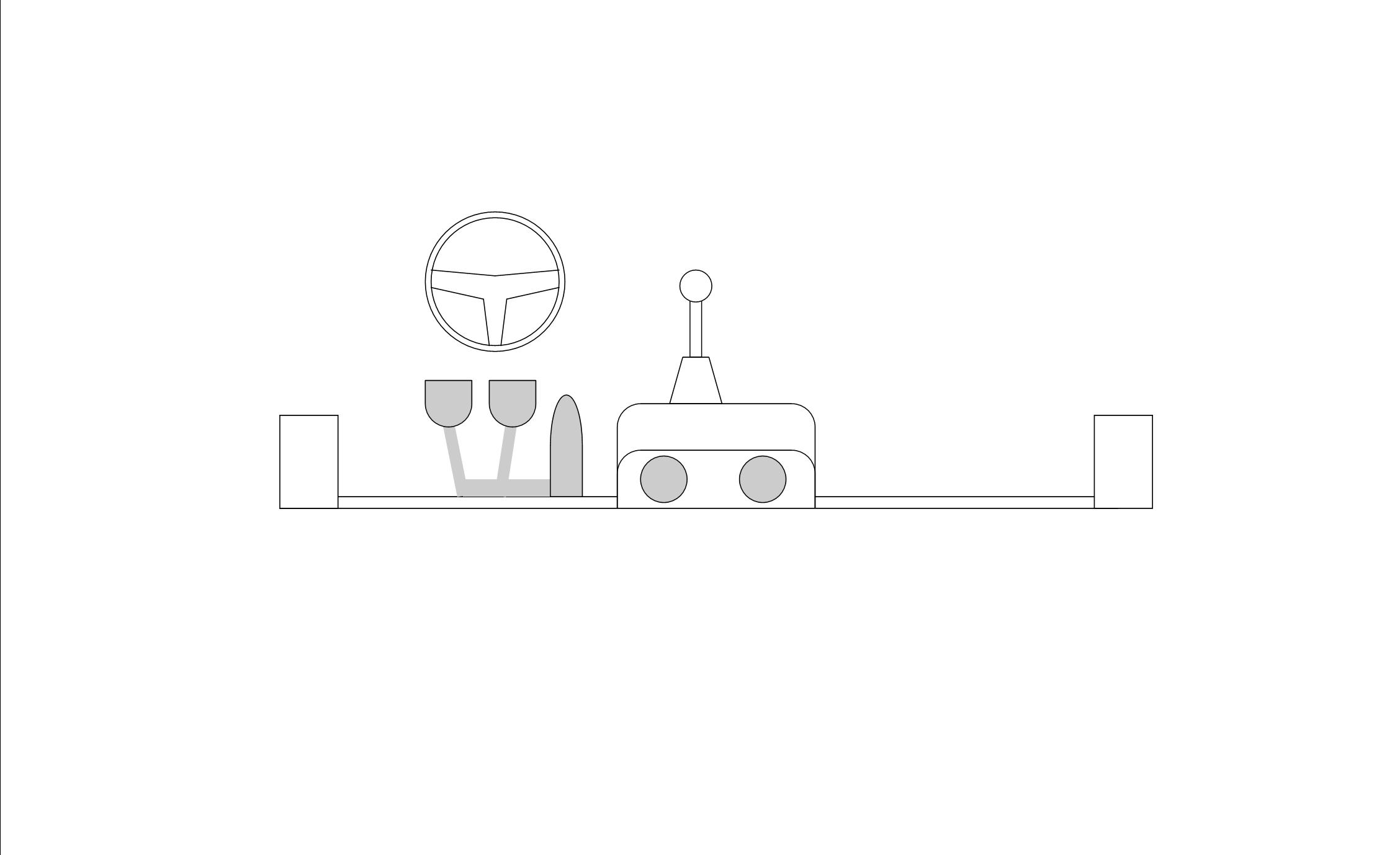

On my next conversion, I am going to raise the center tunnel and create a large channel for hoses under center of the car.

QUOTE(Mike Bellis @ Aug 27 2014, 06:12 PM) *
This would also allow for easy access into the interior for the heater core, not to mention anything else you want to build out of the system. I like this idea!
