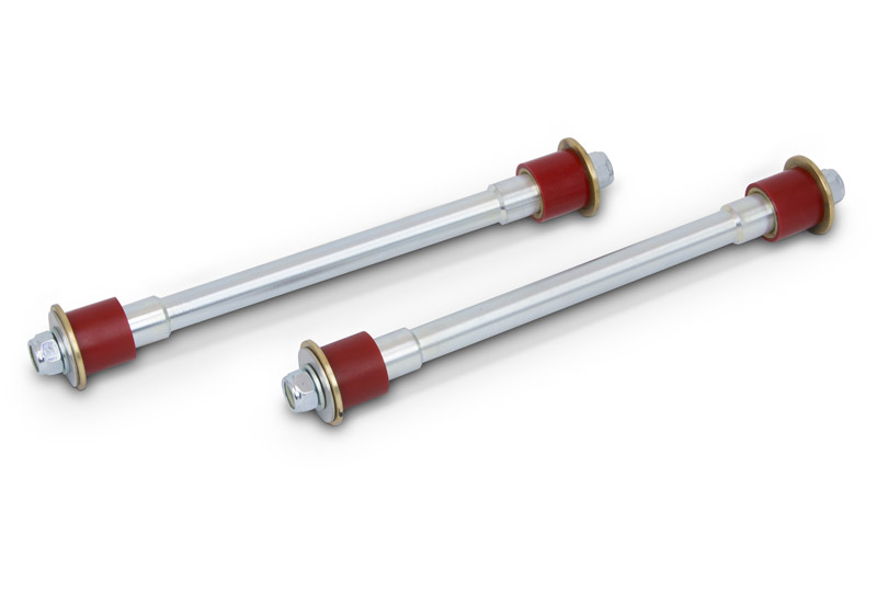

I'd replace them if they badly rusted. You can buy fancy new ones from Tangerine racing and here's the link:
http://tangerineracing.com/suspension.htm
I bought a used set from Eric at PMB Performace that were cleaned up and freshly placted. I would have put them in the picture but I bought them months ago and they're burried in a pile of of boxes of parts for my car. I have not pulled out the old ones yet so I'm not sure what condition mine are in. You can also check with Elephant Racing and see if they will sell just the shafts from their rear control arm bushing kits.
Here's a picture of the Elephant Racing shaft with their kit.

Call a local metal plater like (Google is your friend):
http://www.leonardplatingcompany.com/
Have them prep (remove the rust) and "clear" zinc plate yours. They'll probably be done tomorrow afternoon if you get them there in the morning.
Make sure you ask them to remove "all" of the rust before they replate them. Zinc will take over from there and protect them for another 40 years. They don't serve any other purpose than to support the Rebel sleeve (well, that and carry the entire load of the back of the car! (IMG:style_emoticons/default/biggrin.gif) ) so, I'd say that a minimal amount of pitting on the old bushing surface shouldn't affect the load rating at all. I'm "guessing" that Rebel wants you to JB that sleeve onto the shafts. Those old pits may serve some purpose in retaining some of the epoxy.
We do a lot of Elephant installs and we'd send our pitted shafts to McMark for his roller bearing installs. His design used a bearing race much like the Rebel product sleeve but, they machined the pitted ends down on the rods and glued their races on there. It made for a very precise fit. That's the piece (the precision fit) that all of these bearing/bushing systems have to overcome. They all do it in slightly different ways.

Using factory shafts with precision bearing or bushing installations ensures that a loose fit will be required or the system will bind.
The shafts were never intended to serve as a bearing surface, and glueing bearing sleeves on them does not improve the poor colinearity from one end to the other.
