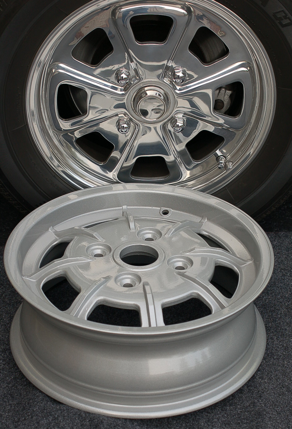

Thomas powder coated my old Mahles and made them look great.
http://www.914world.com/bbs2/index.php?sho...=194485&hl=

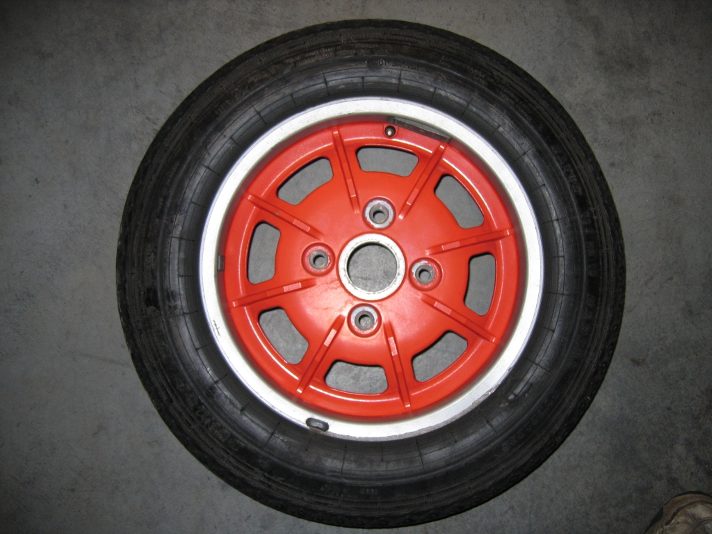

It's not, it's painted. Two tone Mahle rim, silver lip & center, phoenix red middle.

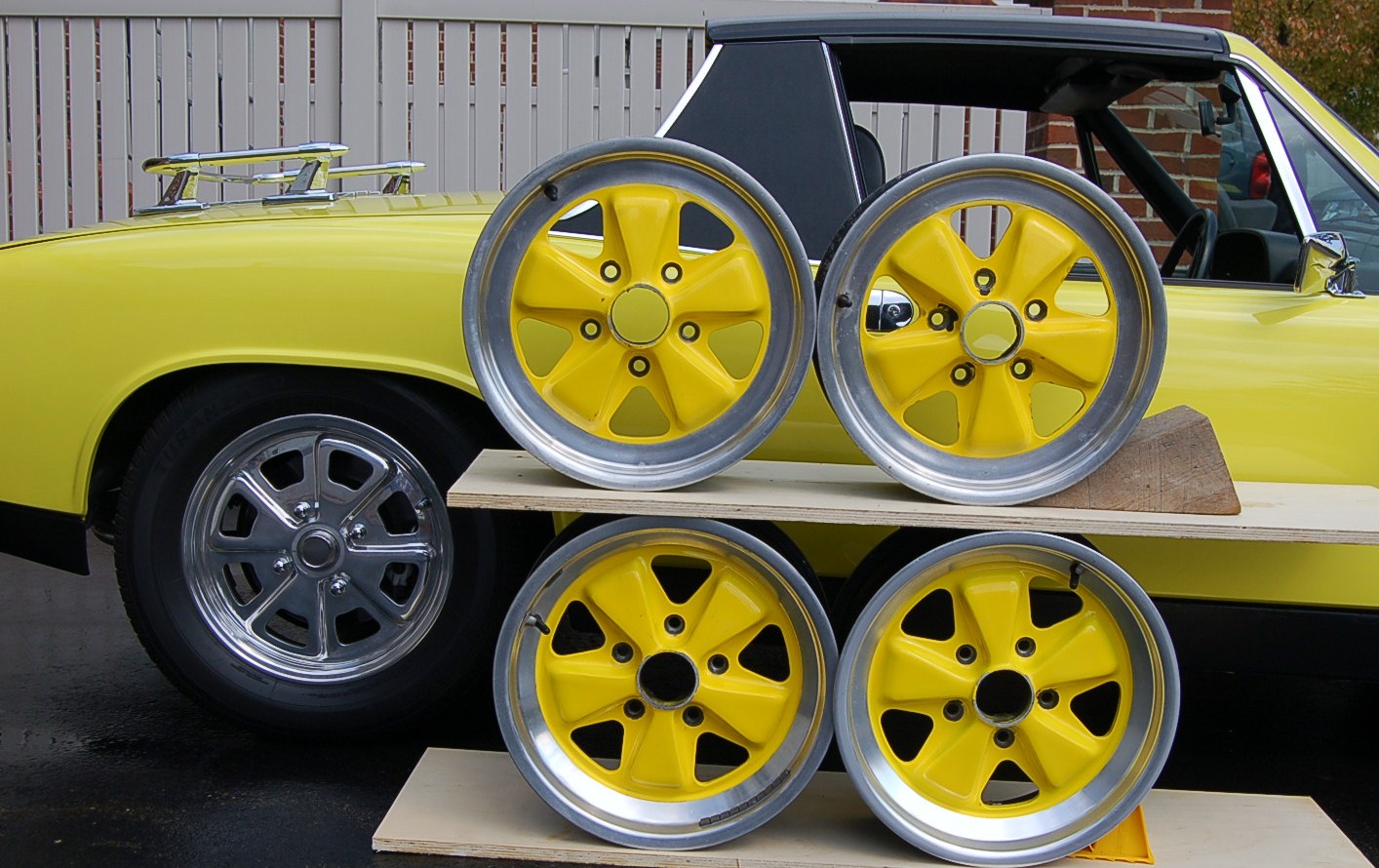

My fuchs are powder coated, pretty convincingly done as well!
