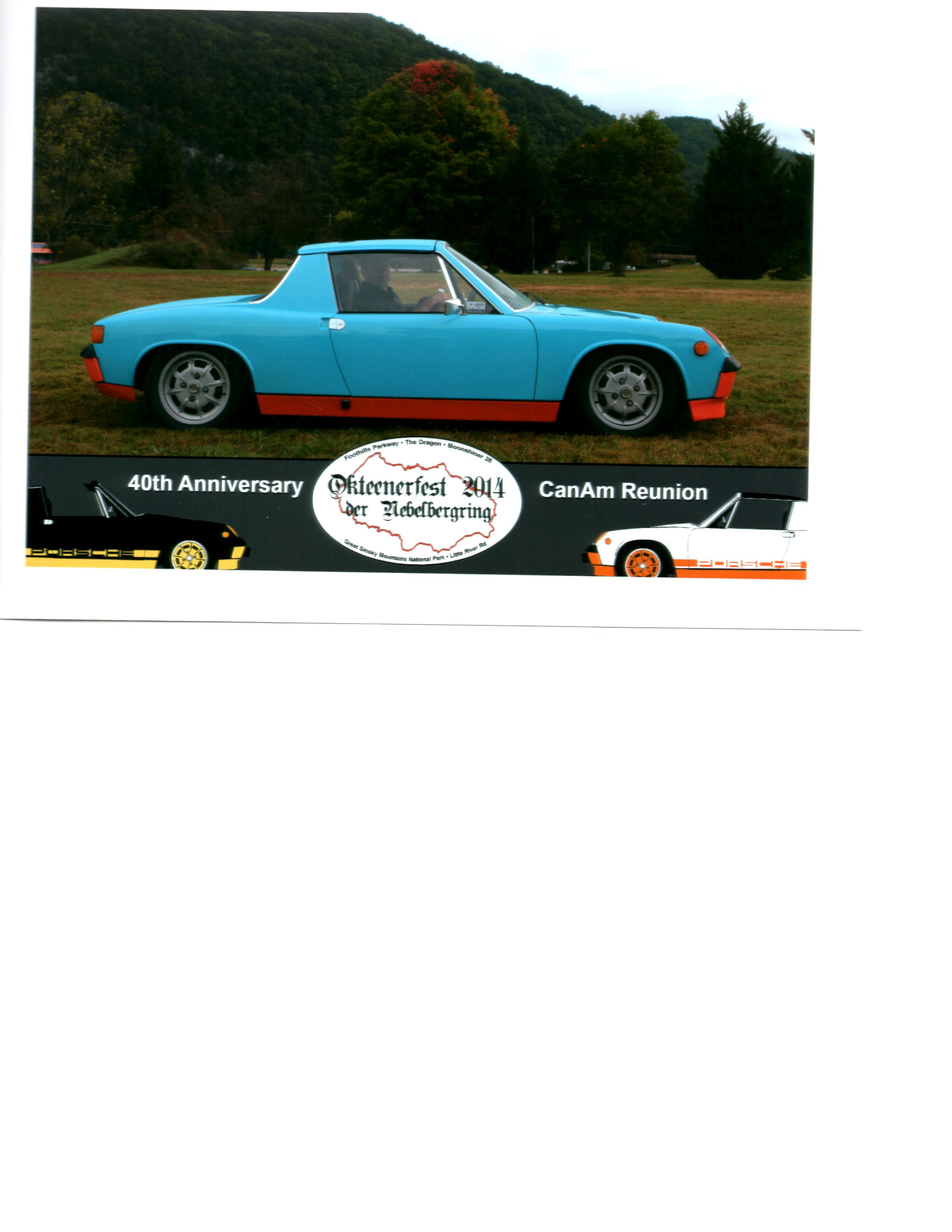

greetings from Georgia, I love my 912E . 2056, Raby cam , HAM heads and 44's. so glad we don't have smog for older cars. That goes for my 914 as well. AL

QUOTE(Al Meredith @ Oct 6 2014, 12:17 PM) *
....I dig the ride Al!
(IMG:style_emoticons/default/first.gif) (IMG:style_emoticons/default/bye1.gif)
