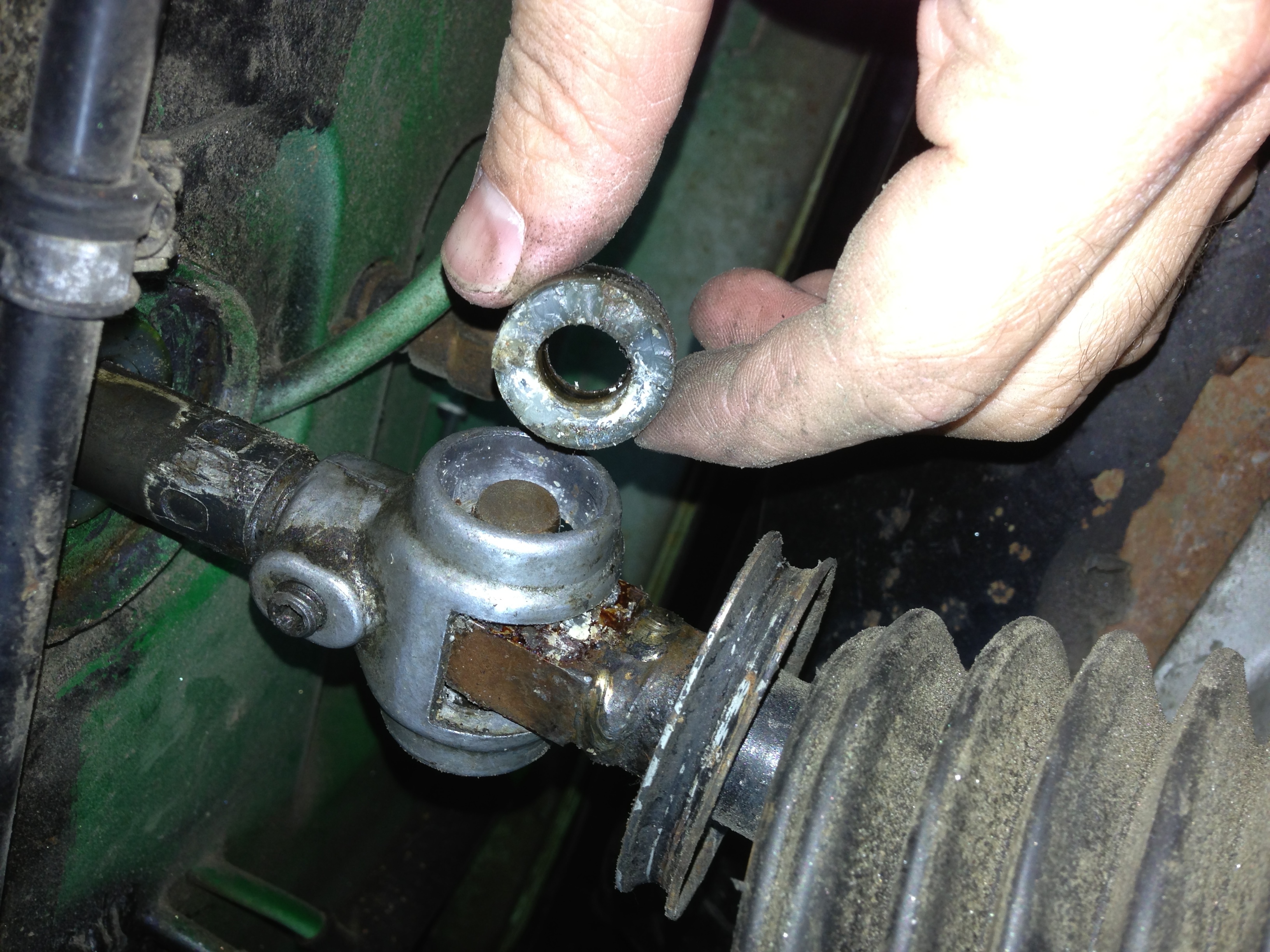

Took the 914 out for an end of the week drive and when I shifted into 4th it went into 2nd, which sounded cool when the engine revved and the tires barked but on the second try (at a lower speed) still 2nd and not 4th. I need 4th. I turned around and headed back to the house and when I was looking for 1st I am pretty sure I found 3rd. I also need 1st. I'm thinking that something in the linkage broke and hopefully this is a problem outside of the transmission. I'm going to dig around tomorrow or maybe later tonight but I just wanted to see if anyone had any educated guess on what the problem might be.

Look for loose or missing cone screws where the linkage attaches at the trans and at the firewall. Also, check conditions of all your bushings!

Yup, start checking the linkage. Especially everything behind the firewall.

That messy that fast you either lost your firewall bushing or coupler bushing or cone screw.

I think this might be part of the problem. (IMG:style_emoticons/default/beerchug.gif)
