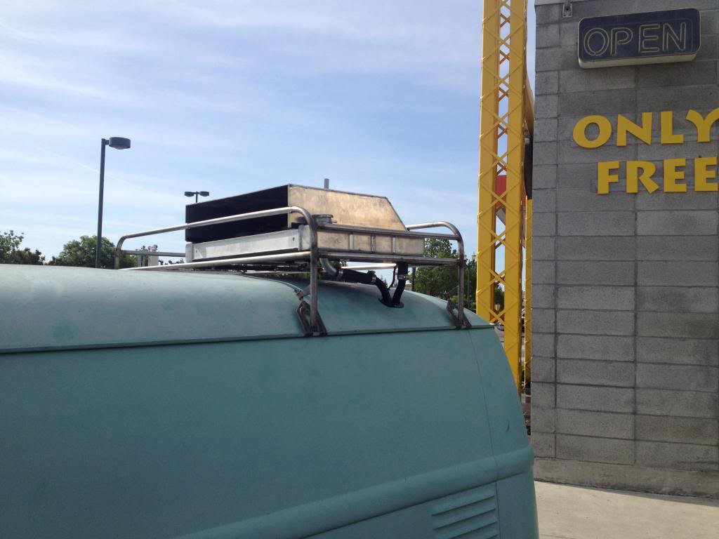

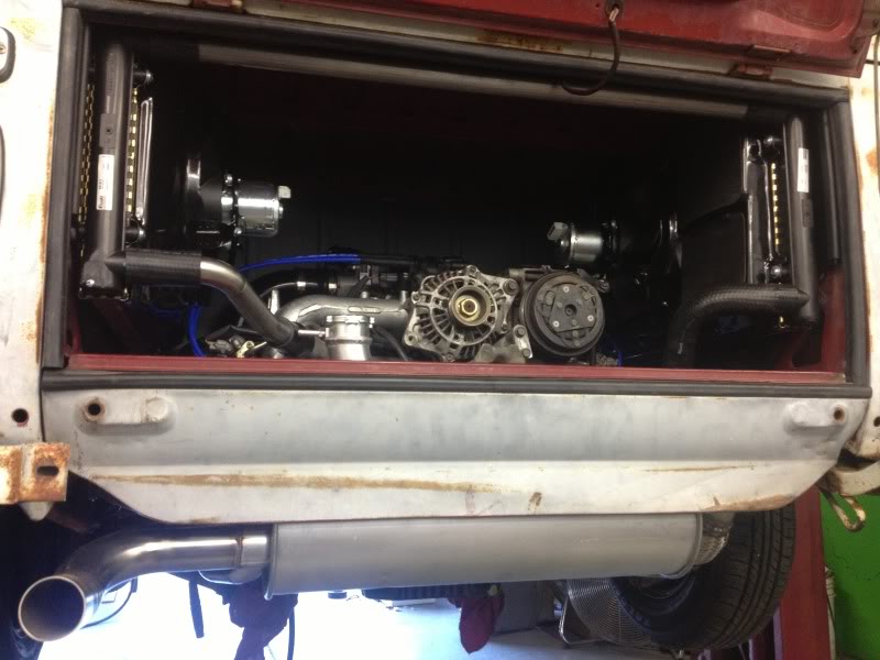

The question was whether a radiator had been successfully used in the 914 engine compartment. I think the answer is still generally not in a 914, with a lot of discussion of theoretical possibilities. It HAS been done in other cars, for example that Laborghini, or closer to home by Toy-Jet, which put their radiator in an LS1 911's whale tale:
(IMG:http://www.914world.com/bbs2/uploads_offsite/i379.photobucket.com-2618-1418073678.1.jpg)
On the more practical side VW bus guys have been out there actively trying lots of different ways to adapt modern engines to their old air-cooled busses. One that was interesting to our discussion was split dual radiators in the engine compartment fed with large scoops on the sides of a bay window bus, augmented by large fans. This worked reasonably well but still tended to heat saturate after extended time on the freeway.
(IMG:http://www.914world.com/bbs2/uploads_offsite/i53.photobucket.com-2618-1418073678.2.jpg)
Another bus had huge fans pulling air into split window's engine bay, proved not nearly enough. Yet another had scoops across the underside of a kombi gave good airflow and worked for a while, but scooped up a lot of dirt and crap that eventually clogged things. Another was roof-mounted like a luggage rack, which sounds a bit like the targa suggestion.
(IMG:http://www.914world.com/bbs2/uploads_offsite/i53.photobucket.com-2618-1418073678.3.jpg)
The owner intends to camouflage that so it looks like a suitcase or a beer cooler, interesting idea but probably not the best look for a 914. This one actually works really well, it's in direct air flow, but not exactly in the engine compartment.
Obviously these aren't 914's, but it's significant that most of those applications are low to medium powered Subaru engines that are relatively efficient and don't need a huge amount of cooling. A higher powered engine would certainly be more difficult. Basically what's relevant is that the practical experiments indicate that it's really difficult to cool without having access to direct air flow. That means I wouldn't be optimistic about it working in a 914's engine compartment either, but hey, if you think you have a good idea, go for it.

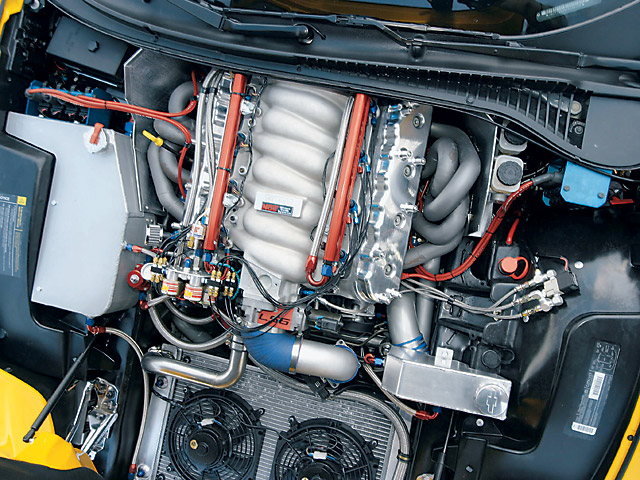

I would love for the radiator to work in the engine compartment but logic says no. Heat from engine and little airflow work against it. Do you know of any production mid or rear engine car that makes it work- I dont. Again, I'm on your side. If I didn't feel it absolutely neccesary to mount the oil cooler on my gt build or the rad on my suby build up front, I wouldn't.
Ferrari Testarossa.
post Dec 9 2014, 05:32 AM
Post #52
914-6 GT in waiting
Posts: 20,587
Joined: 19-September 09
Member No.: 10,825
QUOTE(bulitt @ Dec 9 2014, 03:28 AM) *
QUOTE(mepstein @ Dec 5 2014, 08:45 PM) *
Ferrari Testarossa.
I stand corrected. But we are still fighting an uphill battle to make a mid mounted radiator work in a 914 compared to a car that was designed that way.

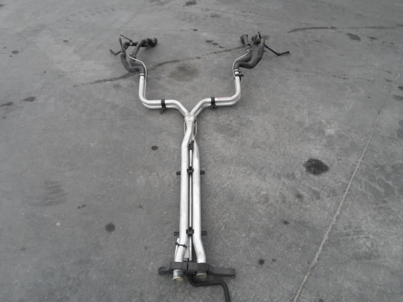

I had a radiator built to lay flat in the front trunk on my first conversion. It worked great and gave me back some of the trunk space. Con: the air outlet was straight down and would blow dirt around and add unwanted air under the car.
people keep stating cars like Ferrari and Lamborghini as successful engine bay radiators. Keep in mind these cars were engineered for this. Body panels and air flow direct the heat away. $$$$ have been spent in R&D.
The 914 engine bay has horrible air flow. It was not designed to force air through the tins. The fan forces air through the tins. flaps below help to create turbulent air for the fan to force through the tins.
I think if Porsche thought engine bay radiators were practical, they would have used this method on the 911 and Boxster.
There looks to be just enough room under the 914 headlight bucket to use a pair of Boxster radiators. I am going this route at some point. I may also use the center rad with a matching size oil cooler too. I would love to have a front trunk again.
The design would be to raise the center tunnel, creating a raised void under the car to route the Boxster coolant lines. Oil lines and fuel lines could be routed here as well. A cover would be fabricated like a belly pan to enclose the void. Getting past the front suspension with the Boxster hard tubes look like the biggest difficulty.

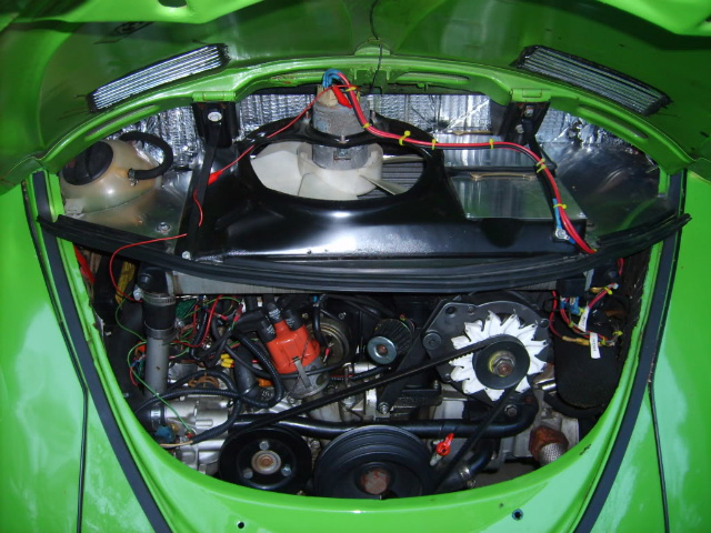

Unfortunately a lot of rear-mount cooling projects in all kinds of different cars get started and then either don't work or the threads peter out and disappear. I'd assume that to mean they didn't work out either. Scott's gone too, but does anyone know what happened to his car? I think his is the only I've heard of that was reported to work well. I don't remember seeing any photos, though, does anyone have a link?
Not the same, but there are these vasserboxers in VW's:
(IMG:http://www.914world.com/bbs2/uploads_offsite/images.thesamba.com-2618-1421686704.1.jpg)
(IMG:http://www.914world.com/bbs2/uploads_offsite/i33.photobucket.com-2618-1421686705.2.jpg)
Both said to work, both bring air in over the transmission through a big cutout in the firewall in front of the engine. Even so the consensus in the VW community (shoptalkforums.com, Conversion Perversions and thesamba.com) seems to be the same as here, that front mounted is foolproof, rear remains unproven.
