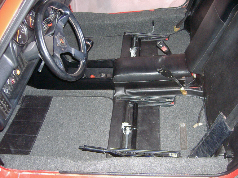

AvalonFal
post Dec 13 2014, 06:24 PM
Posts: 487
Joined: 3-July 05
From: Southern New Jersey Coast
Member No.: 4,367
Before trim installed.

QUOTE(AvalonFal @ Dec 13 2014, 07:24 PM) *
Looks good. Did you use two sided tape to install the carpet around the emergency brake lever? And where i curves in the footwells? It seems like those would be hard places to get it to stick. Unless that is amazing tape.
I considered gluing it in areas like that. But, using tape where the carpet comes down to the corner of the inner long and the floor. Then the carpet could be lifted up and those areas cleaned and inspected periodically, to prevent moister and rust there.
