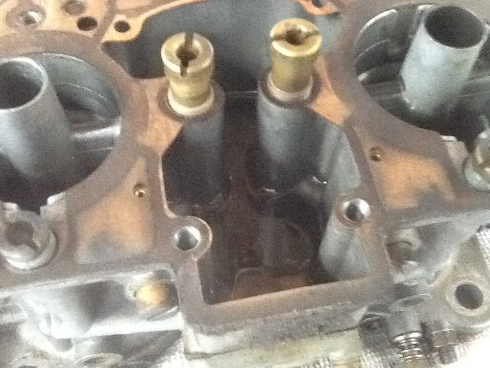

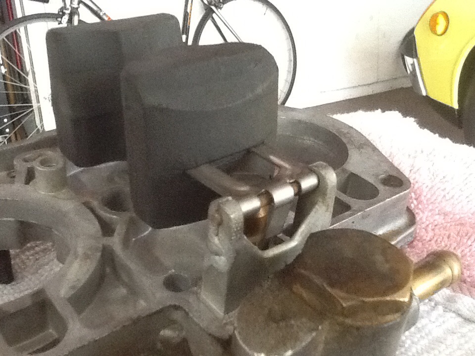

The car was running fine. Then last week, it started to pop and backfire on the freeway at 70 in 5th. It did fine in 4th at 70. Later in the day going up a grade at 70, it started to backfire real bad and lost power. I pulled over and it wouldn't idle. It was hard to start and then died. Investigation found fuel on the air cleaner cover on the passenger side carb.
Is this an indication that this float is bad? Is there a way to test the float vs. the valve?
Does this look like too much fuel in the bowl?

I had the exact same issues a couple months ago with my carbs. It turned out that the idle circuit was plugged. Tomlinson's book suggest pulling the idle jets and the idle adjustment screws and then blowing compressed air through to clear the blockage. It worked for me.
You should certainly check your float adjustments and be sure the check valve in the bottom of the bowl is working correctly while you have everything apart.
One of the floats could have gotten stuck as well - especially if they are out of adjustment. Be sure they move freely up and down in bowl and aren't hanging up on the side.
Fuel level in the bowl is set by the floats - do you have the adjustment spec's?
Good luck!

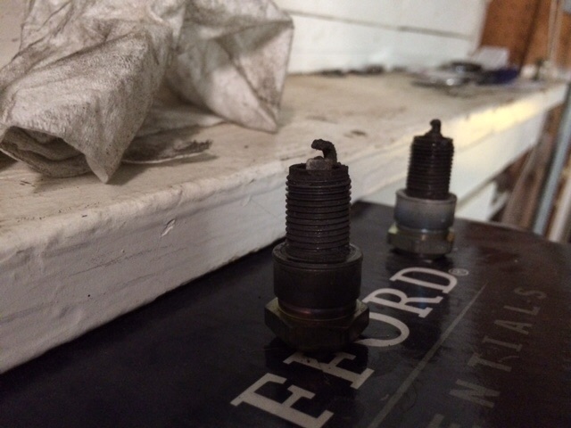

I finally had a chance to start working though this today. I started with a valve adjustment. I pulled the plugs to make it easier and found this: Attached Image
The center electrode on 4 was burnt away. The body is discollored like from heat. There was carbon connecting the electrodes on 3. 1 and 2 looked perfect.

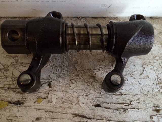

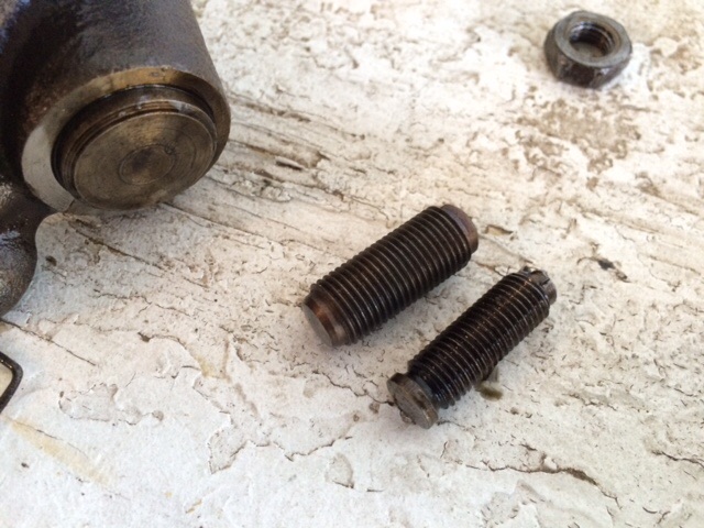

Adjusting the valves, I again found that even completely loose, the valves on 3 and 4 were barely in spec (.006 intake and .008 exhaust). I thought maybe the adjusters are worn, so I pulled off the rockers. They don't look bad: Attached Image
I have some new adjusters I ordered from the Bird. The say they are for 2.0, but are much larger than what I have. What gives? Attached Image
Also, when I put it back together I found that the nuts on the outside studs were not the correct thread. It didn't torque correctly until I replacedwith the correct size.

The larger lugs are correct for a 73+ motor. Looks like someone replaced your rocker arms with the earlier ones, and used elephant's foot adjusters. I'm not sure if those are genuine 911 adjusters; hopefully they are. Those are the best quality but unfortunately they are expensive.
Has any machining been done to the valve side of the rocker arm? The face of the hole that faces the valve stem needs to be machined a bit to make for clearance when using the 911 swivel-foot adjusters.
--DD

Those aren't swivels. There are two styles of the M8 rockers. That is just one of the stock styles.
Roger, while the rockers were off, you should put a straight edge across the valves. If one or more of them is higher or lower than the rest you have valve seat problems.

Popping is usually due to lack of fuel. A lean condition could explain the burnt away electrode as well. Your carb may be plugged.

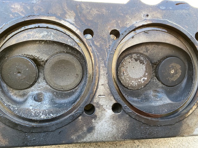

It’s been 5 years. But I finally got to drop the engine and remove the head.
Pretty ugly.
Repairable, or should I be looking for some new heads?
What causes this? Want to make sure it doesn’t happen again.
Thanks
