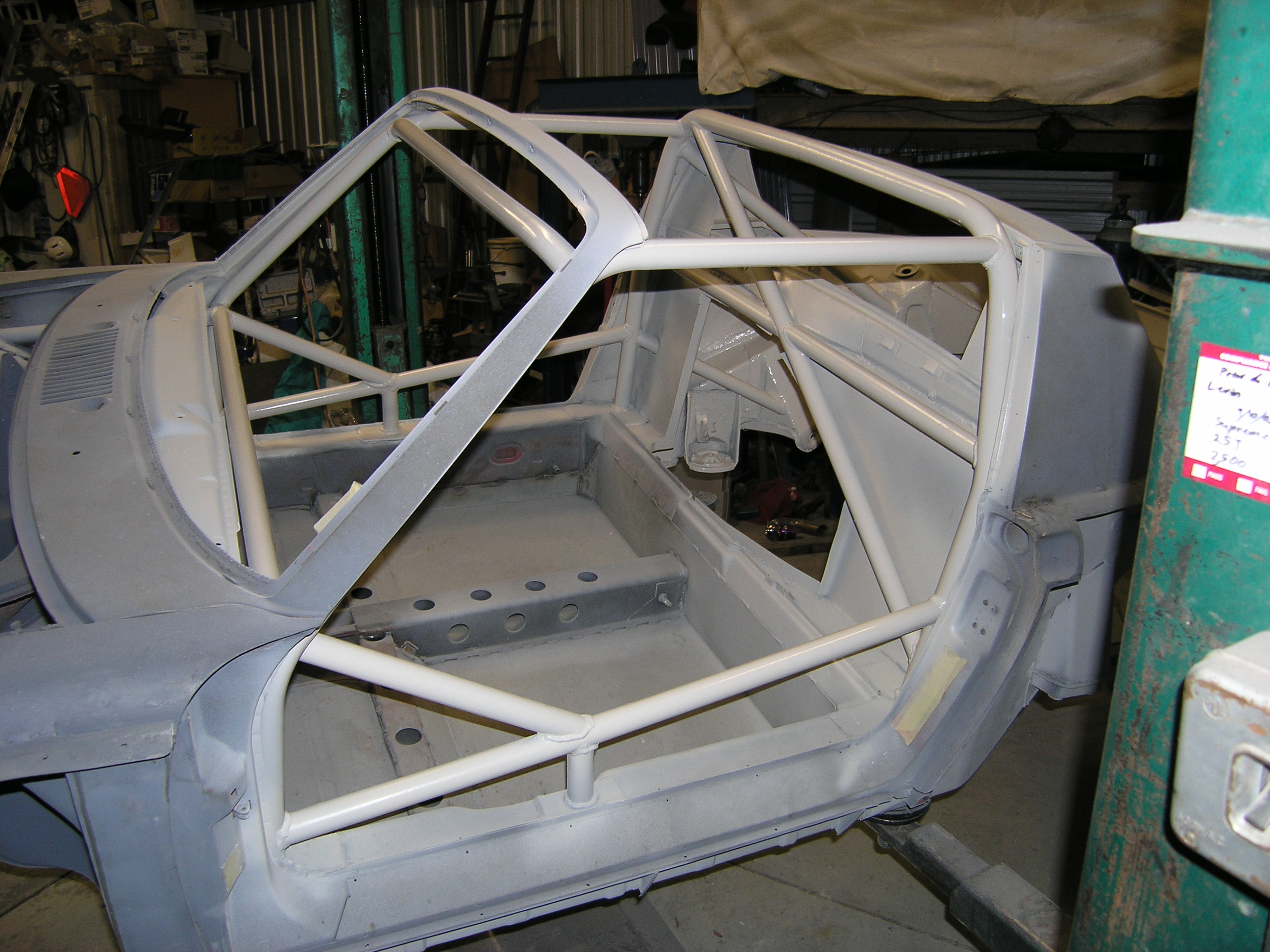

What have you done to stiffen the chassis?From new the car was noted by many testers as a flexiflyer.
The loads are now greater and the original floorpan allows the front and rear to flex relative to each other in a larger magnitude.
As a racer,no doubt you have installed a rollbar that may have firmed the torsional resistance to some degree.
The measurement of the torque needed to deflect the spring perches is a good first step.
Loosy-goosy will have the 914 squirming around the track and exhibiting the bad habits many here have experienced too.
How stiff?Enough to have control and no more.Then you can win.

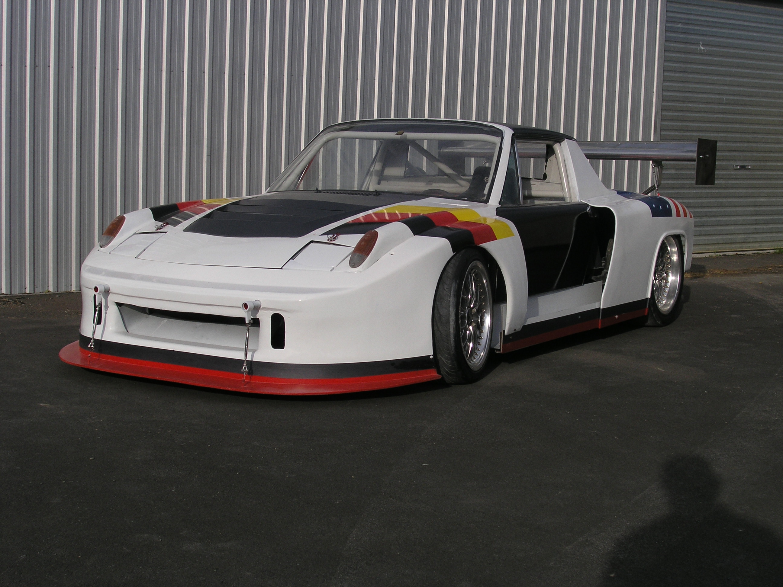

OK. the car is widebody, but will now be slightly narrower at the front after yesterdays modification.It runs a turbocharged LS1 /subaru 6 speed combo. 18x10.5 rears and 18x9.5 front with slicks
it has a full cage, front tower to rear tower and strengthened trailing arms ect. ARBs front and rear fully adjustable

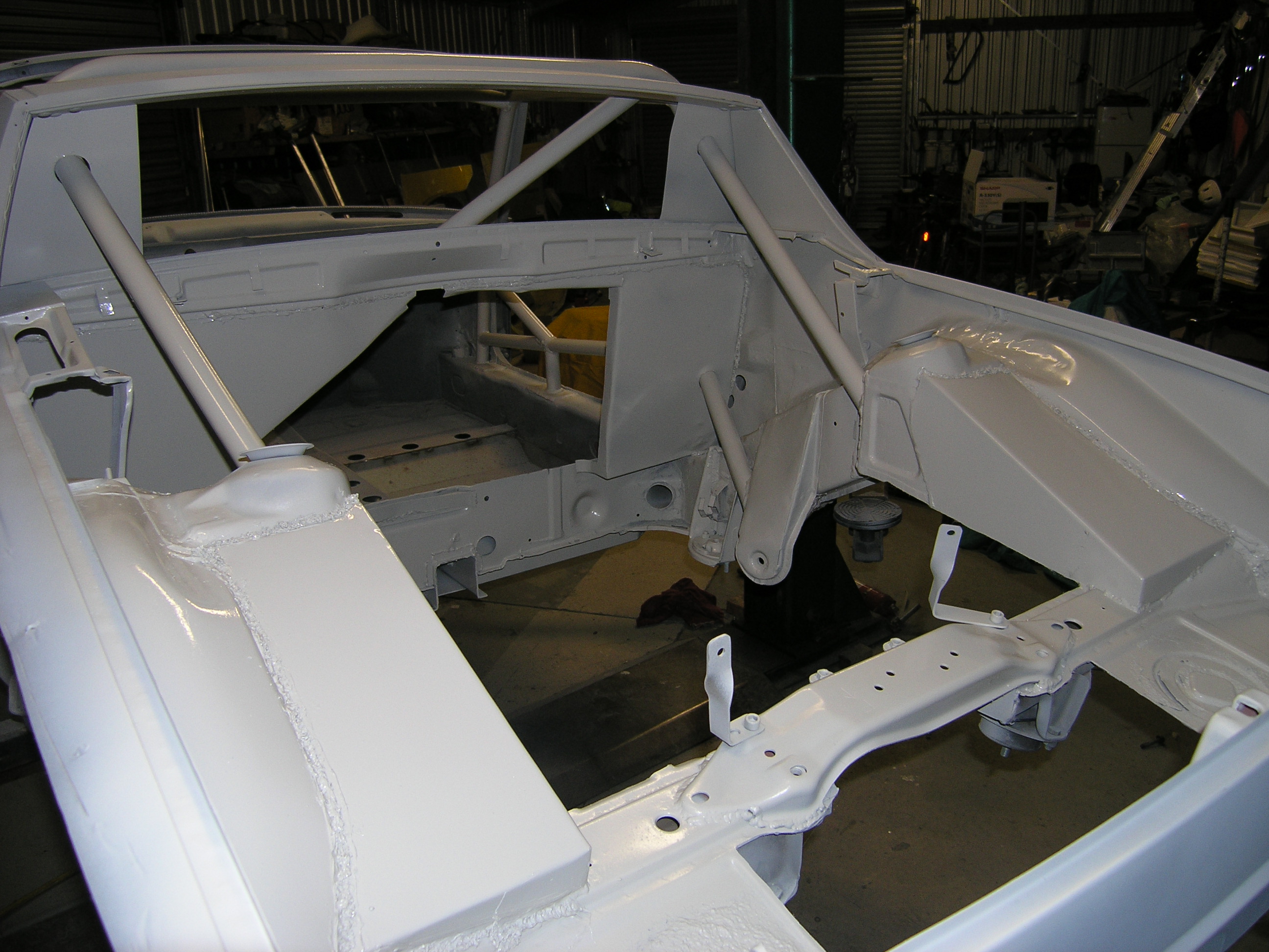

Triangulated DOM tube cage that ties into the spring perches and trailing arm pivot.
The bottom of the cage is tied into the longs with rectangular feet to spread the load to the sheetmetal.
It appears that the inner longs have been doubled with braked sheetmetal angle to add stiffness.
Transverse tubes tie the front of the cage at the top and bottom windscreen height.
I assume the cage was tested for torsional stiffness prior to installation.
I am seeing a single tube running forward from the cage.
https://www.google.ca/search?q=full+race+ro...ved=0CAYQ_AUoAQ
A look at the trailing arms should reveal a heavily modified pivot tube and box section,tho the inner console appears to have no doublers.

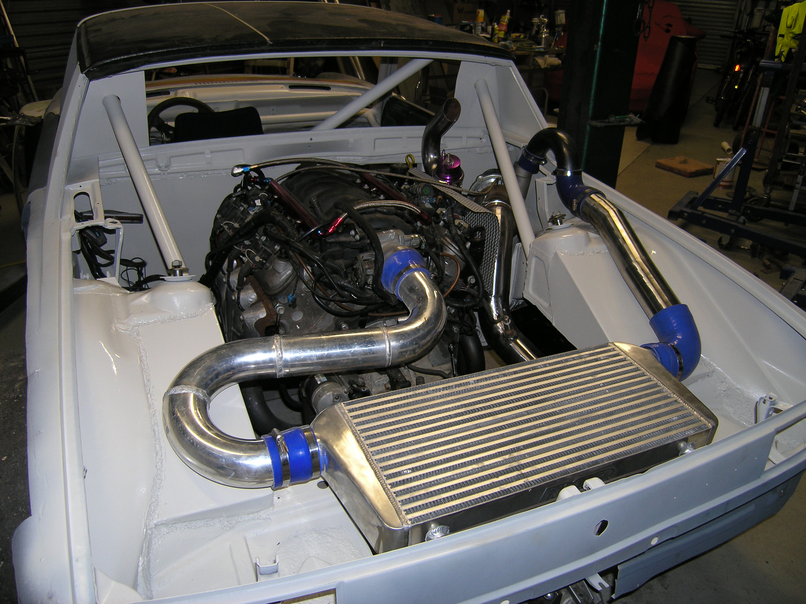

The turbomotor is an impressive V8.Inconel exhaust valves?What pressure is it limited to?I am liking it,have you drysumped it with a wide pan?
https://www.google.ca/search?q=drysump+oil+...ved=0CAYQ_AUoAQ

Add 30mm more rear tire to the outside to fix the track width problem.

Based on the offset of the front wheels, you have spacers thus increased scrub radius. This will affect handling quite a bit. Try to remove or reduce the spacers in the front and hit the track again.

Veekry9;The inner console does have doublers as well as the outer console and the shock towers.

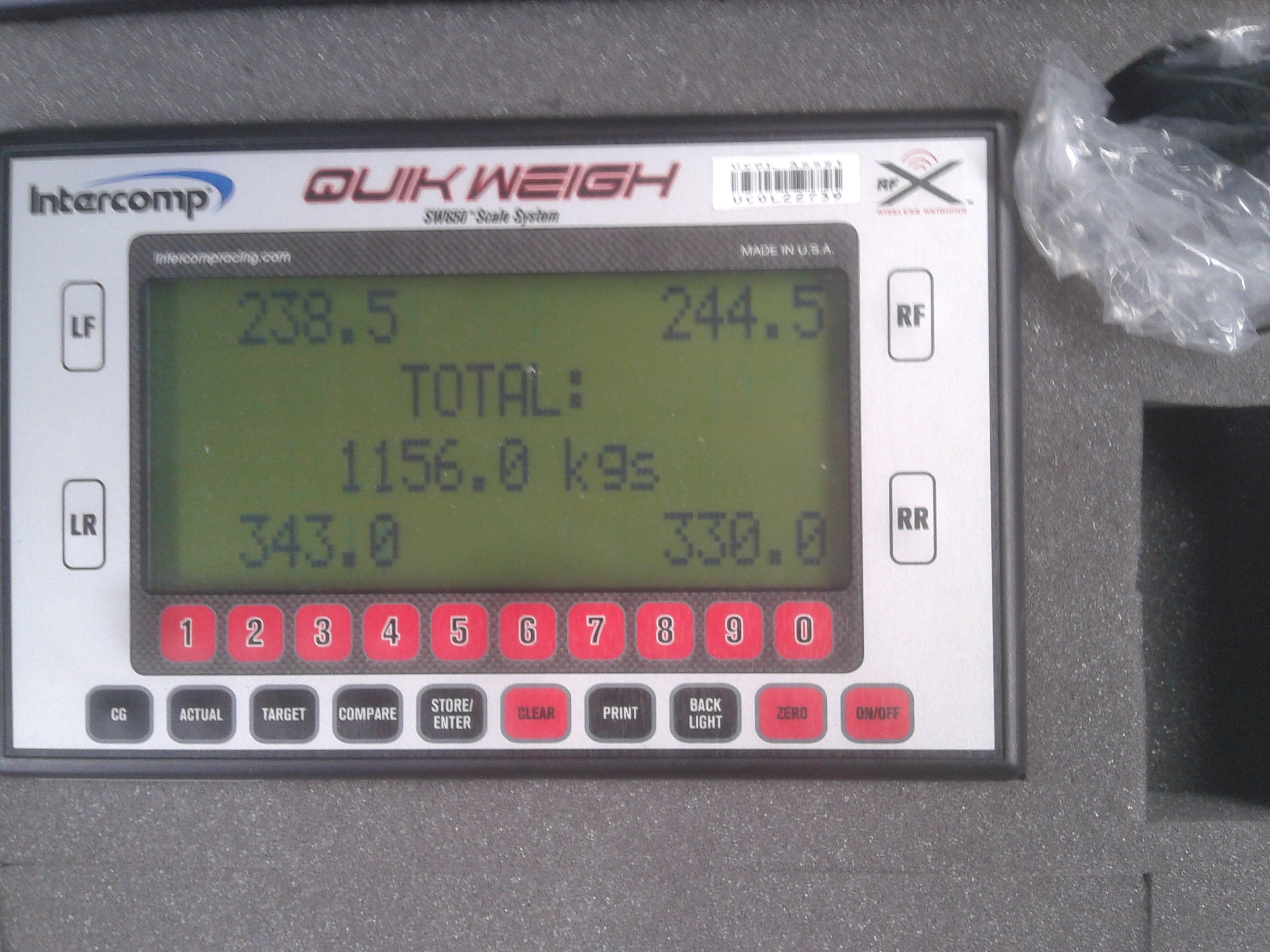

Did you have the car corner balanced?
returf
post Jan 11 2015, 12:51 PM
Posts: 67
Joined: 15-August 12
From: New Zealand
Member No.: 14,806
Region Association: Australia and New Zealand
QUOTE(Mike Bellis @ Jan 12 2015, 07:14 AM) *
Just roughly Mike
