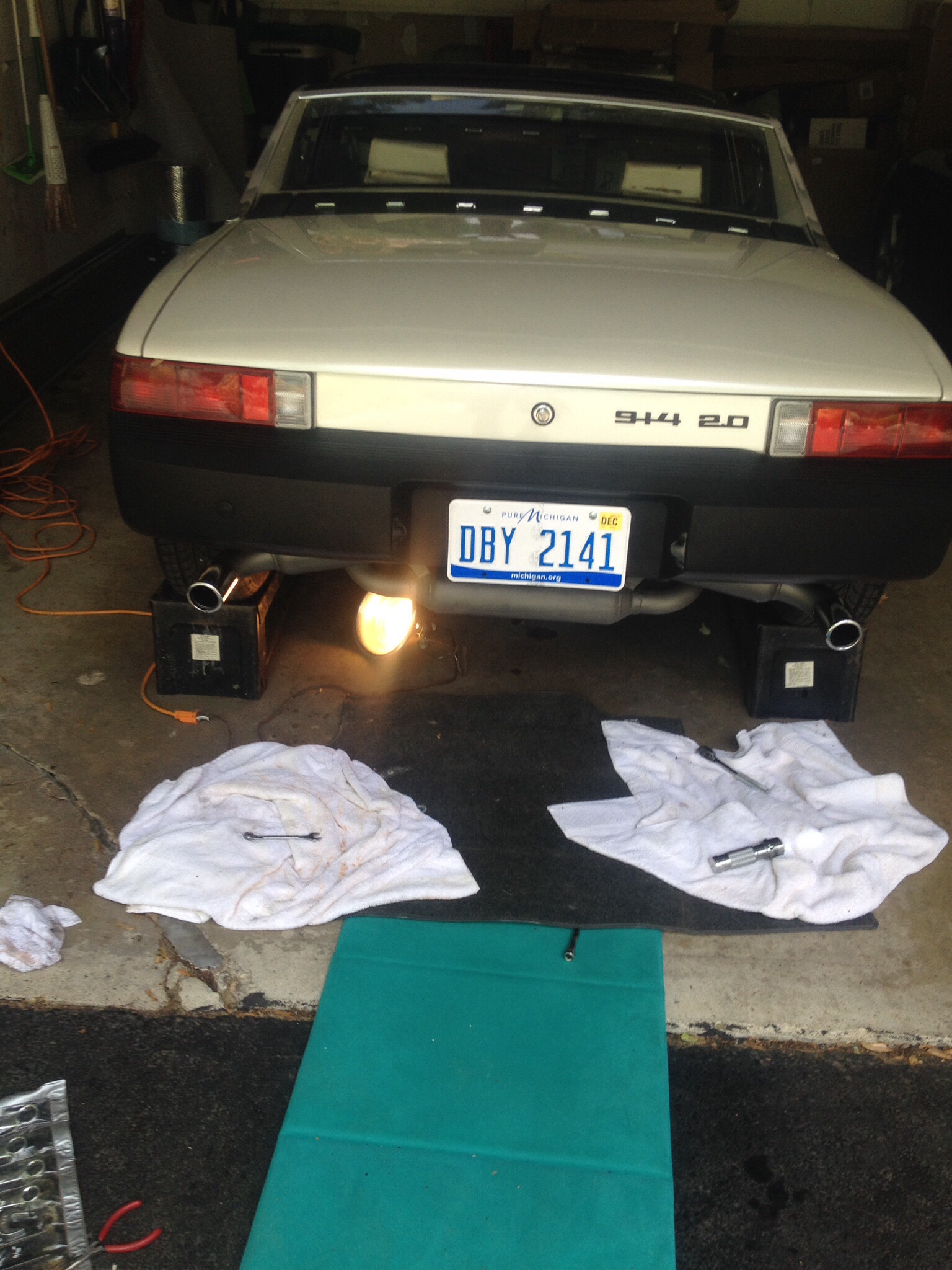

I put a Triad dual exhaust on my '75 2.0 and I love it. Definitely a deeper throaty sound but I've received nothing but compliments on it where ever I take it. And Dave at Triad was top class to deal with. I would recommend his service to anyone. Attached Image
