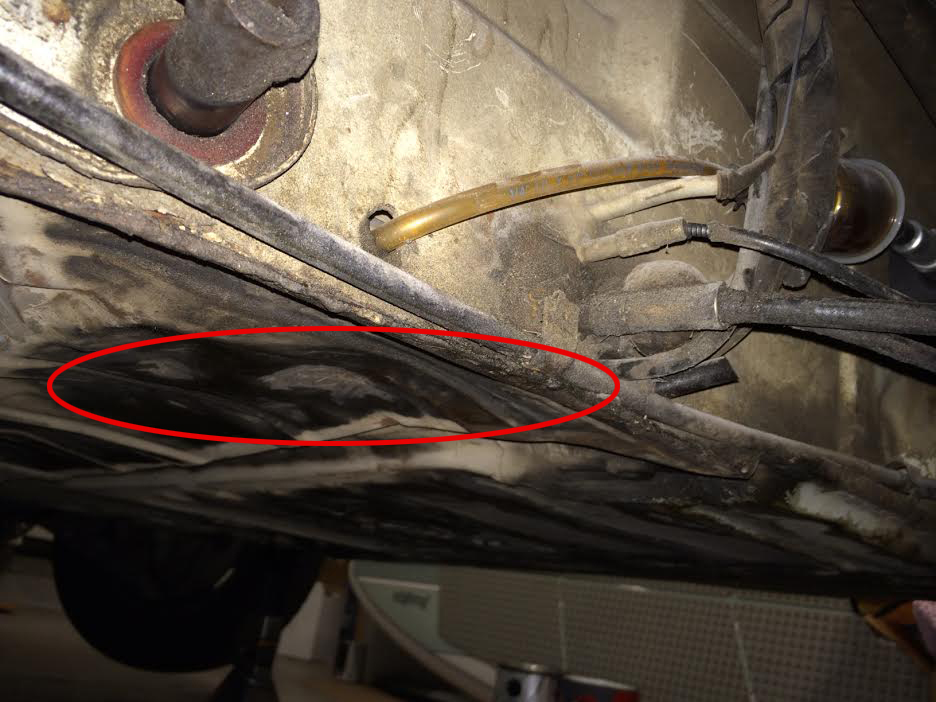

So, on my 1970 1.7 which has a dual 44 webber carb set up, I had some fuel line issues at the DE/TT at Chuckwalla Raceway that I was at a couple weeks ago. It was running well all weekend, then we noticed on the end of the first day, and part of the second day it would start to sputter on last portion of the lap, which is a 2.6 mile lap with long sweeping turns.
This being the first time I have driven it this hard for a prolong period (staying in the higher RPMs for 15 to 20 mim), at first I was thinking the fuel pump, which came with the car, might not be able to keep up with the demand. Then my instructor suggested that maybe the gas tank was getting low and the fuel was sloshing to one side or the other. This made sense until I refilled the tank and the same issue came around again. on the 3rd round someone that was behind me mentioned that it looked like something was dripping and smelt like gas behind me.
I got under and noticed that my inline fuel filter was shot. I should have changed it before I left, but it didn't even dawn on me since it was my first track experience. I also notice that it looked like fuel was leaking at what looks to be under where the portion of the "tunnel" would be between the driver and passenger. So, my thought was the line had cracked near or before the fire wall and so obviously I parked it for the day and that was the end of the weekend.

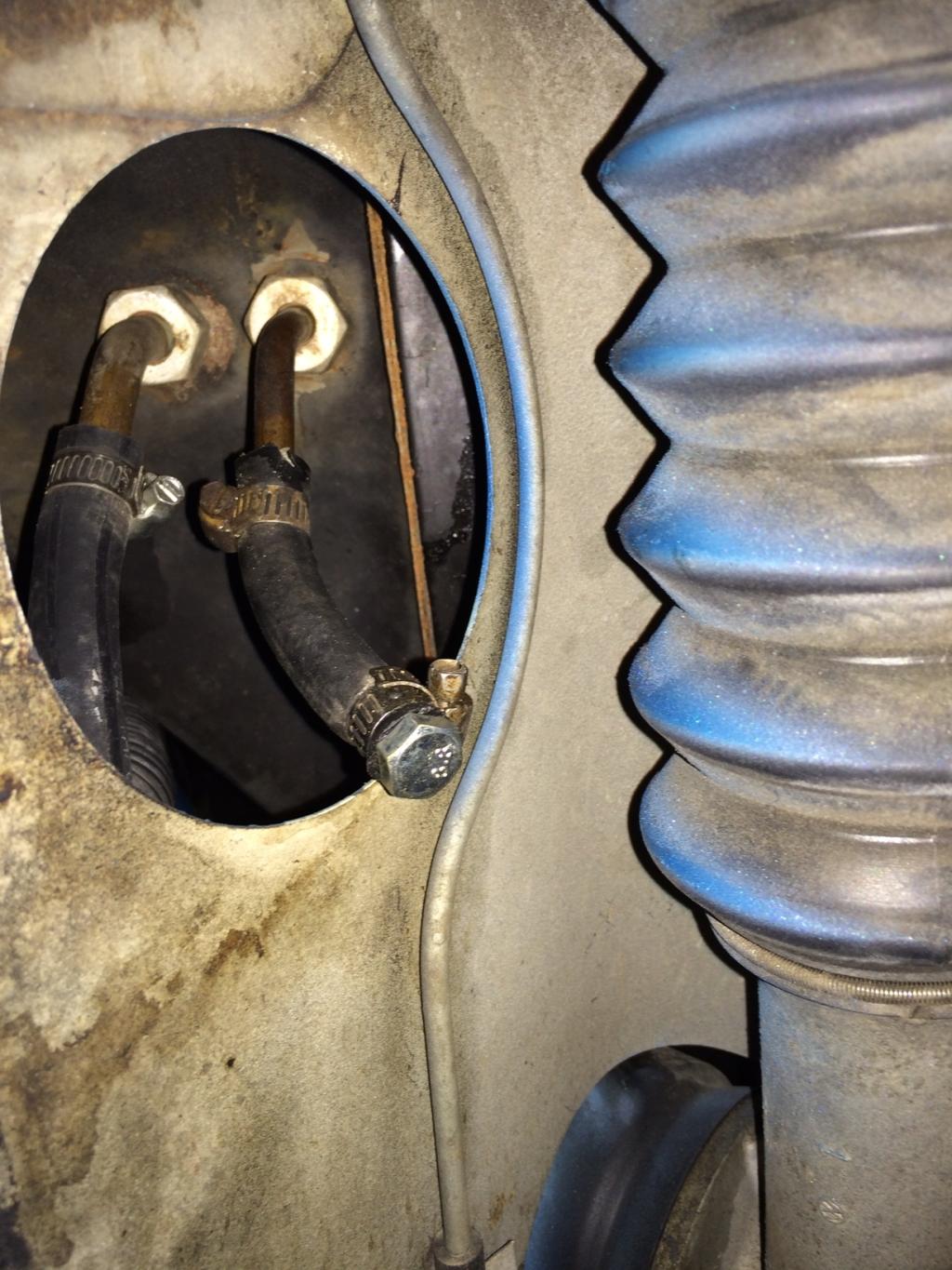

Out of the tank, one line plugged, one connects to the plastic line.

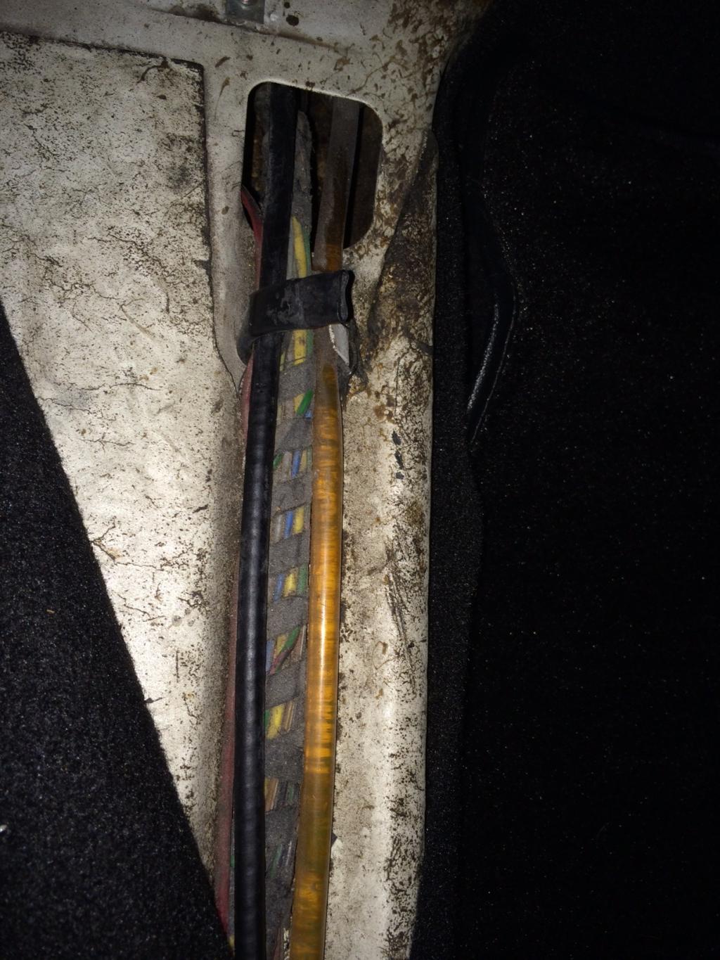

Plastic line comes into the car and front portion of the tunnel.
(IMG:http://www.914world.com/bbs2/uploads_offsite/i187.photobucket.com-14487-1422853643.2.jpeg)
(IMG:http://www.914world.com/bbs2/uploads_offsite/i187.photobucket.com-14487-1422853643.3.jpeg)

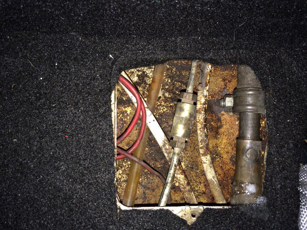

The fuel line in the back hole between the seats.
(IMG:http://www.914world.com/bbs2/uploads_offsite/i187.photobucket.com-14487-1422853643.4.jpeg)

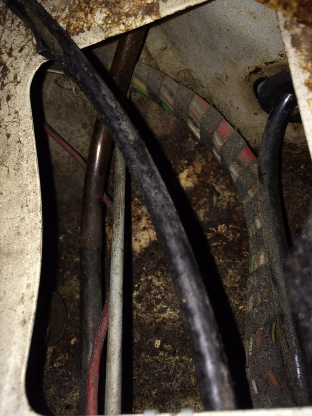

Line out the back of the fire wall: (Rubber grommet seemed to be missing, likely the cause of the leak) Should have checked it before I left or duing the weekend, I know. (IMG:style_emoticons/default/headbang.gif)
(IMG:http://www.914world.com/bbs2/uploads_offsite/i187.photobucket.com-14487-1422853643.5.jpeg)

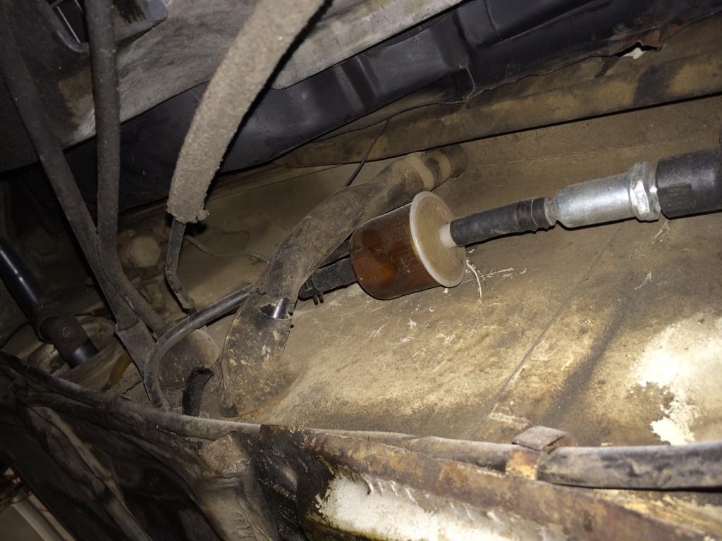

The filter:
(IMG:http://www.914world.com/bbs2/uploads_offsite/i187.photobucket.com-14487-1422853644.6.jpeg)

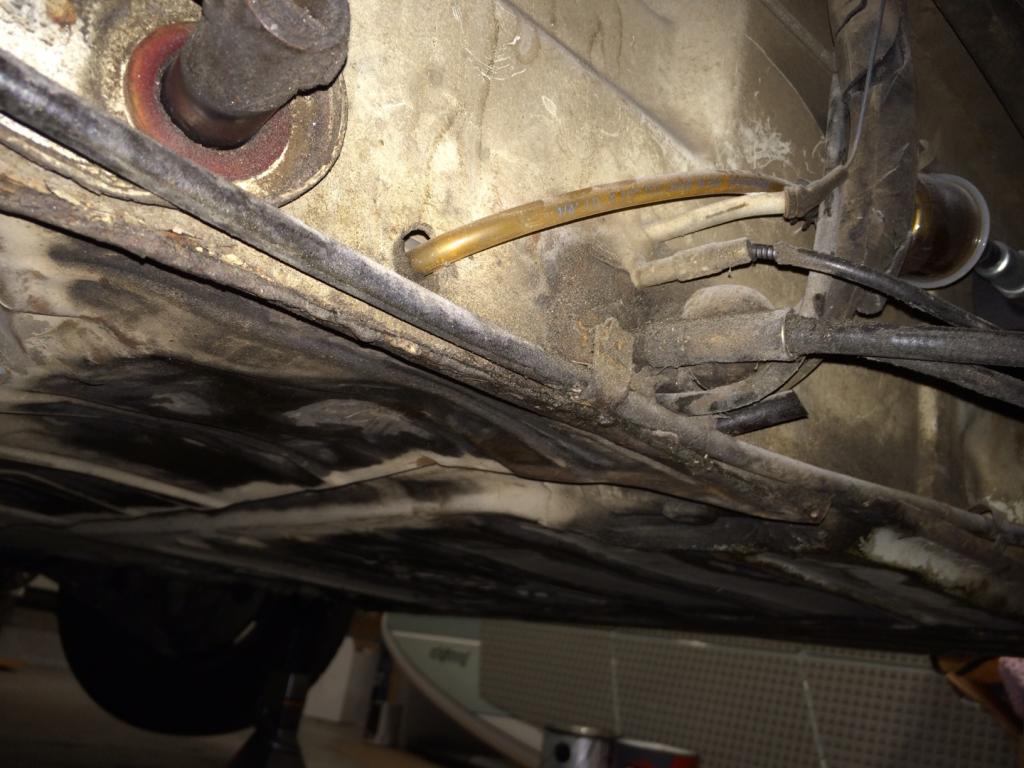

Area that was all wet with fuel at the track, circled in red. It did not feel wet in the car.
(IMG:http://www.914world.com/bbs2/uploads_offsite/i187.photobucket.com-14487-1422853644.7.jpg)

That looks like an original plastic line except the factory routed it entirely inside the tunnel, it shouldn't be up with the wiring harness. Get a 3/8 stainless line in the tunnel before you have a fire.

For my carb setup, I removed the stock lines and replaced it with a single 3/8" Steel brake line from the FLAPS.
(straight run, no bends required, but the engine was out to install the line)
Each end has a flared end adapter that takes me to 6AN.
I have a holley Red pump up front with the fuel cell, and the holley pressure regulator with gauge in the engine compartment.

Either replace the line with the SS brake line, or just get it from Racer Chris and be done with it. Definitely put a grommet around that hole.
If you think you might want to go back to FI at some point, consider getting the setup with two SS lines (direct stock replacement), one for supply and one for return.
Note that the new lines might not solve your sputtering. There could be other issues as well--but obviously fuel leaks need to be addressed first anyway.

Yes. I did it. I did not find it particularly difficult, although you do need to remove the tank (of course).

Here is video that was very helpful to me. I installed lines with engine in. I did take the right rear wheel off to improve angle to insert the fuel line.
