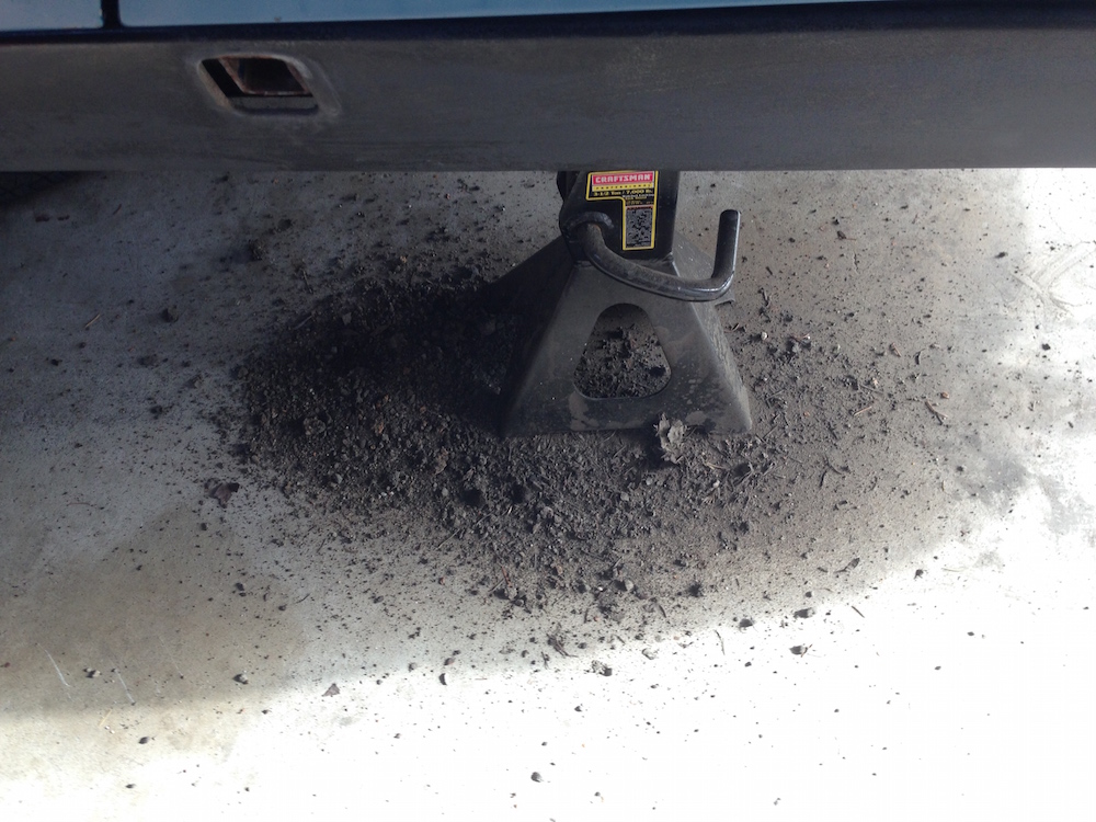

Got it! The combination of heat from a little butane torch, tapping with a hammer and careful use of vice grips did the trick.
And the best part was seeing that there's no serious rust issues in the long and jack stand areas.
Thanks again for all the advice.Attached Image
