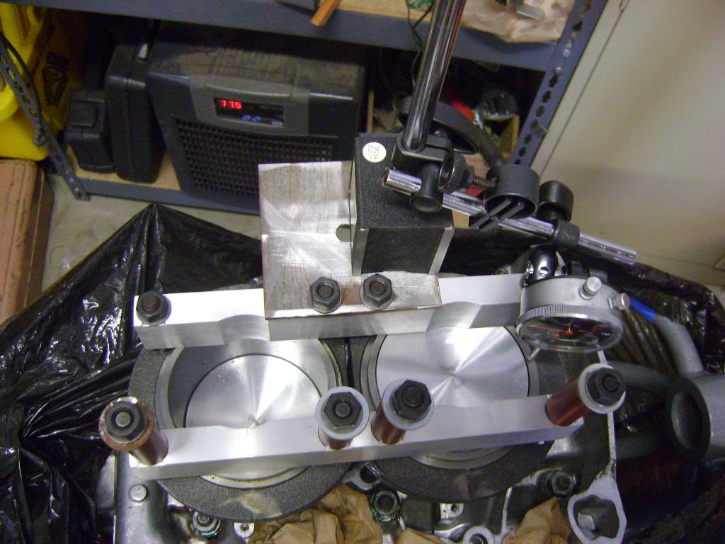

How are you holding the cylinder down?
I have a tool made by a member on this forum cant remember who...
Here is a pic:
(IMG:http://www.914world.com/bbs2/uploads_offsite/i366.photobucket.com-10819-1424307439.1.jpg)
You want to measure on both sides of the piston above the wrist pin.
Measure numerous times and rock the piston in the cyl.
If you are directly above the wrist pin, the meas wont change much as you rock it.
How are you measuring? with the "shim method"?
Or the "solder method"?
Or with a dial indicator like in my pic?

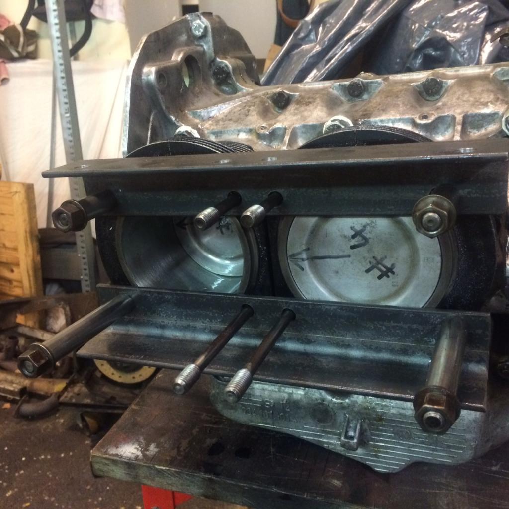

The case has not been machined, I have installed new rod bearings and crank bearings. I am holding down the cylinder with 2 steel plate on each side, similar to the pic Stugrays posted. I am using a feeler gauge to measure the deck height and a dial to get to top dead.
I will post some pics of the arrangement within the next few days.

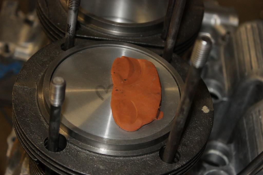

The question regarding the valves hitting the piston has to do with your cam selection and IF you have oversized valves.
IF you are running a stock cam and stock valves, then .035 - .040 deck height would be fine.
This can be checked with the "clay method" once you have the base shims installed and the valve train geometry adjusted (if required).
This pic shows my valve clearance, and I got a secondary check of my deck hegit for free (look on lower right side of clay)
