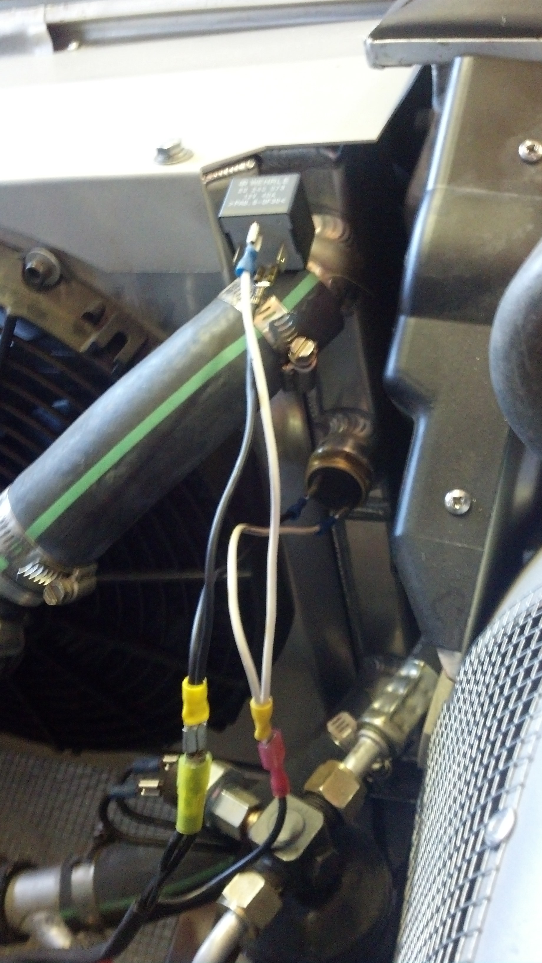

Thanks so much once again guys. Sometimes electrical has me scared to death. I sure as heck respect it that's for sure. Here's a pic.... The ground and source are not plugged in yet when this was taken but it's working perfectly. I taped up all the bare surfaces and mounted.
Woooooo Woooooo now onto the A/C which has been a bummer. Had to learn the hard way that because I have no belt fan that's always on when the engine is, well, the damn AC would never cool the high side correctly and the unit was whacked out of it's mind. Only really need to worry about that though testing and filling in my garage OR I guess in severe traffic so it's a good thing that I did this.
DaveAttached Image
