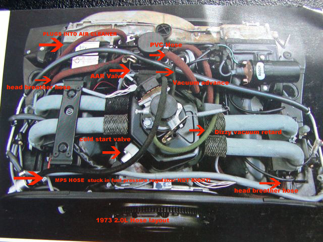

Here is the 73 hose layout...........

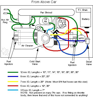

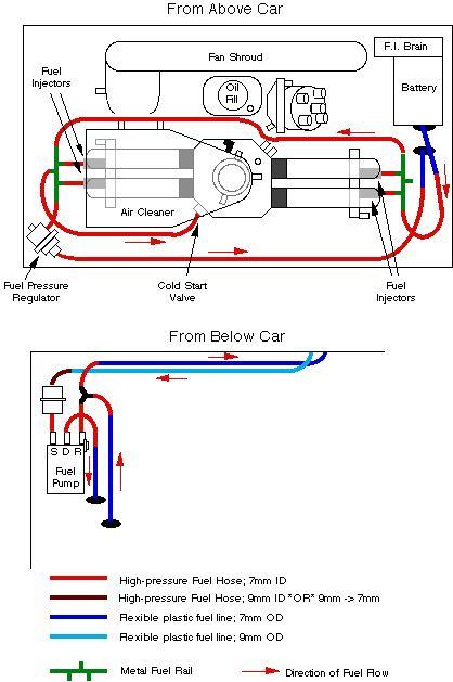

and if it'd not a 2.0...
d7n7master
post Sep 2 2004, 09:27 PM
Gary#
Posts: 663
Joined: 13-March 03
From: The O.C, Ca.
Member No.: 421
Damn - that didn't work. Okay, browse... what? (IMG:style_emoticons/default/type.gif)
d7n7master
post Sep 2 2004, 09:29 PM
Gary#
Posts: 663
Joined: 13-March 03
From: The O.C, Ca.
Member No.: 421
One more.

The ends shouldn't be rock hard if thats what you mean. There should be some resistance when you push them on snugly. The only ones that are critical are the one to the AAR valve, the MPS and the if you have it to the PCV valve to the air cleaner.
