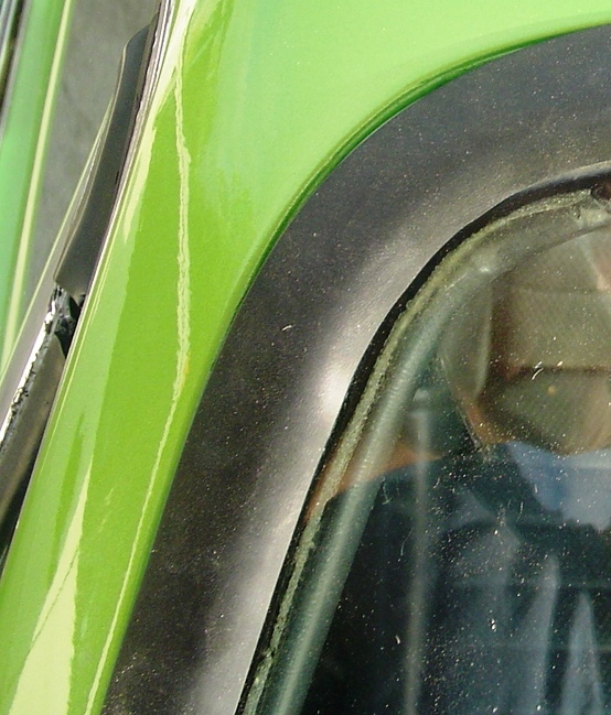

Here is an image from 914rubber that shows the look I want...
(IMG:http://www.914world.com/bbs2/uploads_offsite/shop.914rubber.com-11163-1329931004.1.jpg)
I guess my question is "Is this rubber replacement for the chrome trim an actual 'seal' or just a trim piece that's added ALONG WITH the seal referred to earlier?"
Bob

It doesn't seal. Just ornamental.

I would call it a seal, it keeps water out, it has a bead of butyl around the onside track that bonds to the glass. It is then set into the opening using windshield eurathane, so the windshield must be out.
While the OEM trim is cosmetic, this is what I would consider a structural application.
