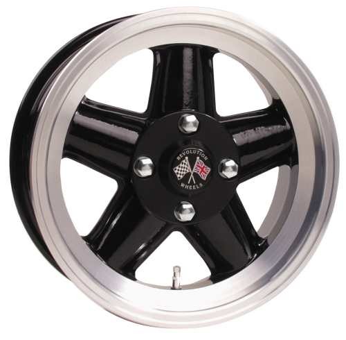

Is this the wheel you mean?
(IMG:http://www.highway914.net/tech/914wheels/revol-rfx.jpg) If so, it's the Revolution RFX. Auto Atlanta sells them as "AFX". I don't know about sizes or offsets. -Rusty |

You can get them in practically any offset you'd like
They even have 'em as 3-piece and you can select your the outer rims to the size you want. And for 3-piece wheels, they're pretty affordable cheers, Jeroen |

Alot of guys in our area run them as track wheels.. and the offset is close to a factory 7inch R fuchs.. I can't remember but something like 37m...
anyways. Yes you can often get them under stock body and often with 225/low profile tires... There pretty nice, but not the lightest wheel out there... Probably the best "off the shelf" 4bolt option brant |
