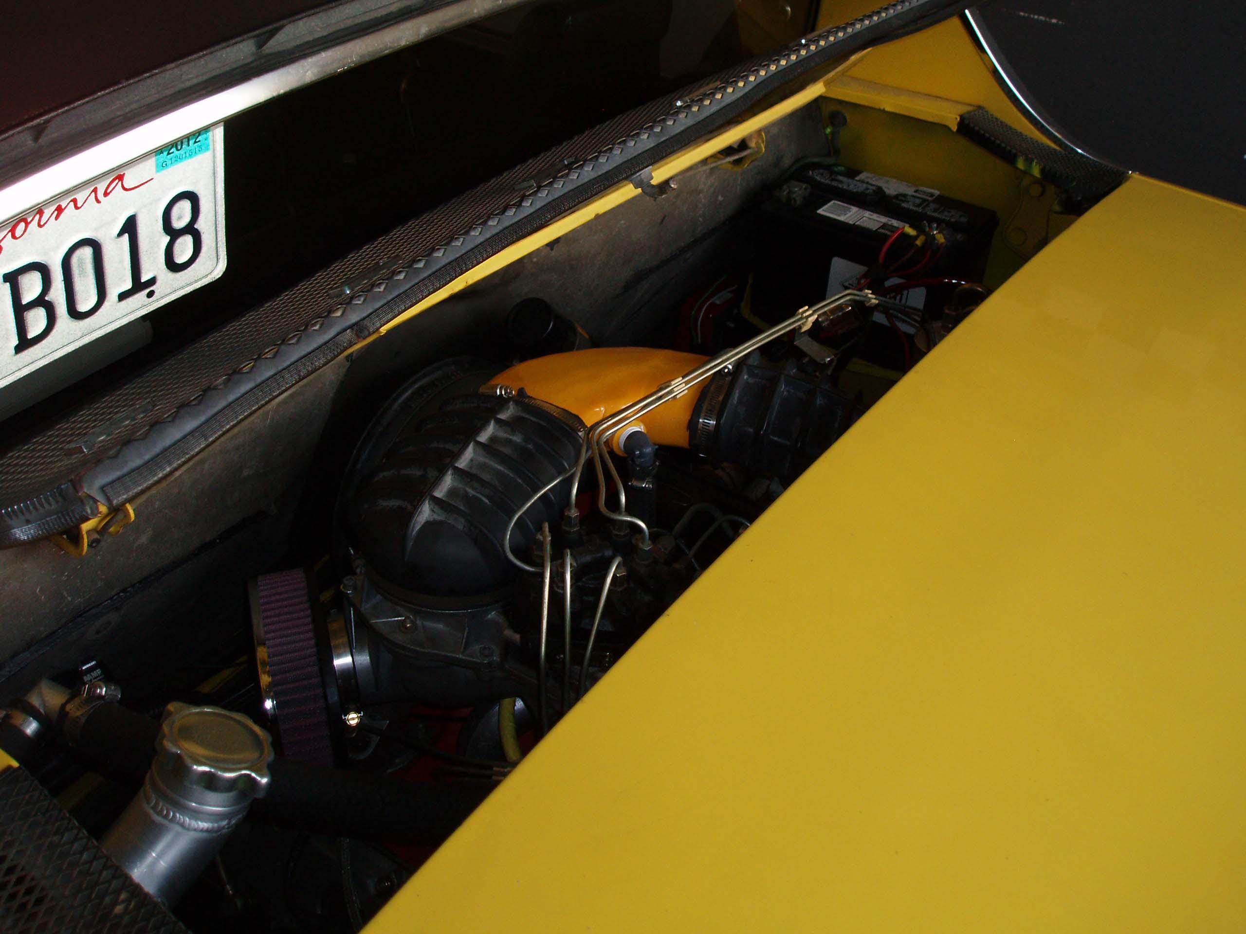

I love my 3.0L CIS motor! I modified the injection orientation so I didn't have to cut the trunk. It involved removing the airbox and replacing the intake AFR box with a Volvo 242 AFR mounting box.
You are welcome to come by and look at it, or test drive it, anytime!
