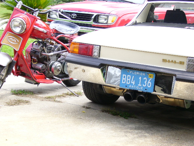

Phoenix-MN
post May 30 2015, 09:57 AM
Posts: 927
Joined: 23-January 04
From: ST. Bonifacius,MN
Member No.: 1,590

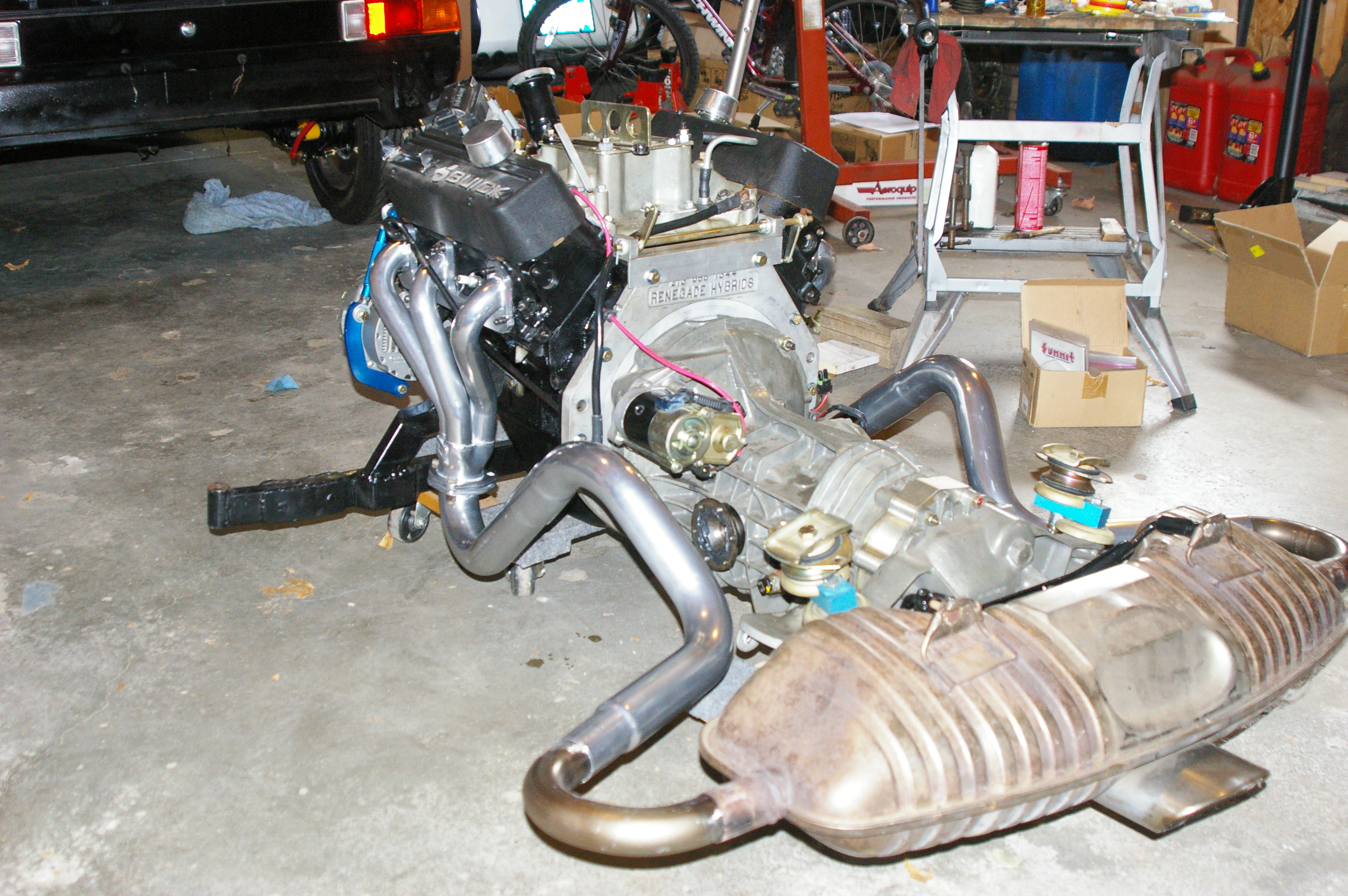

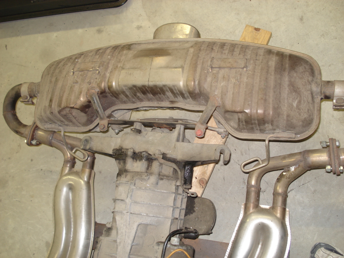

Here's mine

Cool, got any detailed pics on how you solved the installation into the car?

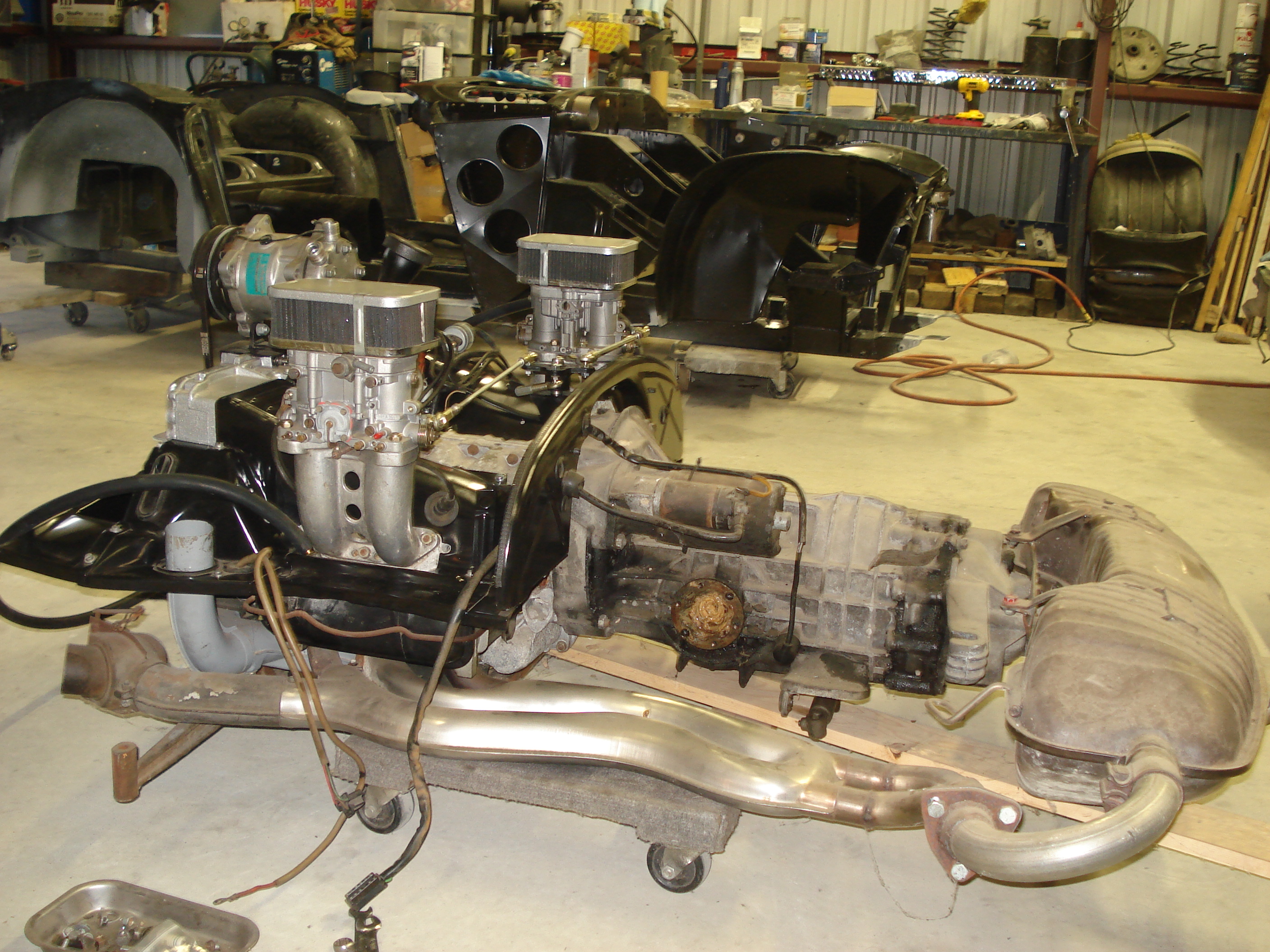

Heres some pics of mine

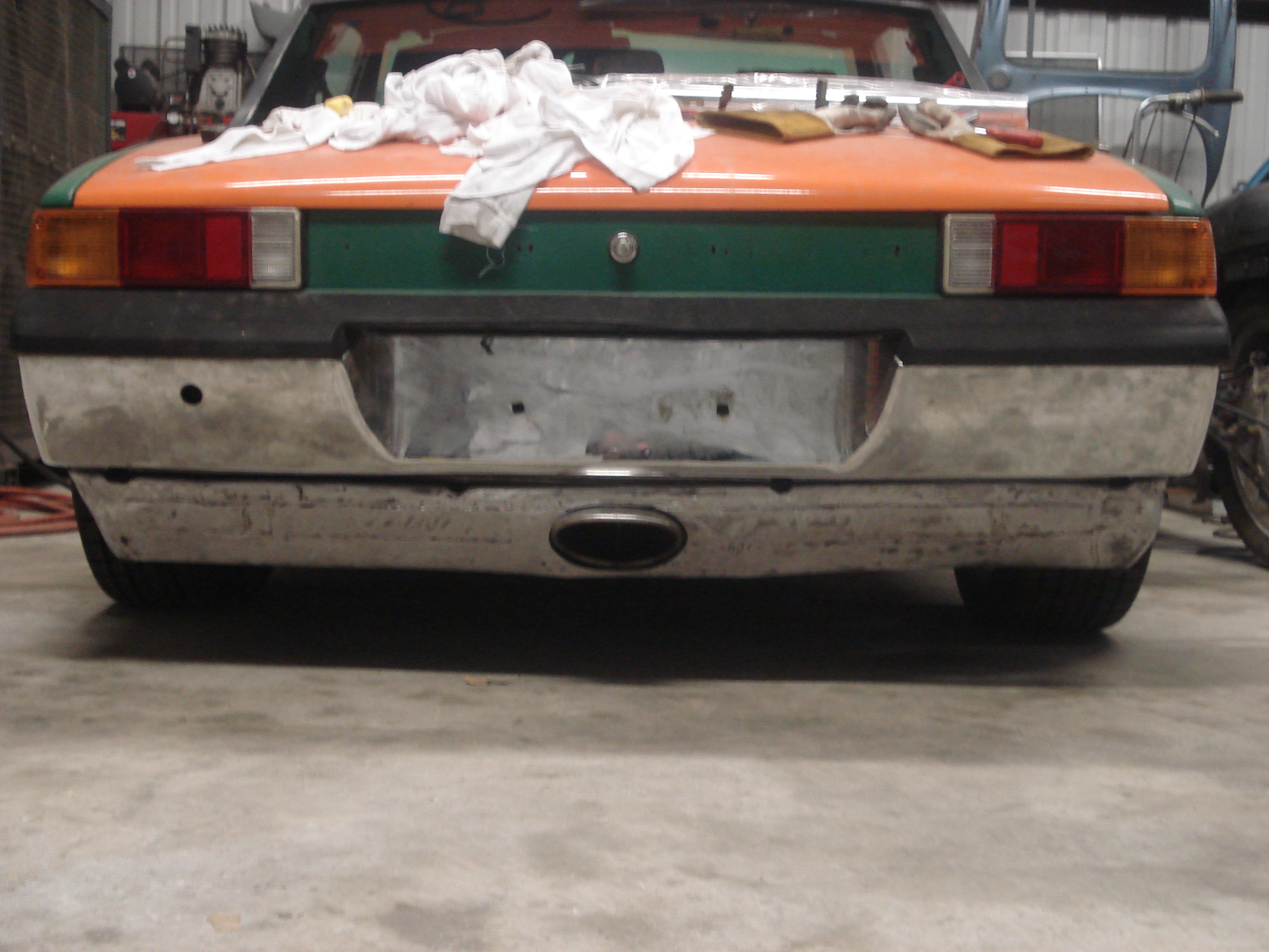

zambezi
post May 31 2015, 07:52 AM
Posts: 711
Joined: 14-April 08
From: Lafayette, LA
Member No.: 8,920
In place on the car.

Zambesi, that is sweet.
Got any sound videos you can post yet?

QUOTE(db9146 @ May 31 2015, 04:11 AM) *
The Boxster muffler looks a good bit larger in diameter than the typical muffler. Will it fit in the same space?
I needed to remove the heat shield and do some cutting, there's some more pictures here. No problems with the sway bar.
http://phoenixhobbies.com/html/prorgress_2008.html
Here's a youtube video with some sound
https://www.youtube.com/watch?v=P2ZUpPduyCE...player_embedded
