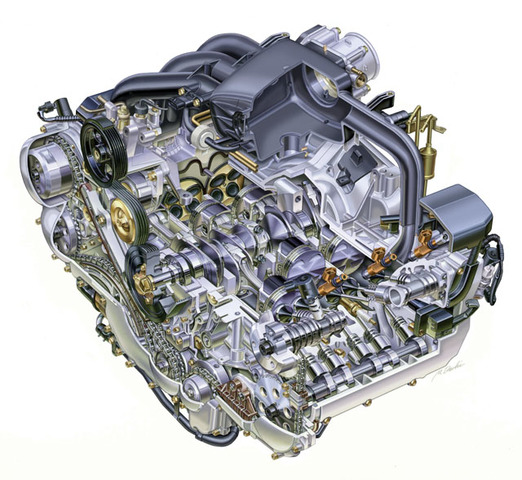

Gents,
I think I need a ride in a Subaru swapped conversion to help push me over the motivational hump. (IMG:style_emoticons/default/idea.gif)
(IMG:http://www.914world.com/bbs2/uploads_offsite/s9.postimg.org-11125-1433372064.1.jpg)
I am thinking an EZ30R or an EJ turbo series motor. ( don't have the skills or motivation to do out of the box like Mike or what Andrew is starting)
I came from the Subaru world before 914's, so it's a warm & fuzzy.
Any bay area folks have a running swap I could take a ride in sometime this summer?
Thanks!
Matt
I added a pole for your opinion ( cuz they are fun )
