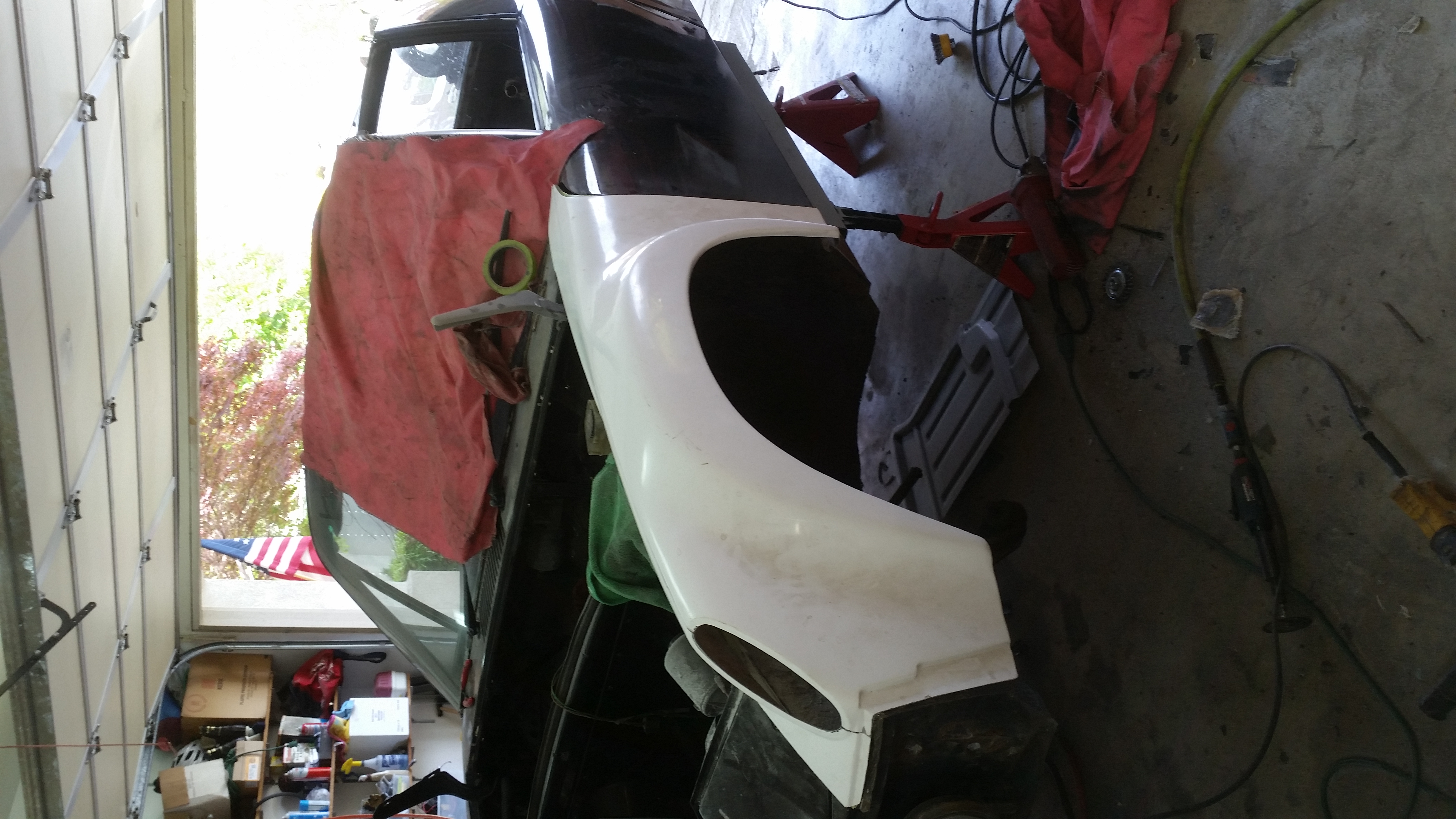

Is the white GT front fender replacement fiberglass?

Yes. From QRS

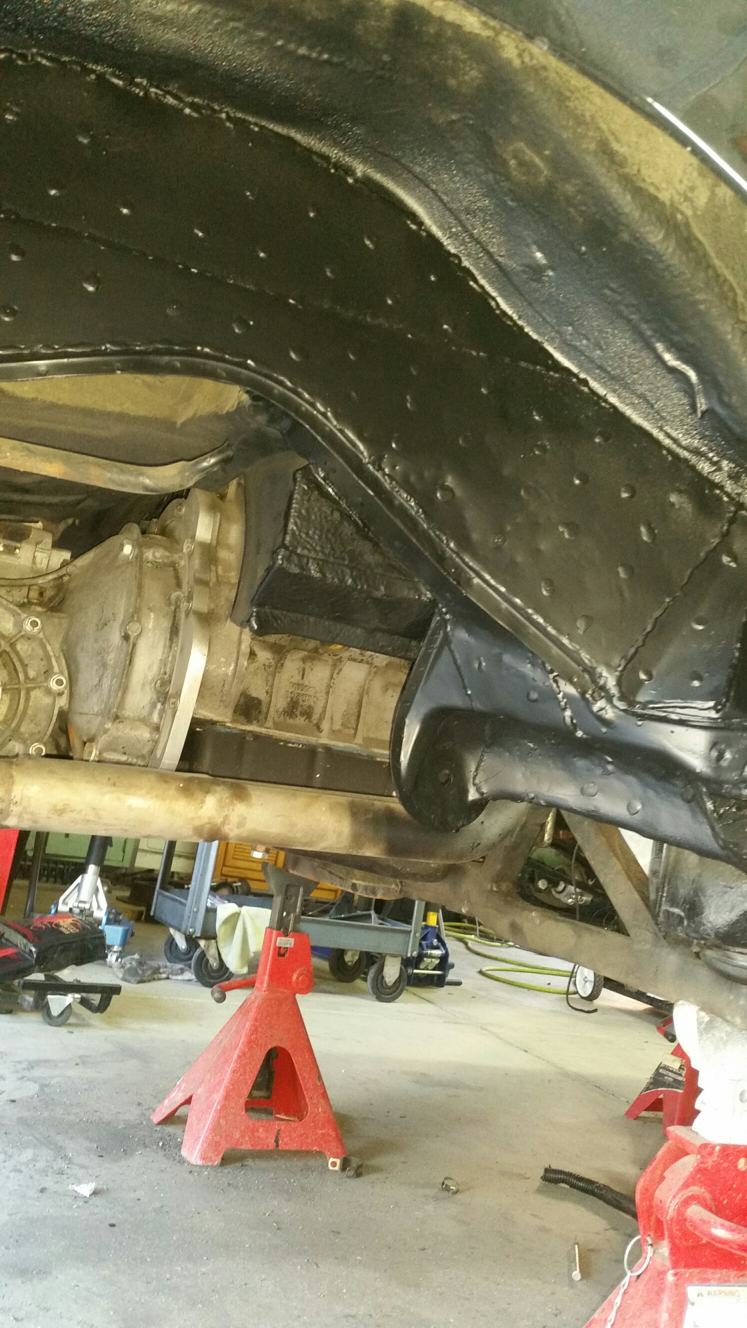

My my my thats a lot of welding!!

Yeah. They seem like small parts..but it adds up. Took probably 12 hours all told of actual trigger pulling and tapping around. My neck is gonna be sore for a while!

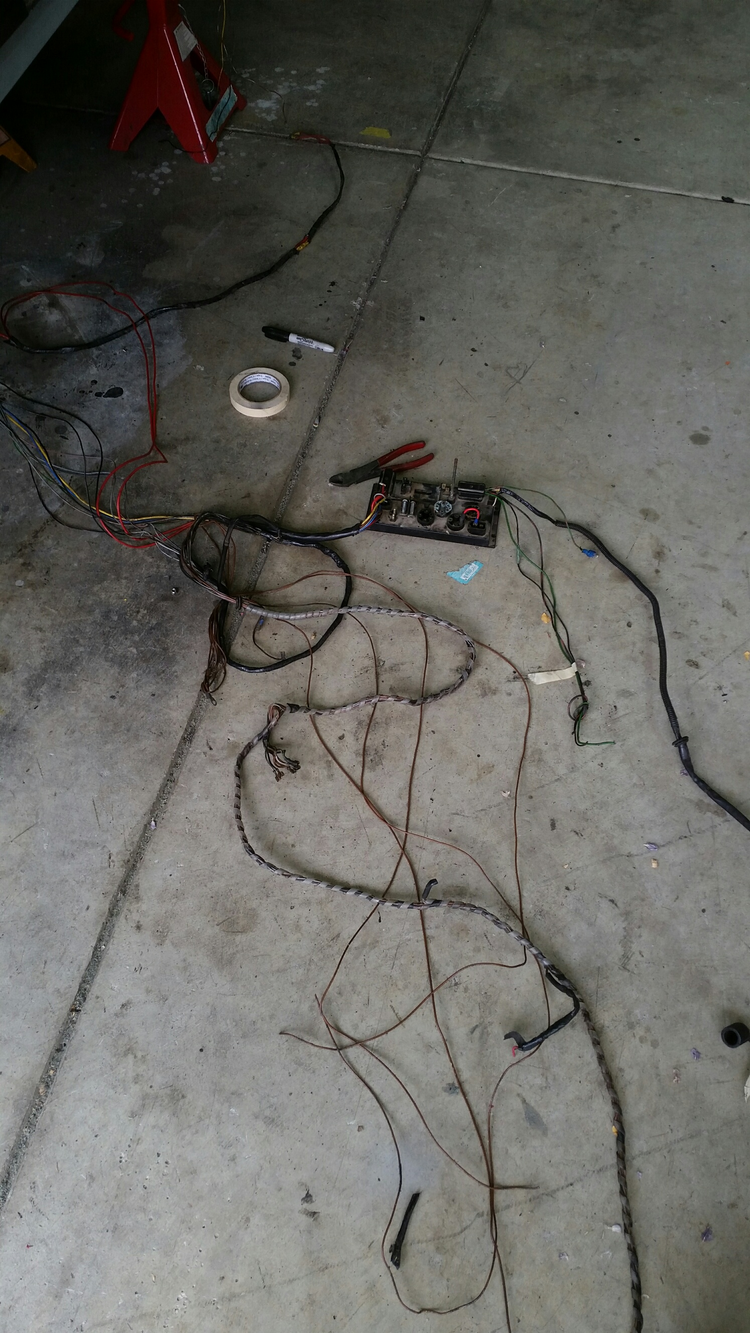

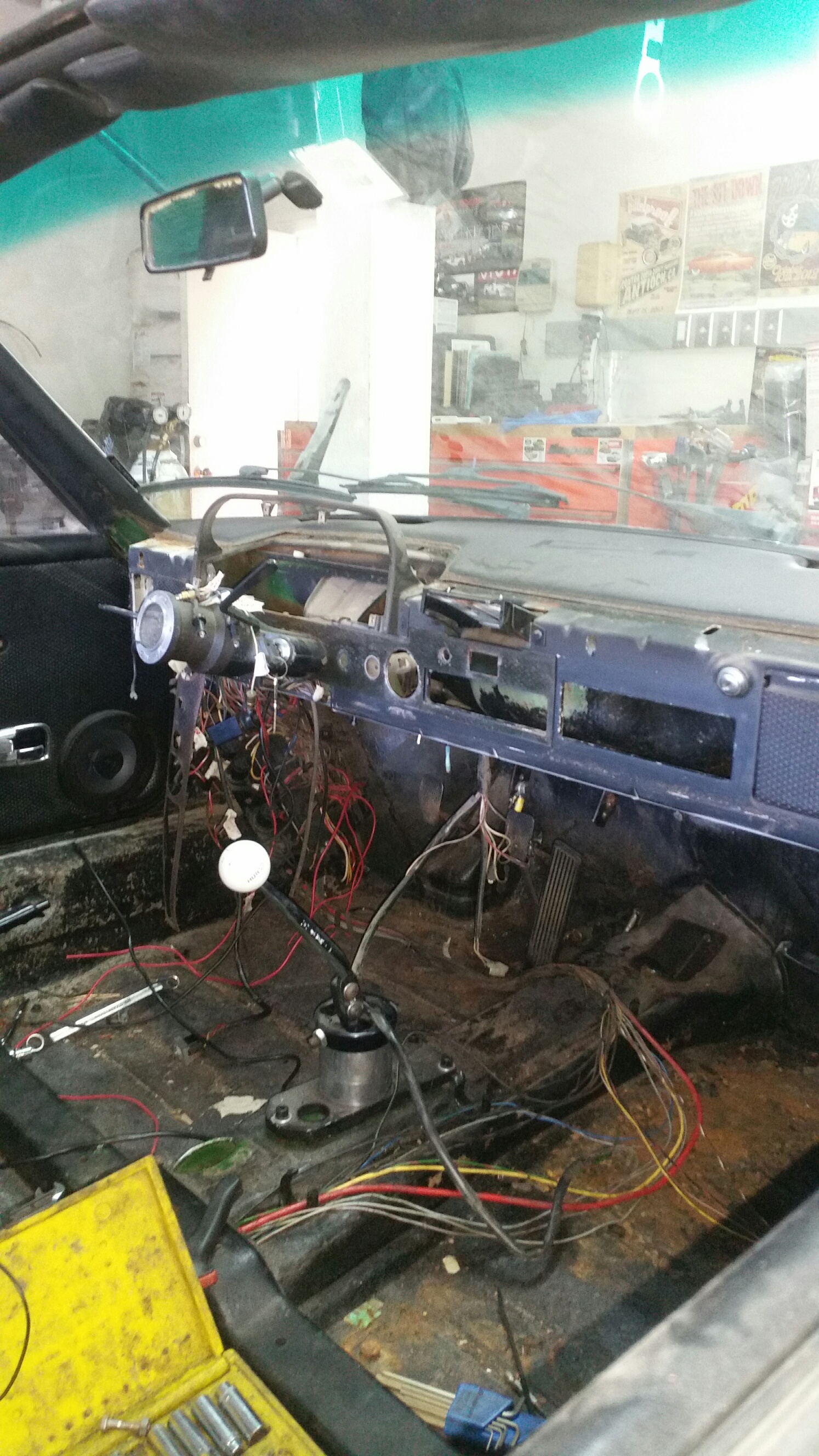

I decided that the old, hammered relay board and associated wiring had to go. The Buick actually had a Porsche alternator on it (anybody need one?) so I am going to a custom case, lightweight, 1-wire alternator that Dean's Electric is building for me. Since most of the relay board that I would have been using is pass through wiring anyway, I will solder everything up. Fuel pump will be right by the fuel tank and I can use the Atomic EFI to manage power to it. I found 3 broken wires in the main harness, two of which were for rear lights, so I am glad I took the time to do this.

QUOTE(LeftCoastErik @ May 30 2015, 07:20 AM) *
Yesterday I got the rear inner fenders cleaned and tacked in the gt kit. Also cut the front fenders off because I couldn't stand looking at them any more. I also got one trailing arm reinforcement pretty much done. Trying to finish the other one today so they can go to powder coat Monday.
That's the way to do the fiberglass flares, the whole fender, not just the flare. (IMG:style_emoticons/default/beerchug.gif)

I got the dash top pulled to have Tri Valley Auto Glass and Upholstery re-cover it in black ultra leather with double stitched silver thread. I made some fillers for the dash vents too, so those will be covered when they do the bottom half.
I got the relay board out of the harness entirely and fixed a bunch of other little wiring issues.

How is the WHOLE fiberglass front fender attached?

Good question...I haven't gotten that far yet.. I am assuming I will either bond it and mold it in to the cowl or find a way to use small dzus fasteners to attach it at the corners. Thats why I haven't cut off all of the metal yet, I want to leave my options open....
