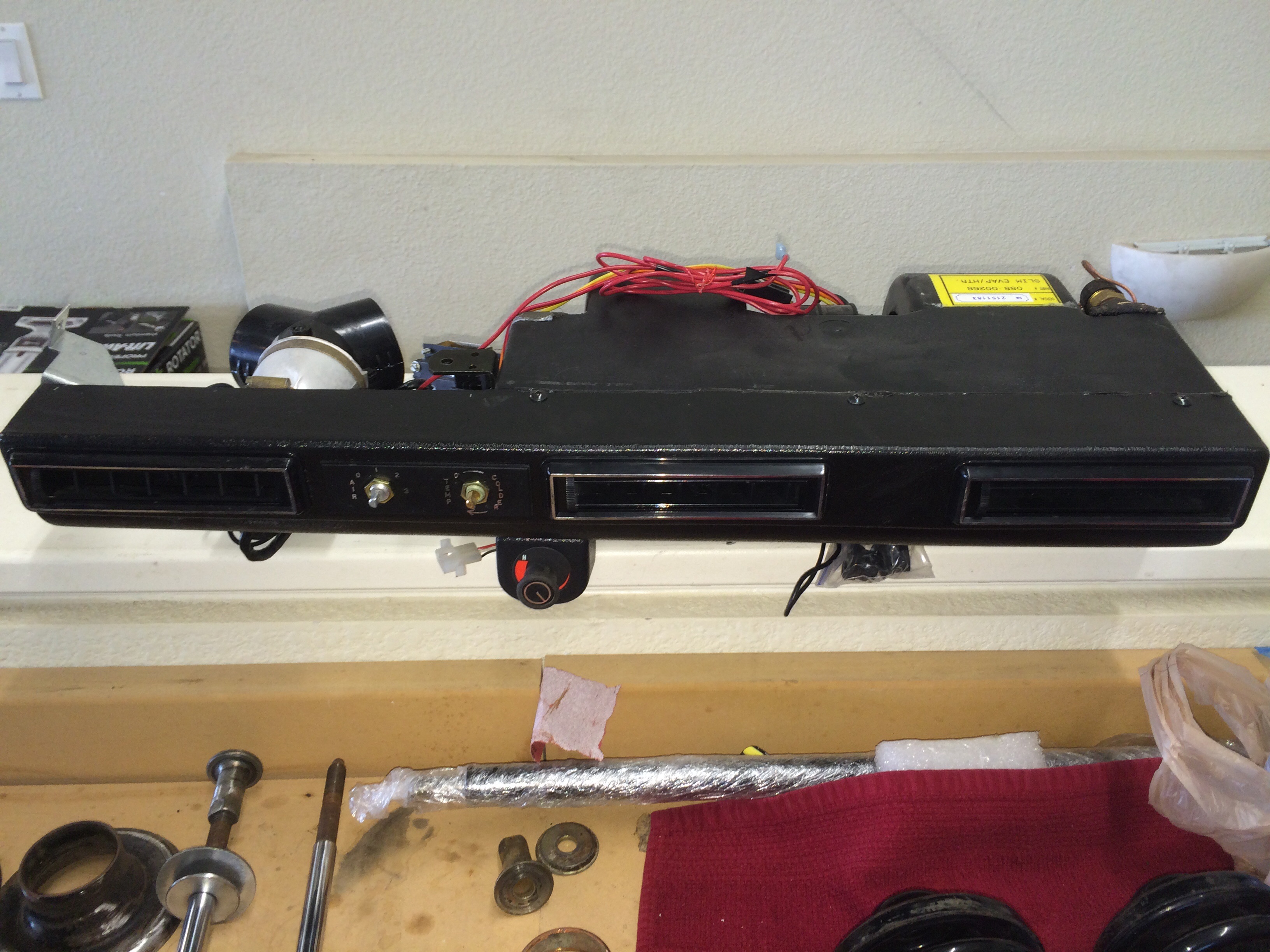

Does anyone have pictures of their project and where they routed the lines from the front trunk to the undermount unit? Below is the unit I just purchased.
GeorgeRud
post Jun 6 2015, 12:53 PM
Posts: 3,725
Joined: 27-July 05
From: Chicagoland
Member No.: 4,482
Is that a new RetroAire unit or an old DPD assembly? Jeff Bowlsby has instructions for the DPD unit on his site.

QUOTE(GeorgeRud @ Jun 6 2015, 11:53 AM) *
Embarrassed to say I'm not quite sure. Jeff's site looks like it has a wealth of great knowledge, but the pictures on the one are hard to see. I was hoping to see someone with color pictures of where the cut the holes in their projects as well. Thanks

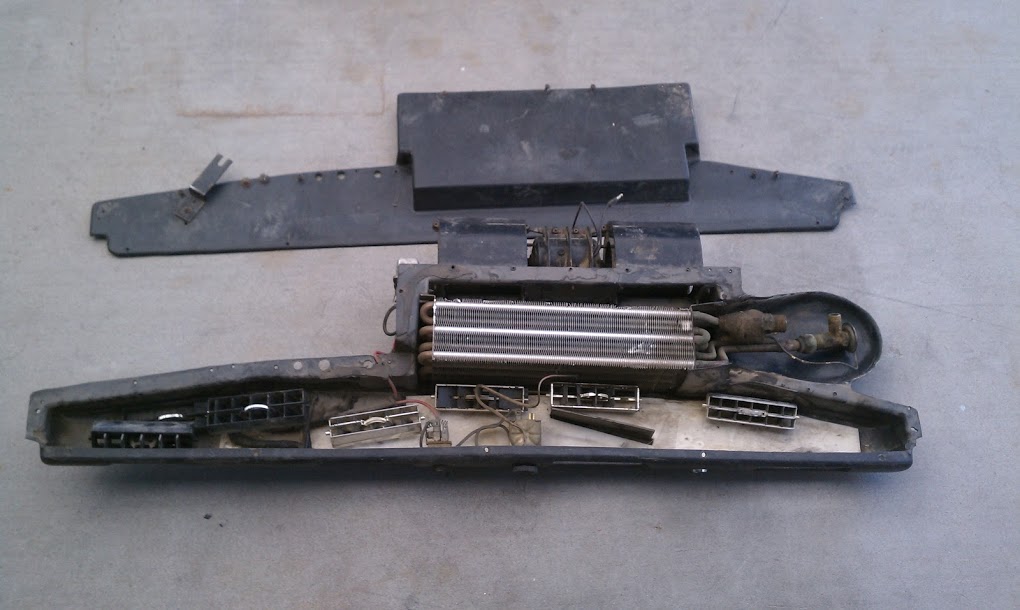

Chris914n6
post Jun 6 2015, 04:29 PM
Jackstands are my life.
Posts: 3,528
Joined: 14-March 03
From: Las Vegas, NV
Member No.: 431
I'm going to say that's RetroAir or Chinese generic. This is a DPD unit, has a chrome emblem next to the far right vent.
If the car had a/c there will be a large hole or two in the front trunk.
