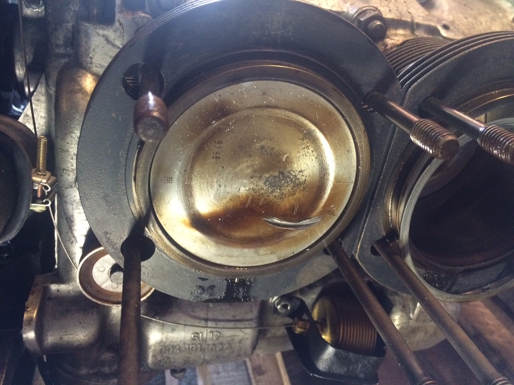

Some of you may have read my earlier pleas for help when my engine suddenly would not start. I thought it was the FI but after following the advice of members I did a compression and leak down test and discovered Zero compression and 100% leakage on #2.
With a heavy heart I pulled the engine, the pictures say it all.
I had the heads rebuilt earlier this year and have not done more than 300 miles. (IMG:style_emoticons/default/mad.gif)
Some questions:
what else needs to be checked for damage?
I need some new heads does anyone have some ready to use heads for a 75 2.0?
I guess the piston is also unusable, if I get some aftermarket P&C can I just install them without replacing the bushings on the connecting rods?
I guess the summer will be over before the engine is fixed.

Looks to me that you should get the valve seat replaced, buff out the dimple in the piston and get back on the road for the remaining three weeks of your summer....then do more extensive work later.

I would like to think that the piston is okay....but that's the optimist speaking (IMG:style_emoticons/default/smile.gif)
Any chance the piston could be cracked or any damage to the rod or crank?
If the piston was soft enough I guess it could absorb the worst of the impact without transferring that shock through the rest of the motor?

The pistons take a much worse pounding with each compression stroke than felt by that small ding. As long as timing, mixture, ..... thermostat,..... are all set correctly, you can just leave the P/C on, buff the top of the piston and get the heads done correctly. That problem if not initiated by some of the above wrong settings, is due to a bad valve job.

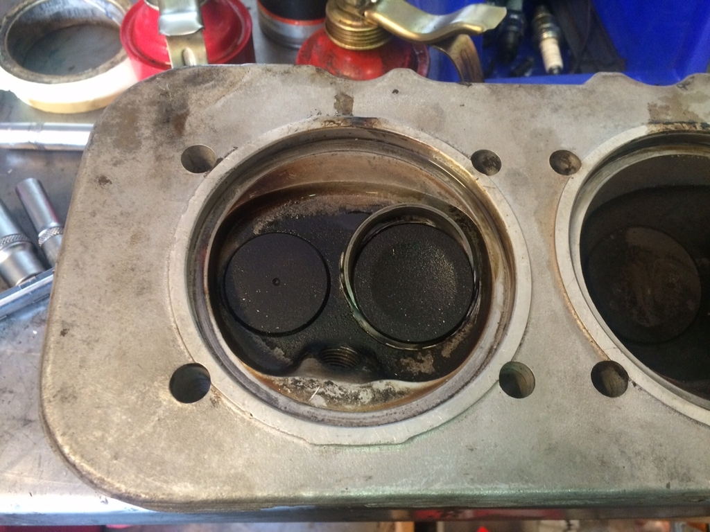

That doesn't look so bad. Head can be saved.
After 300 miles? That's a valve seat that wasn't installed correctly in the first place. And for it to happen on that cylinder just means the rest weren't far behind. Ditto on doing both heads.

When rebuilt was the seat replaced?
Seat looks odd, not only dropped, but also like it's broken.
I agree that both the head and piston may be savable.

The piston is good, just buff the top.
The head needs work. If the valve seats were replaced, then the guy who did them did a bad job. If they were not replaced, did anyone checked them before assembly? A failure in 300 miles means that the seat was not fixed good at assembly time.
If you need, I have a 2L head. I can send it to the local guy that did my heads and was top notch.

Some here have pretty good observation skills to assume the piston is okay ("It'll buff out"). The hit was toward the periphery of the piston and the impact could have affected the ring lands below it. Have you inspected the piston yet and the resultant ring side clearances? If affected, the ring might be seized and thus unable hold compression to spec. But I'll admit, removing a piston is yet another stage in engine disassembly.
You could also just repair the heads and reassemble, but perform a compression test on the bench to confirm all is okay.

The piston crown is designed to take much abuse. Shock waves and compound standing waves from pre-ignitiion. That is a small dent. I have seen MUCH, MCUH worse damage to piston crowns were seat went to shrapnel and embedded in piston crown. Piston and ring land still perfect.
Good advise though to take the barrel off and inspect the piston if for no other reason than it is easy at this point and will give peace of mind to confirm it is completely OK
NOTE: Cracks start at the surface, so the smoother the transitions are made when buffing the stronger the crown will remain.

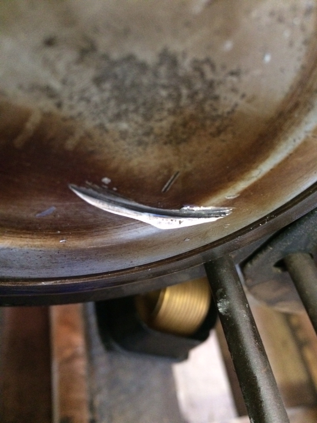

Here is a close up of the Piston. The damage is about 2mm deep at the deepest point.
Many have said that this will buff out. Is it just a case of smoothing the edges to the damaged area, what do members think is the piston usable?

If the lands are not damaged then blending the edges of the damaged area to reduce the chance of preignition is in order and by the looks of the pic it appears that it will be ok. No need to "buff it out" but blending yes

Nah,Pull the cylinders,check the rod for bending,rod bearings for damage,rod bolts for cracks,crank for damage.
A hole in the crankcase may result otherwise.

Send BOTH HEADS to Len at HAM. One intake seat came out; the others will be relatively soon. Don't ask how I know this.

The gouge in the Piston is nothing. Don't even think about that. You don't run high enough compression for it to matter. There is very likely no damage to the rest of the components. But realize that there is some risk to ignoring it.
