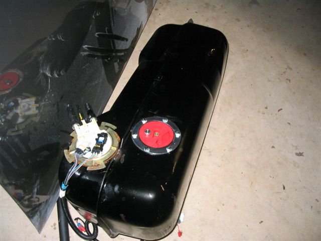

I mounted this 4th gen Fbody Fuel pump in the stock 914 tank. Way more work than using a Tanks INC $30 mount.

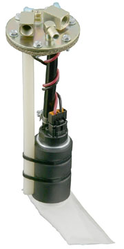

Maybe this will help Pump Mount

So this would be for an external pump?
Isn't the benefit of modifying the stock tank to have an internal tank pump?

That is for a internal pump.
