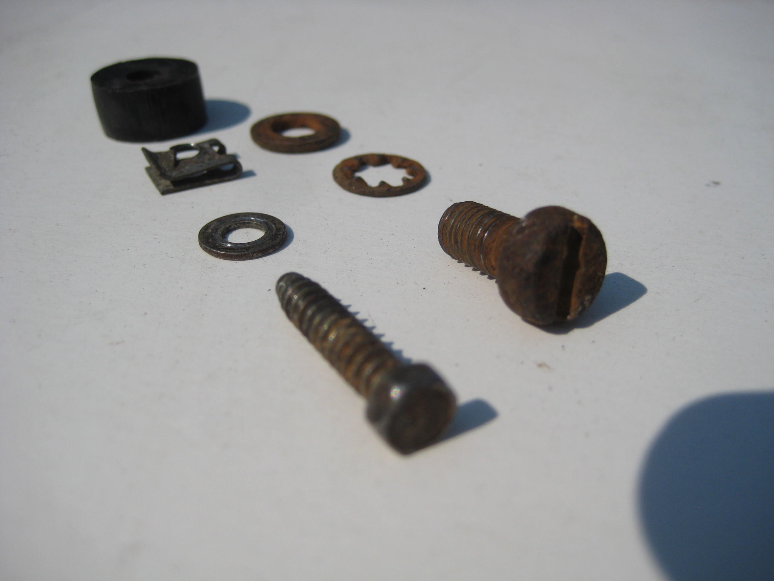

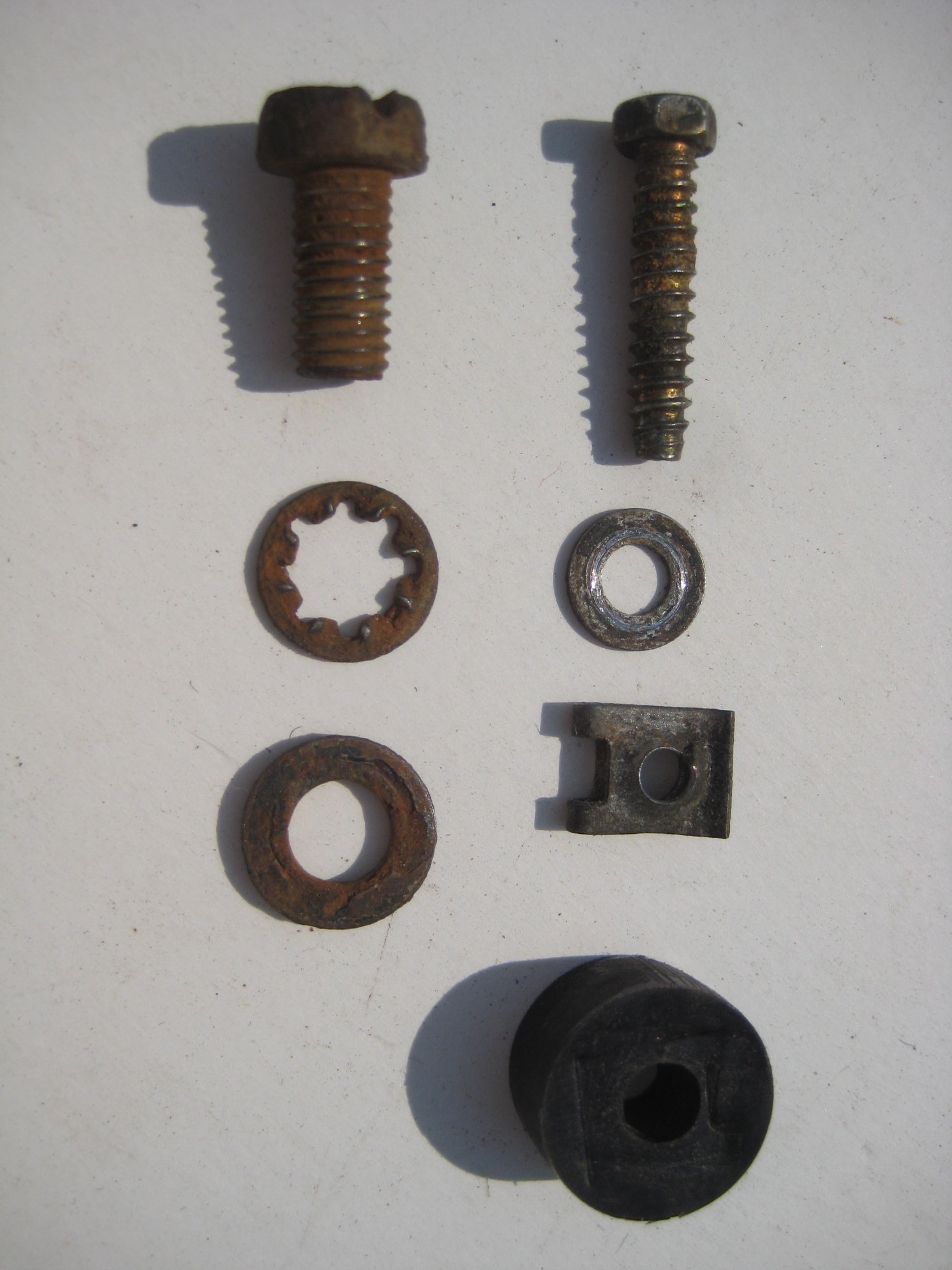

Pictures of actual original hardware for reference.
On early cars with aluminum threshold covers the fasteners were natural color nylon
"rivets" with a center pin that fixed them in place. Not reusable.
But.... some fanatics have "harvested" originals from the outer rows by pushing out the center pin and then extracting the rivet.
Later cars with black plastic thresholds got black plastic rivets

The bottom used the "cheesehead" slotted screws, & IIRC it's in the size Curt mentioned.
PS - I forgot the black rubber spacer & other washers, but rgalla has them pictured above (cheeshead screw is the one on top right btw).
