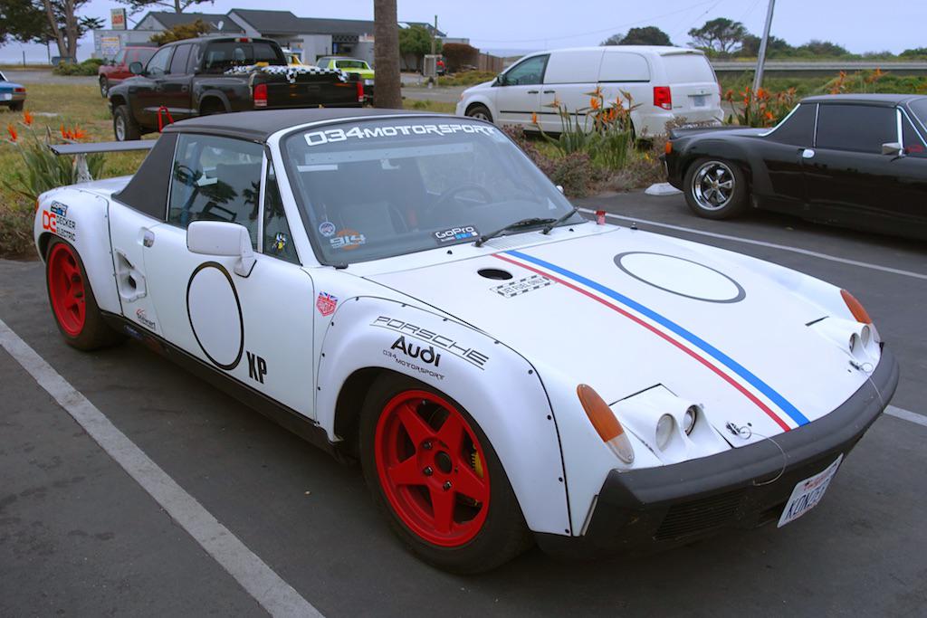

Happy with Patrick Motorsports products. I bought plastic rivets to not scar the paint from McMaster-Carr.... I believe I sourced the piping/welting from a VW shop in Cali. This is my old car and my current car has steel flares. I prefer the rivet on look if I had a choice. I always liked this picture...this is my friend Lewis Broyles - he worked on the car quite allot with me and was kind of like a proud papa. ;-)

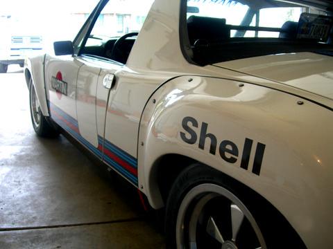

I have two sets. One from AIR and one set I got from 914LTD. I chose to rivet with welting under the flares. I am happy with the look. The welting makes it look a little more finished.
I originally had them screwed but the rivets look better and stay tight.

QUOTE(Mike Bellis @ Sep 1 2015, 06:38 PM) *
The car looks great! Which set was on the car in the images? Also where do you get the welting?

QUOTE(griffindoug @ Sep 1 2015, 07:22 PM) *
These are the AIR flares. They were a little thicker than the others but not by much. I think I used 1940 Ford truck fender welting. Very similar to the VW stuff but this finishes as a rounded enlarged lip. Like this...

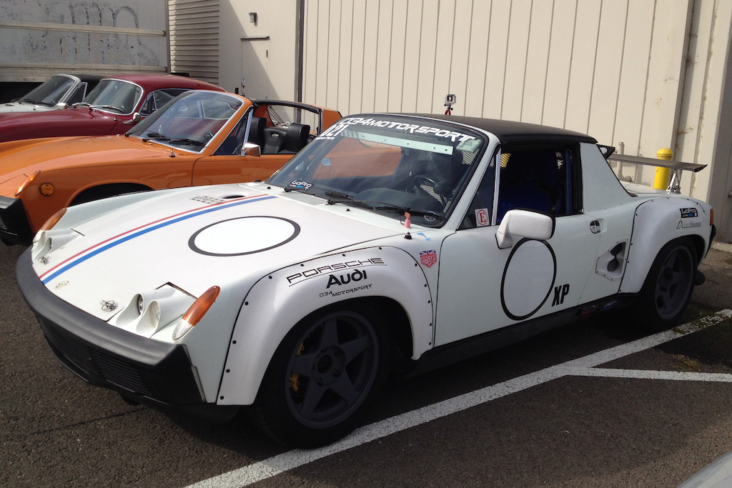

QUOTE(Cracker @ Sep 1 2015, 02:30 PM) *
(IMG:http://www.914world.com/bbs2/uploads_offsite/www.clubcobra.com-11316-1441160773.1.jpg)
Wow, that's a GREAT looking car. Nice vision, nice execution. Do you have any more pics? Curious to see this car from other angles.

Thanks but that is yesterday's news...don't want to hijack either. I dug the look too...it was a good hot rod and mediocre at best track car. There were reasons for that...

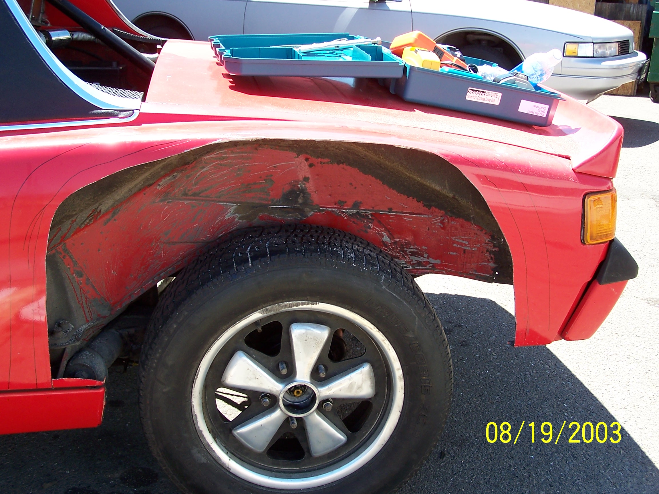

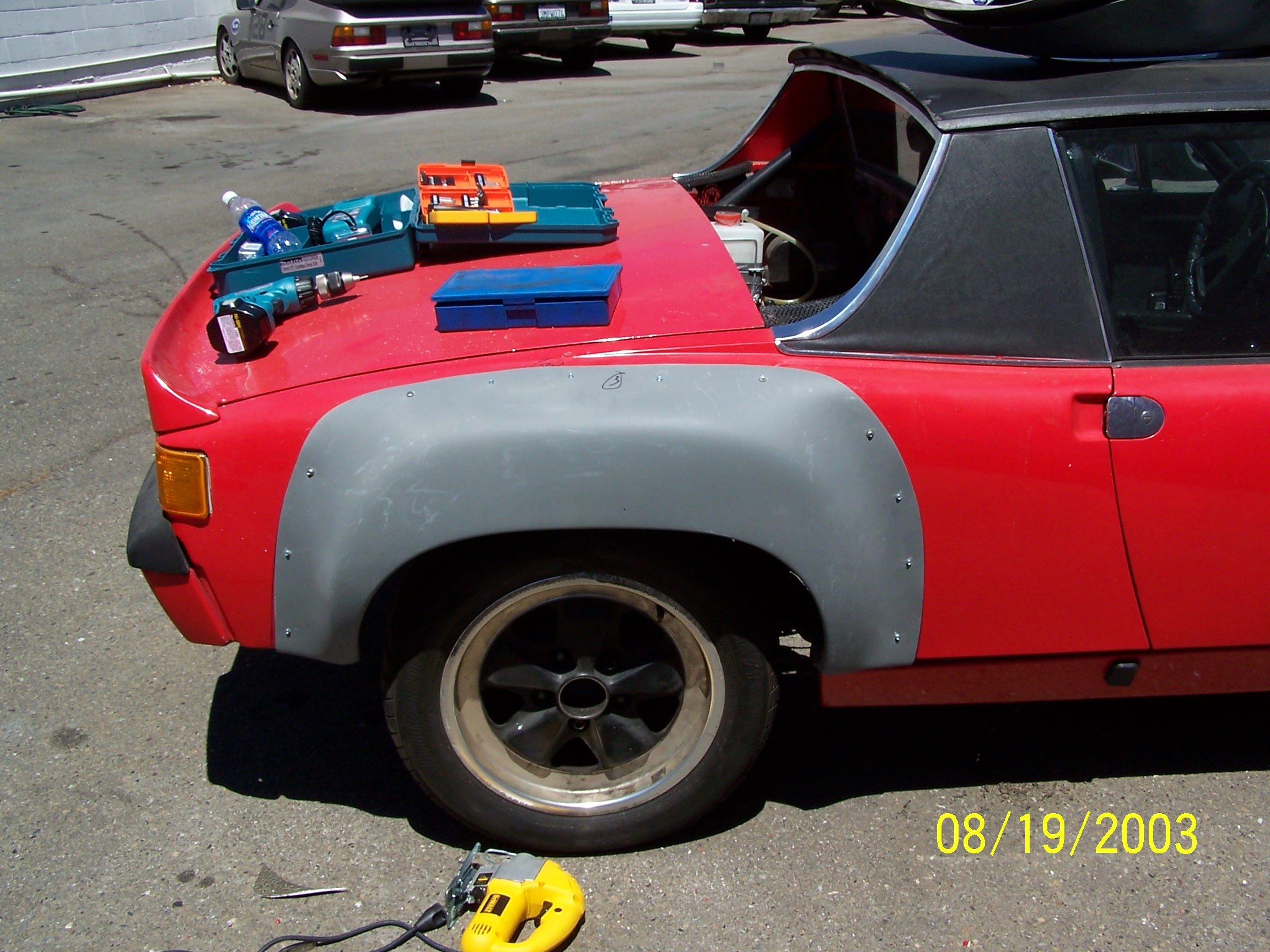

That's my old car. Those are the normal fiberglass GT flairs available everywhere (three of mine were from one supplier and the 4th from another). Spent a pile of time getting them to lay flat on the body. Then marked and cut. the original fasteners came from Better Bodies from there 996 RSR kit. The were domed allen bolts with a rubber gasket underneath. The gasket between the flair and the body was "heavy duty" VW beetle fender welting (it had a larger bead that completely hid the raw edge of the flair).
