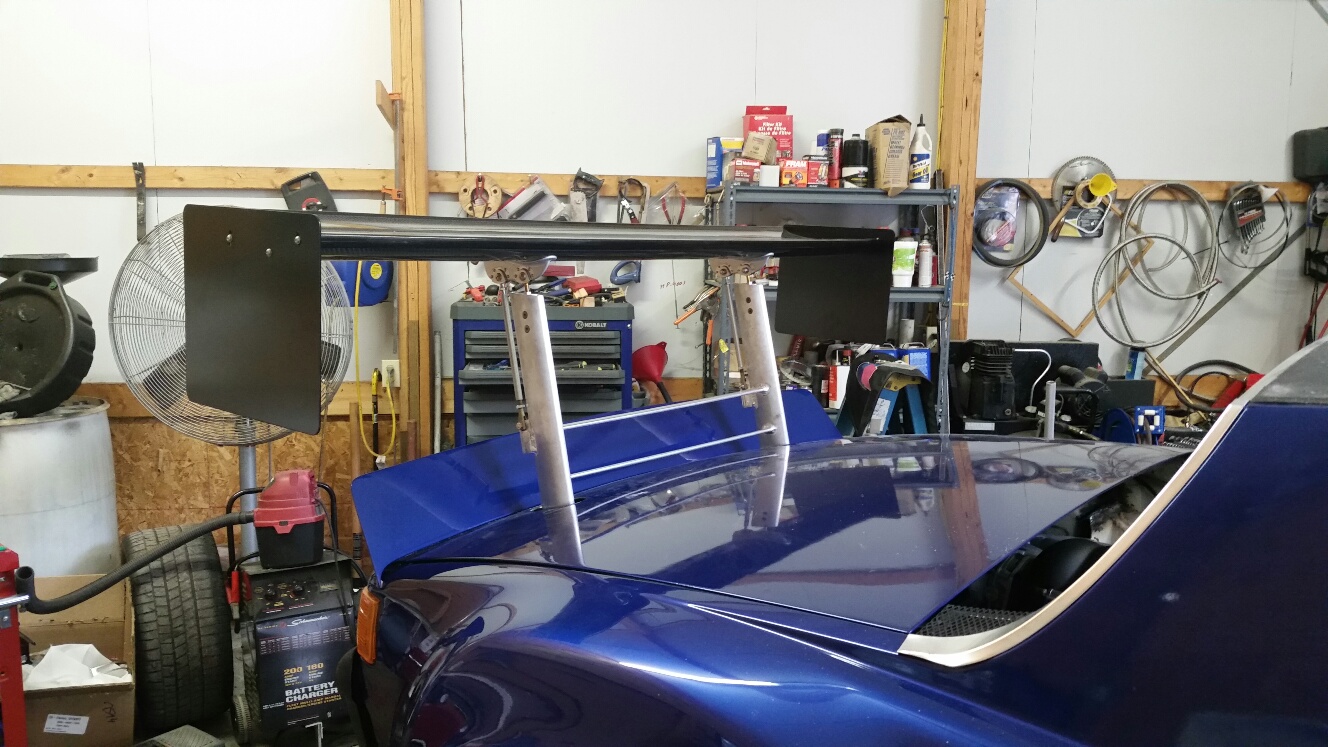

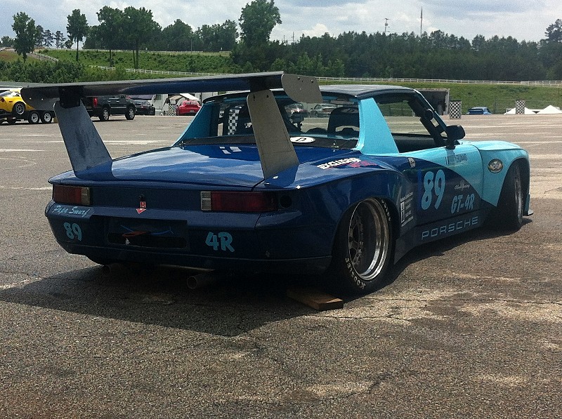

We have a 70" fiberglass Predator wing on Papa Smurf. I like it, but it seemed to bend in the middle at speed (downforce) so we strengthened it up internally. Supposedly the CF one is stronger, though Joel at GT did not understand why ours did what it did. I do have the GT-Racing aluminum uprights for sale if you're interested, we ended up making our own...

while I agree one can be made, if you mount the wing way on the ends where the trunk/fender gap is, you REALLY need to strengthen it up so it doesn't bend in the middle. that's what was happening to ours - people following me said it was bending down in the middle big time. We had to put a steel rod inside down the leading edge to keep it from bending. I guess it's generating a lot of downforce, pushing the middle down somehow. In fact, you could push down the middle and bend it without a lot of effort just standing there. If it's mounted closer to the middle maybe it wouldn't happen...

Bob - The wing should NOT be bending at all...at least so much that even is visually noticeable. In theory, "real wings" that are efficient should be capable of producing at least 400 lbs of downforce (depending on pitch and speed). The equivalent of two of you (maybe 2.5) sitting in the middle of your wing. I see poor wing/strut set ups on the track failing (to some extent) all the time. It is one area for sure that a builder should not skimp on the part nor the application. But you know all of this already... (IMG:style_emoticons/default/shades.gif)

I know is shouldn't be bending, but it was. Like I said, you could just push on it and it would bend with little effort. GT-Racing was shocked - so they send another one...which did exactly the same thing. We have about as strong an upright set up as you can get - bolts into the chassis in multiple places with mutliple supports in the trunk. VERY strong. But...the wing still bent at speed.

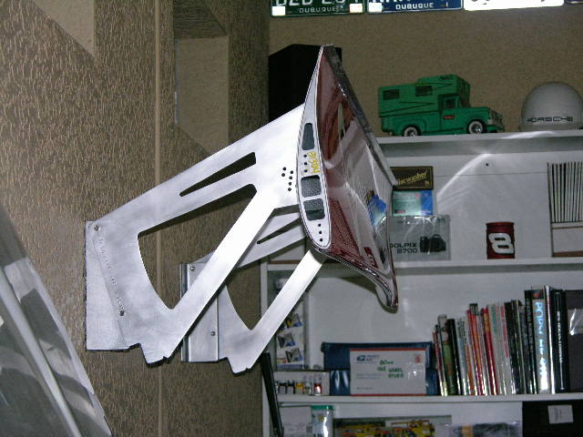

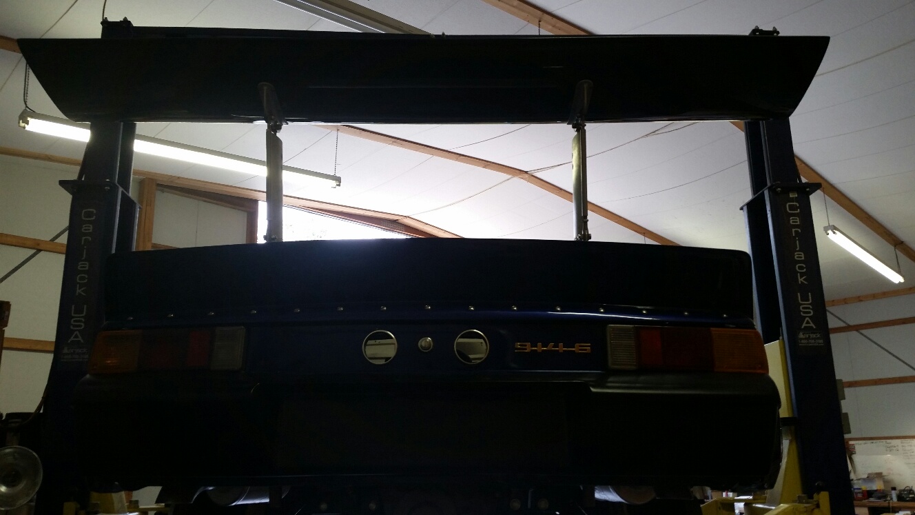

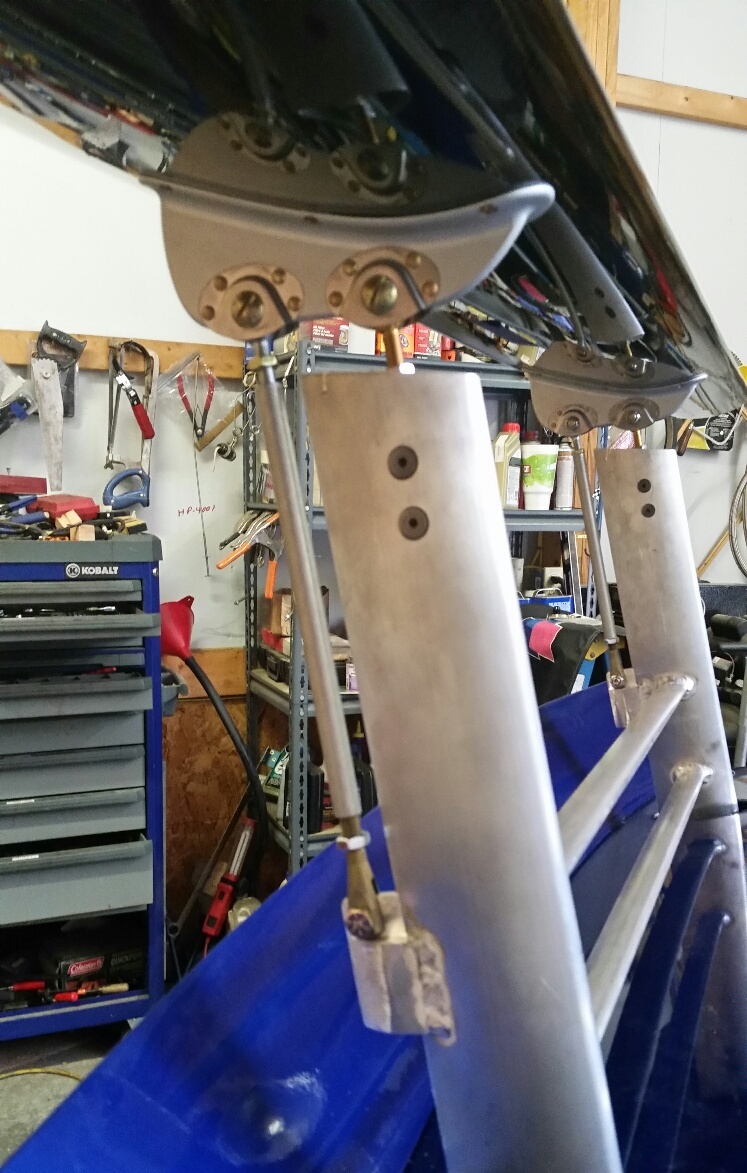

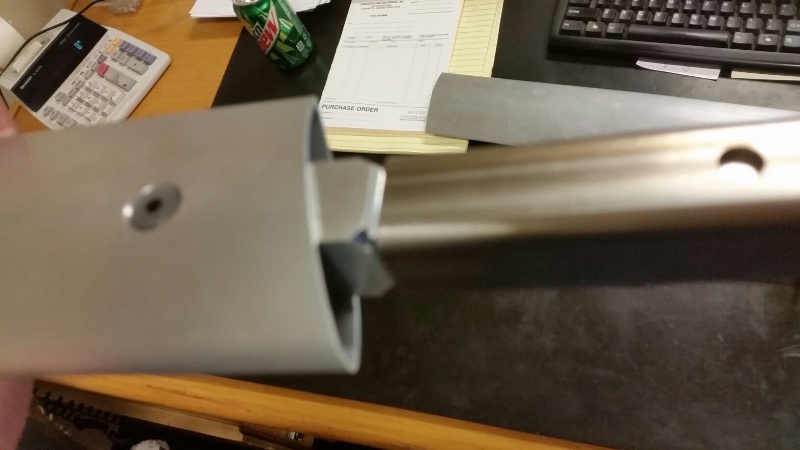

Here is what I choose to do after much research...
Started with G-Stream wing - wind tunnel tested and proven wing profile - and costs a bit. I had my struts and uprights built from scratch for strength, adjustability and removal. The mounts are secured to the core and the aero-tube is simply to break the air. Lots of work (too much really) went into this set-up. The wing is capable of producing up to 600 lbs of downforce and is effective with speeds as low as 60 mph.

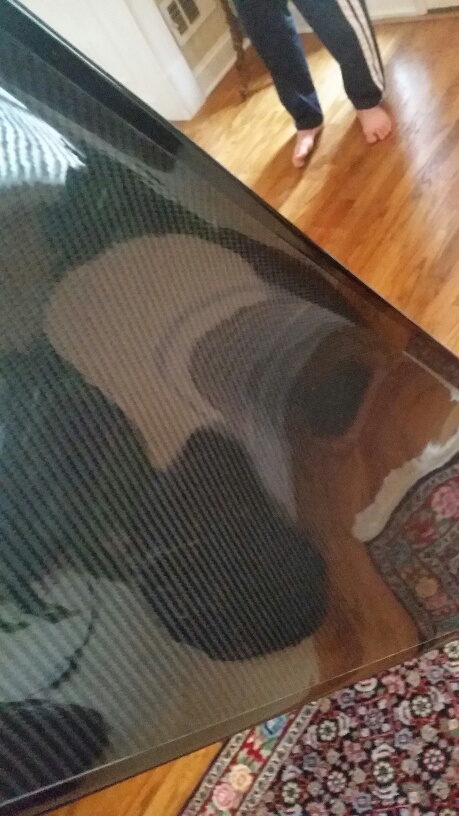

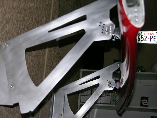

Just a comment, I was able to purchase a real ALMS Flying Lizard Porsche 997 GT3 RSR Factory Wing from the Flying Lizard Team car #44. This wings mounting plate was cracked. It became garage art. What you will see in the photo's are that the wing is bent in the opposite direction to fight off the tendency to want to bend.
This is a Porsche numbered part starting with 997, in the photo it shows the interior strengthening chords which are placed about every 8", the wing weighs less than 3 pounds and is stiffer than a Pay Day ^*%#er. My point is that all the wings I see are straight across and this one is bent in the opposite way to fight the tendency to bend. It also has an unbelievable wicker bill on it (Gurney Flap).
It is a real cool piece and I love it and loved making the struts for it!

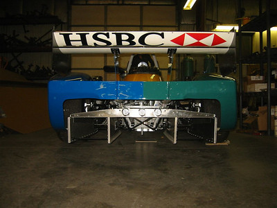

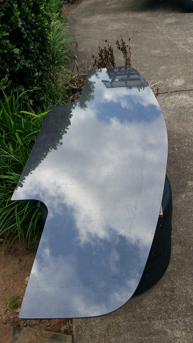

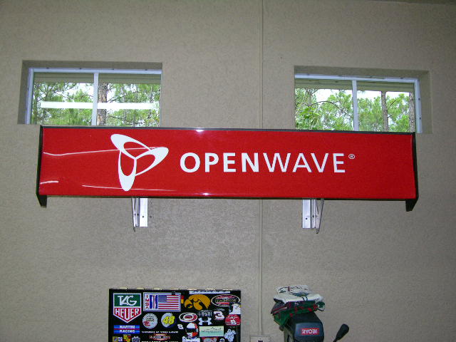

One thing that hasn't been mentioned is matching the potential downforce to the cars ability to overcome it too. A serious wing/splitter combo will need some serious power as to not over-slow in the straights.
This is my race cars original wing - it was waaayyy too much for the cars power and eventually replaced with the smaller unit. The large HSBC wing is an actual F! Jaguar piece - my car didn't have the 850 hp to push it through the air!
F1 Jaguar Wing
New "Stohr" Wing (only good pic I could find, I survived!)

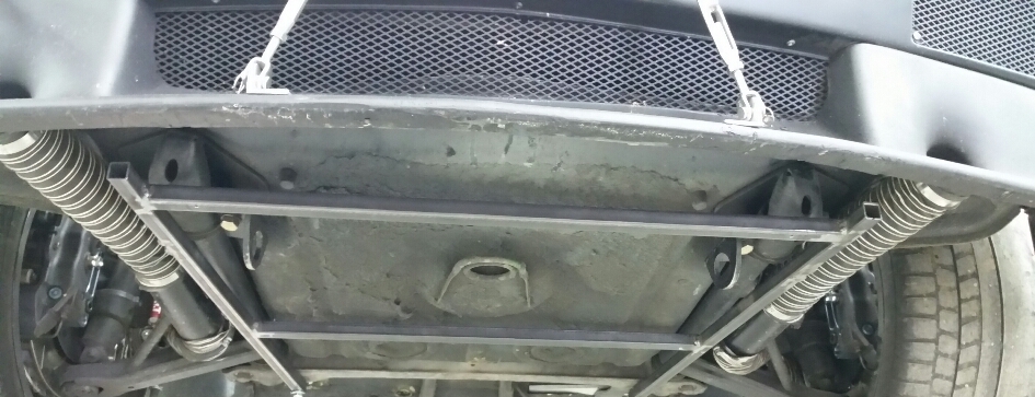

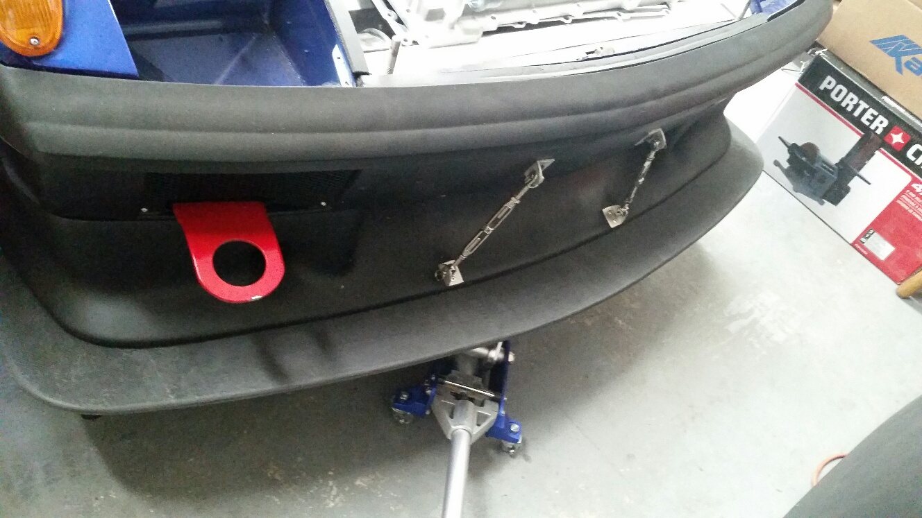

Andrew - I don't. I'm transitioning from the D-Sportsracer to the 914 - my decisions to this point have been predicated on the weight of the teener, the power of the teener and efficiency of the wing and splitter. Here is the splitter I had built for it...it extends 30" deep back to the steering rack support brace and is fastened to a fabricated bracket. Most 914's don't run much a splitter IF at all but my wings effectiveness would most likely require one. This one is adjustable from 3" to 5" in depth. Cheers!

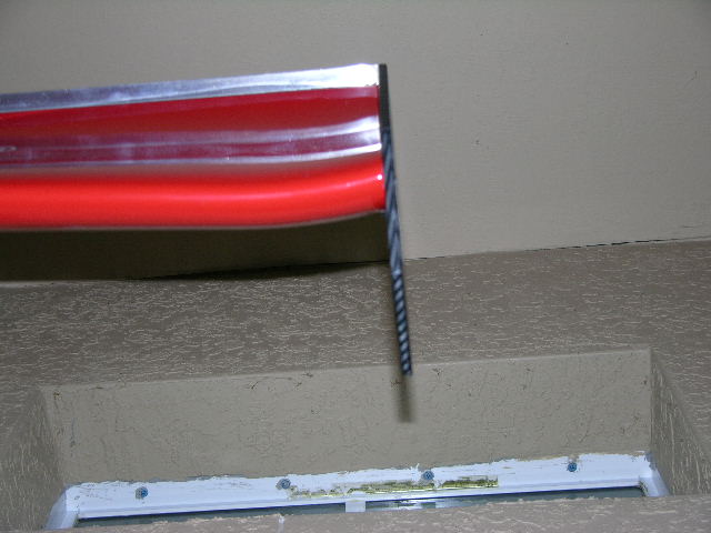

PS: The splitter has 4 layers of Kevlar and two of carbon fiber. It has four bonded-in steel plates the full thickness of the splitter to mount it. I too am not complying with any historic regulations - I'm building it simply as an exercise of what can be done with a 914 (short of Maltese Falcon's build, of course!).

Tony- The wing convo came up because I was planning a splitter very similar to what you have there. I opted for an IMSA airdam for ease of mounting the oil cooler, brake ducting and mine had the integrated lip which will allow a splitter to be easily mounted.
I'm not sure the "GT" rear spoiler does much as far as downforce with the 914 roof line being what it is and thought with a splitter I may have too much front grip (although we do have our engine weight back there) (IMG:style_emoticons/default/idea.gif)
Beautiful work on the front rail!

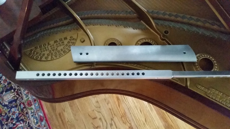

2) Mugs (and everyone else): Please take the "Steinway" pic the right way...that was for my "Buds" and the "bridge-there" was - Craftsmanship. Therefore, that picture is a bit tongue and cheek. I just don't have another picture of the strut cores...
PS: I KNOW my wife was away at the time (IMG:style_emoticons/default/rolleyes.gif) That's an 1894 art-case baby grand. Those teener parts were in high-company! (IMG:style_emoticons/default/beerchug.gif)

With the VERY limited time I've actually been able to use the wing and splitter (that's a whole other story!!!) I can say that they CERTAINLY gives me more grip on a few of the corners I know at CMP - carousel, T8, and kink. But I really haven't had a chance to explore limits like I did in the past - haven't had enough laps.
