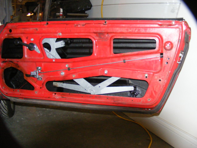

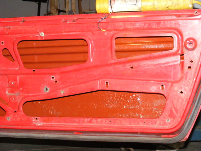

Yea, you can get in there.
Cleaning the inside was a major PITA !!! There were some big chunks of body putty that had no purpose.
Getting way down in corners was a challenge (IMG:style_emoticons/default/ar15.gif)
After sealing everything inside with Eastwood rust converter, I brushed
a healthy coat of truck bed liner in.
Edit: Oh yea, make sure you keep the drain holes open !
