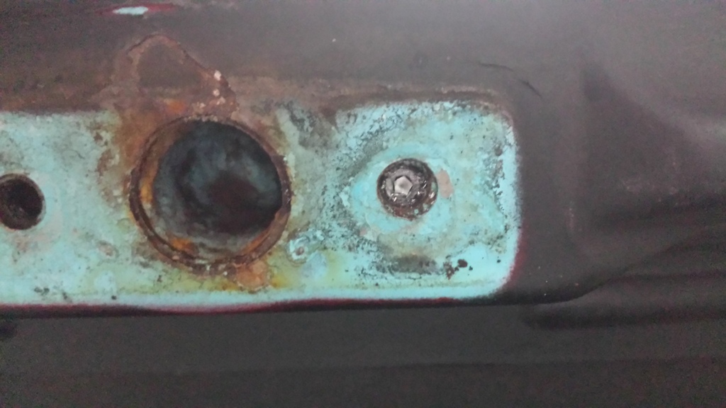

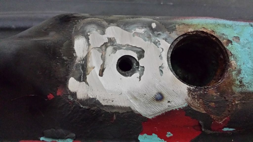

Just my luck, i snapped off a bolt that held the rear trunk latch on. Pulling it to replace the spring that broke. Anyone else experience this?? I'd venture to say that tig welding a head on to get a wrench on wouldn't work....probably snap that off too.
Oh, and I snapped an easy-out in it too. Just great!!
What do you think of welding a short stud on...looks like there is enough room for no interfence with the bottom latch assembly....I need a beer.

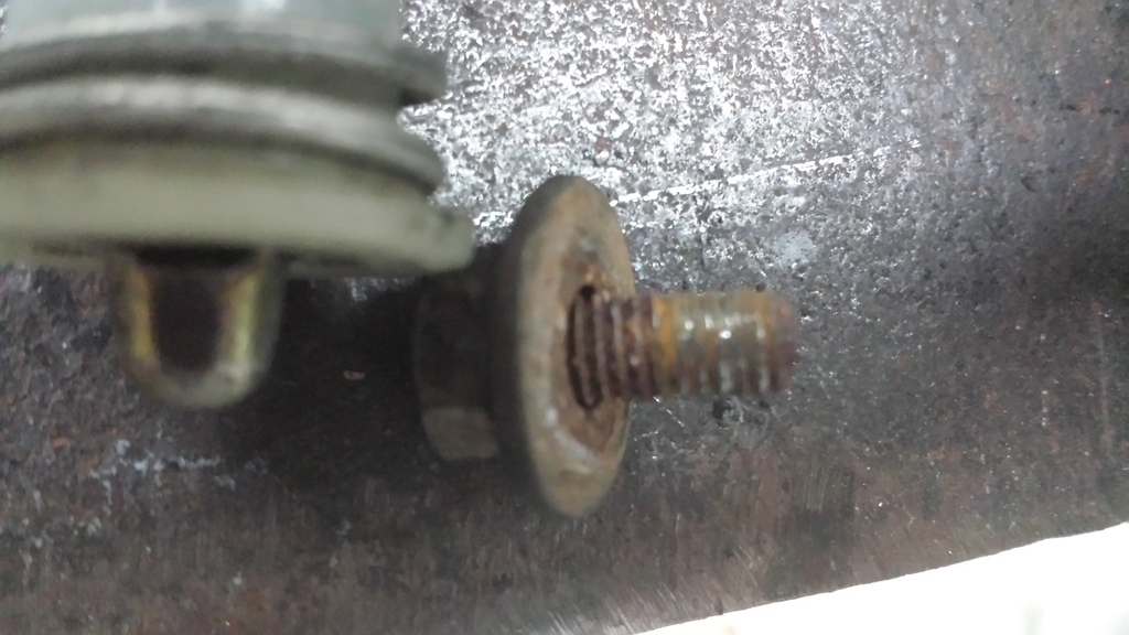

Oh, and the other bolt that did come out thread's looked nasty....
(IMG:http://www.914world.com/bbs2/uploads_offsite/i718.photobucket.com-4578-1443841759.2.jpg)

What about drilling it out and then tapping

Rusted stud at the 7:00min mark.
You could also cut it out and weld a new 1" square plate with a nut on the back. Or, someone might have a bad trunk from a parts car and you could replace with stock sheet metal.

Start with a small drill bit, then use PB blaster. Let it soak. Then larger drill bit. Use a reverse thread tap and see if you can back it out. If frozen still, you'l have to rethread it.
MMW
post Oct 3 2015, 07:27 AM
Posts: 152
Joined: 6-October 13
From: Northern NJ
Member No.: 16,477
Looks to be below flush with surface? This is why you shouldn't use easy outs, they are to brittle & people always snap them off. You would have been better off to keep drilling it bigger one step at a time until it came out or you could tap it.
What to do now? If you access to a tig welder you can build it up with weld until flush. Be careful not to weld it to the body. Then weld a washer on it, then a nut on top of the washer. If it doesn't come right out then soak it with penetrating oil & keep trying. Other options are to cut it out & replace. Or try a punch to jar the easy out loose & pick it out so you can continue drilling. Left handed bits or taps might work also.

It looks like there is that spray foam crap behind the thread inserts....anyone know if that is that flammable?
I figure worst case is I try to build a bead up with my TIG to then weld a nut on. If the bigass breaker bar can't take it off then, I'll cut it out and patch a piece of sheetmetal wiht a nut welded on the inside as the thread to hold the latch on. What a pita....

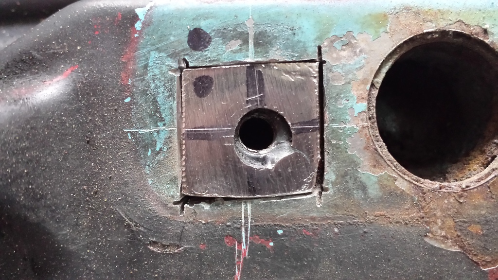

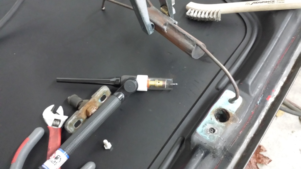

Well I fixed it. Tried to build a bead up with my TIG torch, but it was too recessed down and being only 6mm bolt the arc just kept wanted to jump over to the side. Maybe if i had a smaller than 1/16 electrode it would help??
(IMG:http://www.914world.com/bbs2/uploads_offsite/i718.photobucket.com-4578-1447809656.1.jpg)

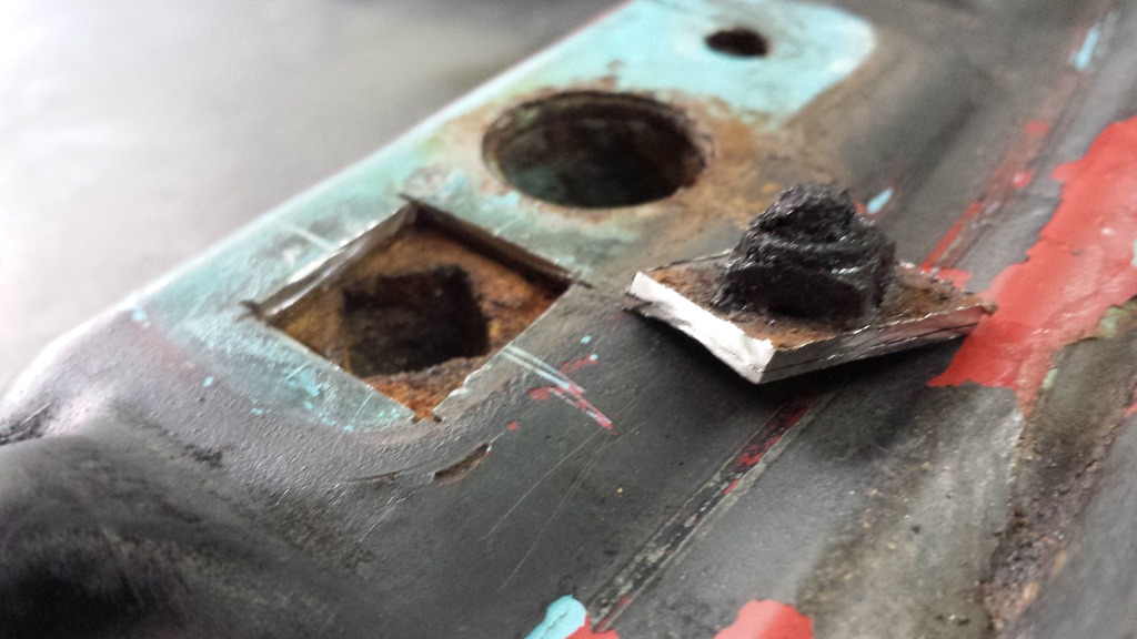

So I bite the bullet and used a dremel to cut out the threaded insert and weld a piece of 18gage with a 6mm nut welded to the back.
That nut/threads looks nasty, don't think it would have ever come out. Also note it was two layers thick.
(IMG:http://www.914world.com/bbs2/uploads_offsite/i718.photobucket.com-4578-1447809656.2.jpg)
I put the patch piece in and only was using tin-snips because it was so small, cut it a little to small on some parts. Not a huge deal. Used some .030 MIG wire as filler. rest of it I could just blend in with the torch. Note that I indexed the thread center with score marks. Tried, not very hard though, to line it up. The latch has a lot of play in it for any adjustment I might need to make though..
(IMG:http://www.914world.com/bbs2/uploads_offsite/i718.photobucket.com-4578-1447809656.3.jpg)

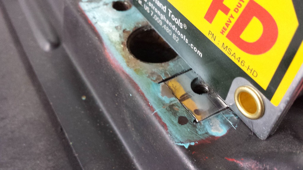

Holding it flush with a magnetic square. Made me realize I need to invest in smaller magnets to hold pieces in tight areas. This would good enough.
(IMG:http://www.914world.com/bbs2/uploads_offsite/i718.photobucket.com-4578-1447809656.4.jpg)
Mostly grinded flush. Turned out okay for me and holds the trunk down. You can see the edge that the magnet held was nice and flush, but the opposite side is a little under. Not a big deal for me on this part, but something to look out for in the future. Couldn't go for a test drive as it was raining and my brothers truck was in the way of the shop. This was my first patch repair ever on my car. Learned lots. I'll need it for the future repairs on sheetmetal on the car. Thanks all for letting me bounce ideas off of!!
